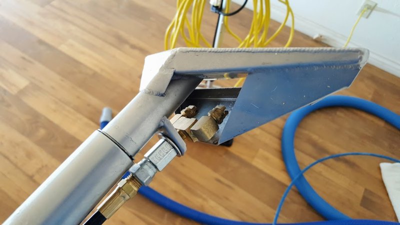

This is a Ti version made with two jets because they like me.
I used a 15" 2-1.5 tapered vac hose.
I hardly ever see stairs out here in Ranch land but I'm finally getting a hang of this thing.. I likes it!

View attachment 20020 View attachment 20021

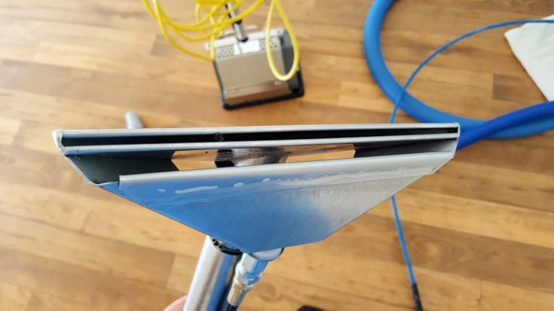

I like the splash guard Tom, it also helps keep the slot at the correct level.
The hose is an inch too short though.
I wonder if that was why I hated the swivel
NAAAAHHH! There's just no need for a stair tool to have a swivel

Yeah I had to add a brass extention to the SHORT solution hose so that it would swivel all the way.

Sorry Mark, but the critical part of the stair (the nose) is not really being cleaned.
Makes sense, once you look at the jets' angles due to the length of the tool and not being able to bend following the contour of the stair's nose.
That's always the worst part of the stair. Due to ground in soil and wear. It is also the area most susceptible to wicking.
Unless you get it cleaned well (in close and personal:winky: ), sorry Mark- No cigar.
28,275
Seriously, I have been using the pmf swivel lately, (it came with a used tm I bought recently) and although I agree on lengthing the hose so it swivels completely, I like the single jet. I am using a 11006 and I find flushes over the bullnose extremely well. I wouldn't put a glide on it as it really digs into the crevice between the tread and riser. A shield would be nice to limit over spray but the over spray isn't bad with the single jet. Very powerful little tool.
