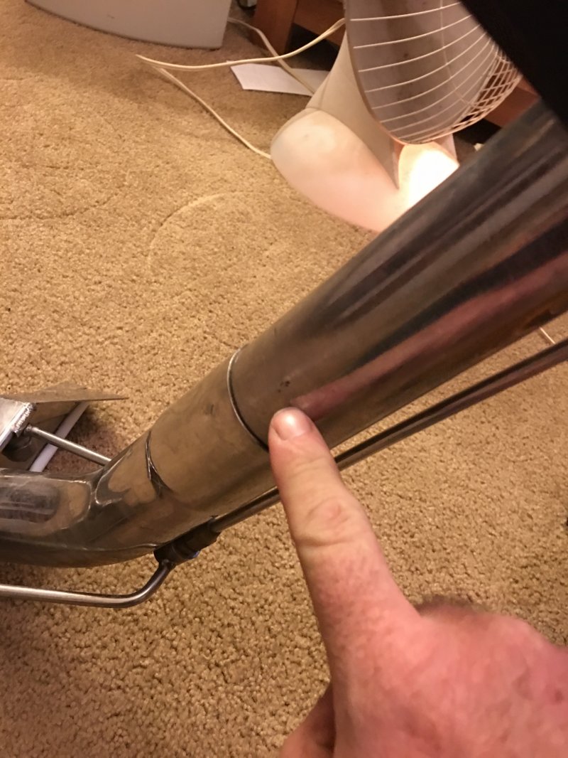

The current stair wand I use is in dire need of replacement. It's a Cal-Tools wand and is of very low quality. The neck seems to swivel around at the joint (Pic #1)

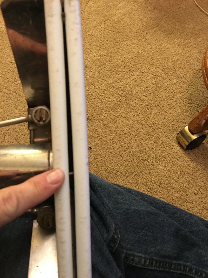

The spot weld broke causing the mouth of the wand to flex open wide like a hungry Carp (Pic #2)

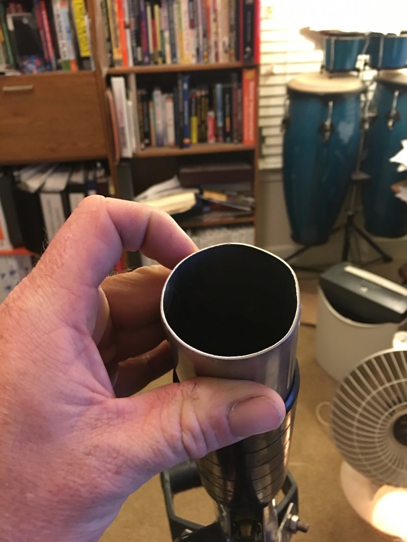

The glide is not optimal for getting the 90° toe-kick abutment, and the hose end of the wand was very sharp and jagged. It cut my finger causing me to have stitches when it sliced me. (Pic #3).

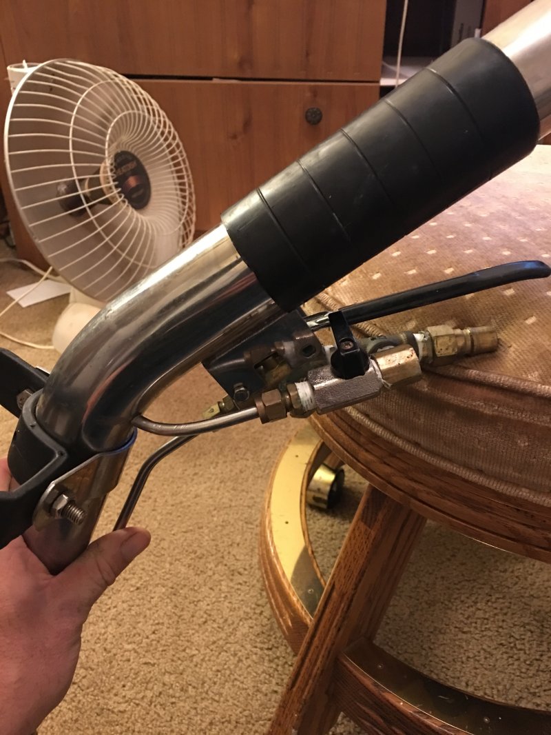

The only things I like about this wand is that it's 2" and I don't have to mess around with adapters when I use it. Another thing I like is the bypass that my buddy @Thomas Conway installed for me. Back when I had my Amtex I needed that bypass to keep the flow going so the diesel burner would have enough flow to fire off. (Pic #4)

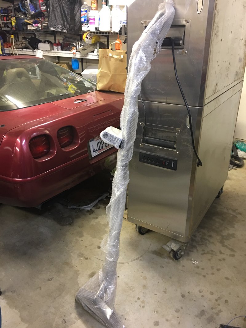

I have a new PMF ( Edit: Westpak) wand that came with my Sapphire still wrapped in bubble wrap. I'm thinking about having Tom's fabricator guy (Tim) cut it down for me and make it a stair wand. But I don't know if i'm ready for that sort of debauchery yet.

Damon, in the meantime, take one of those lip glides off. You're not supposed to be using both of them
