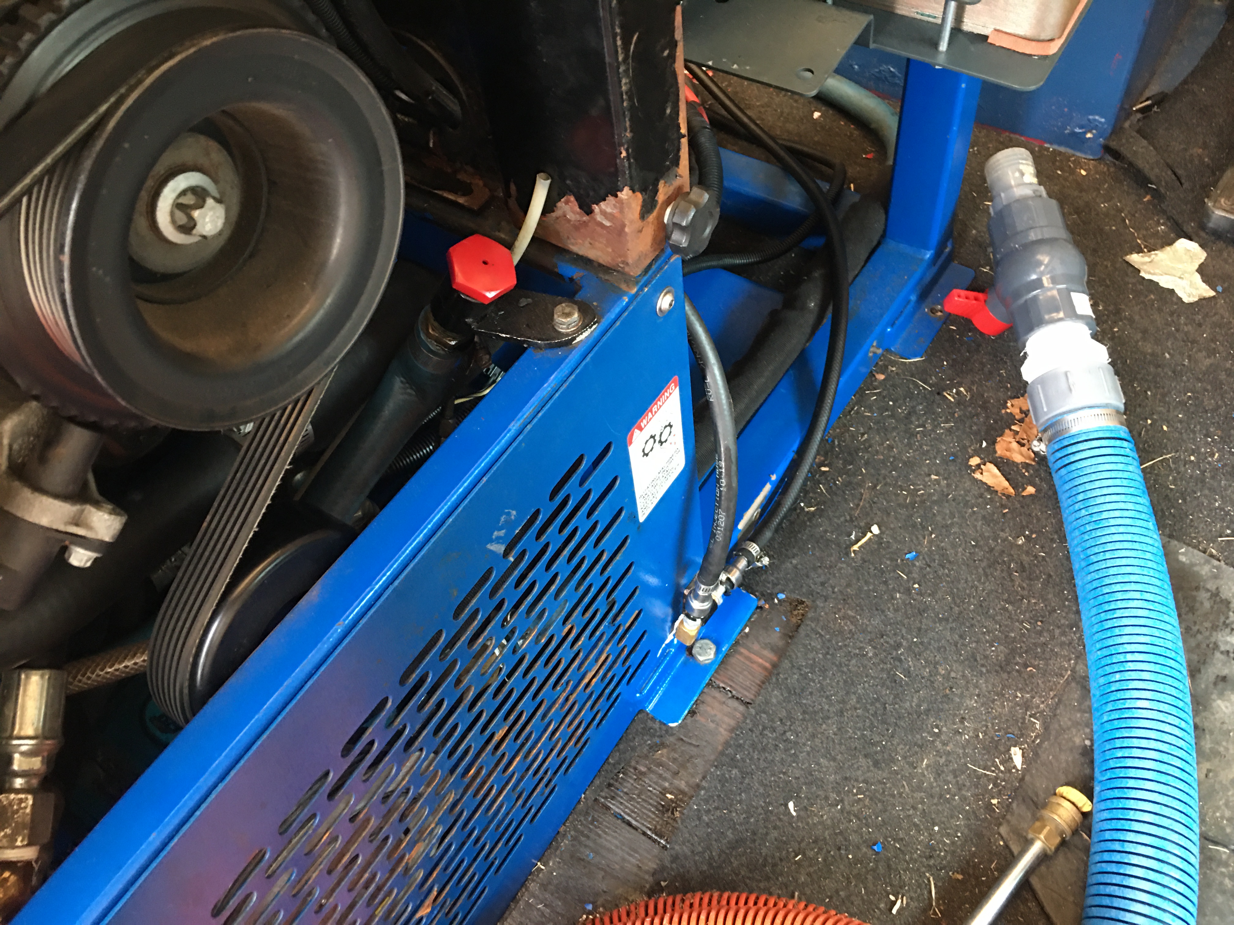

I’m taking it to the forklift later this week to move it. Rubber mats underneath are getting pulled up.
The waste tank was behind it but I think I’m gonna move it to the left side of the machine for better mounting space and ease of access to the rear and right side of the machine.

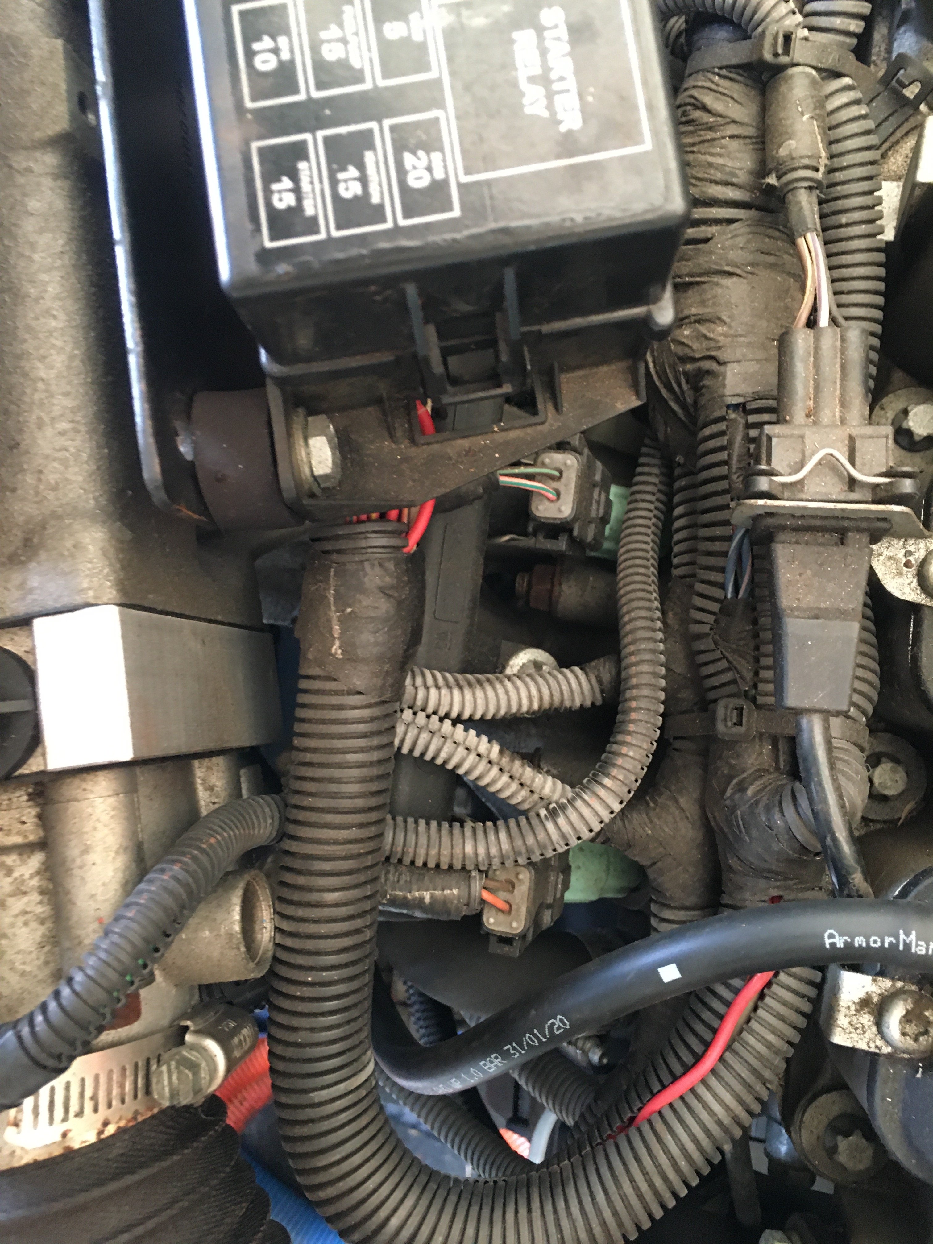

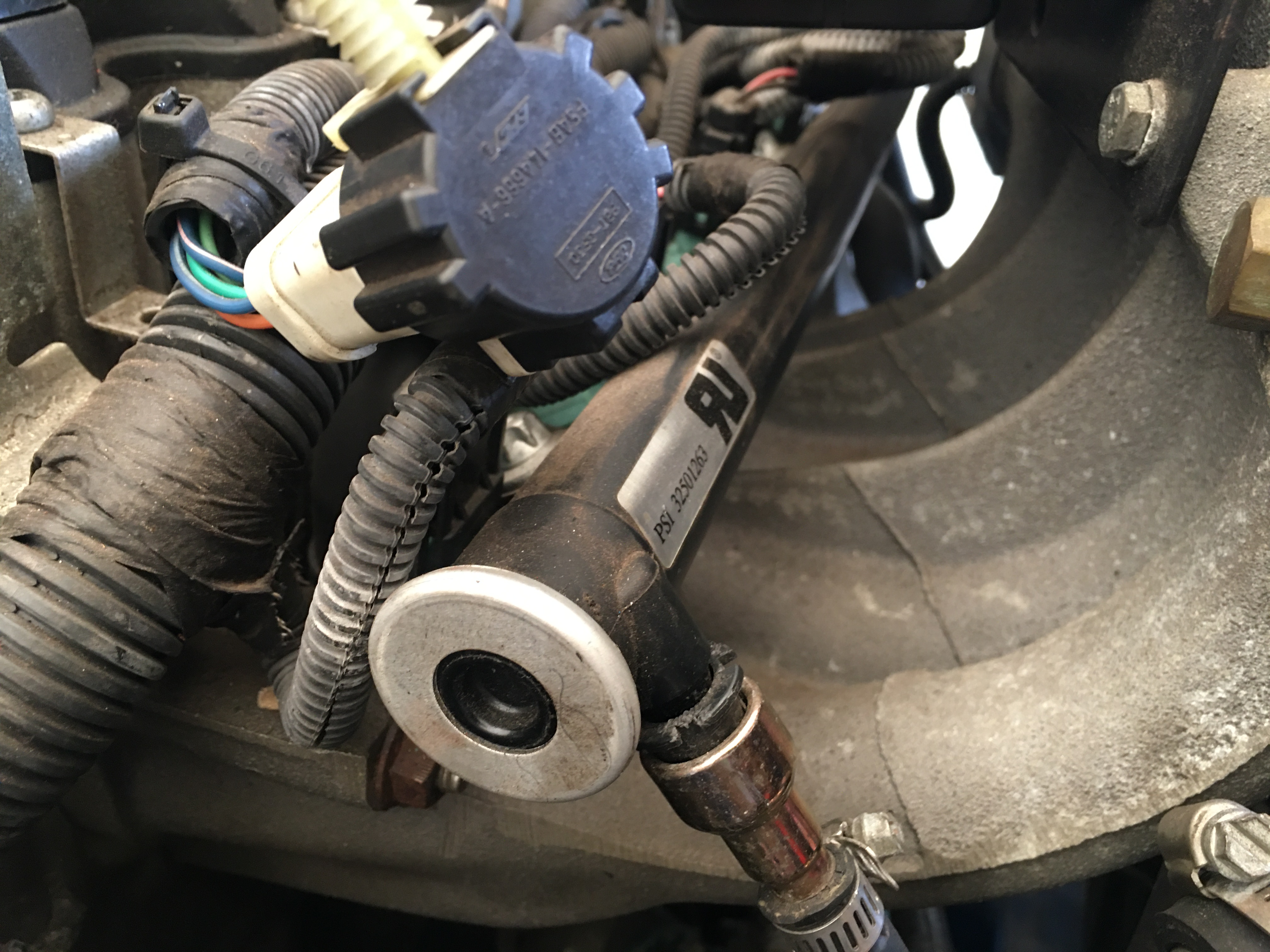

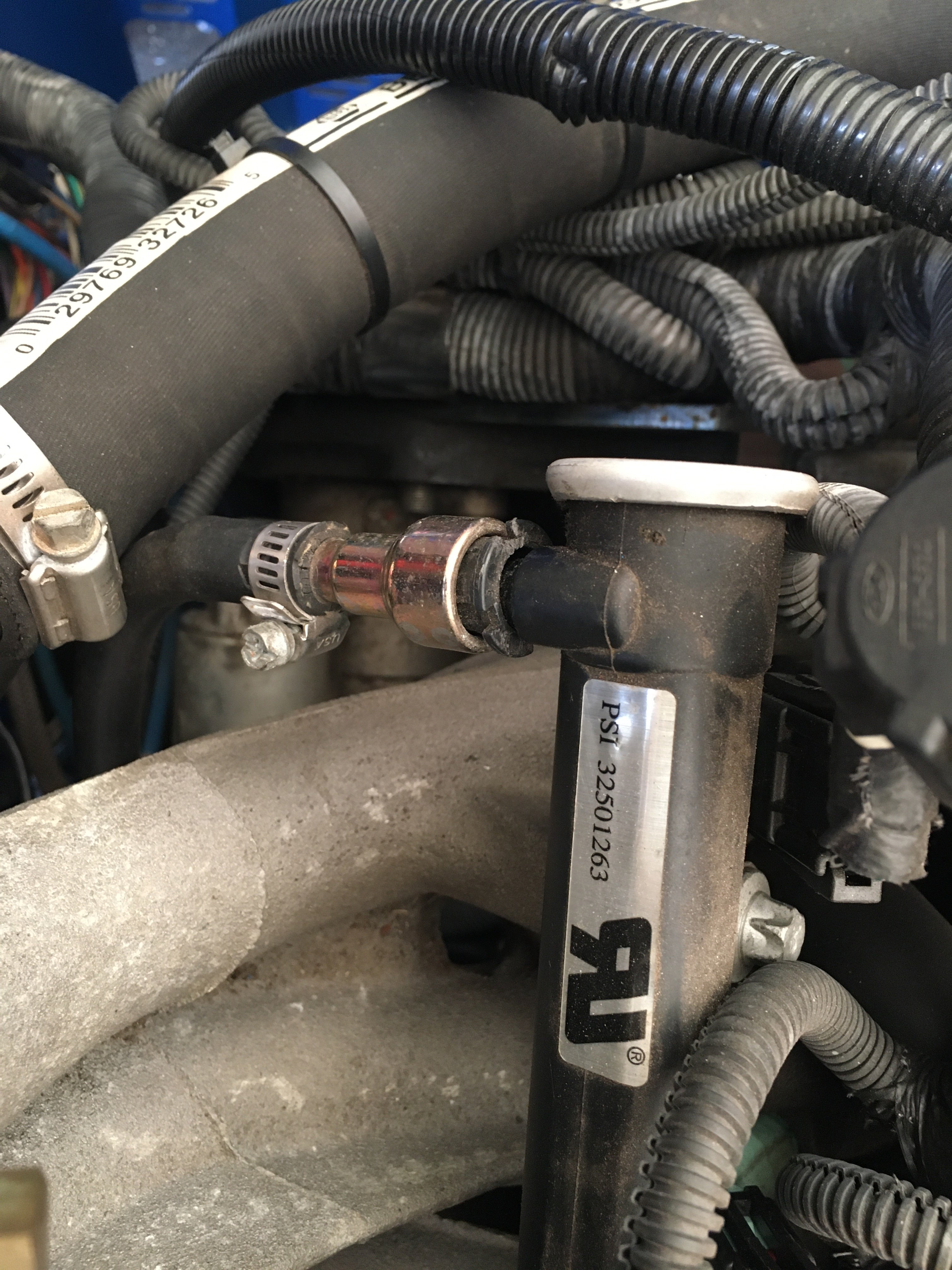

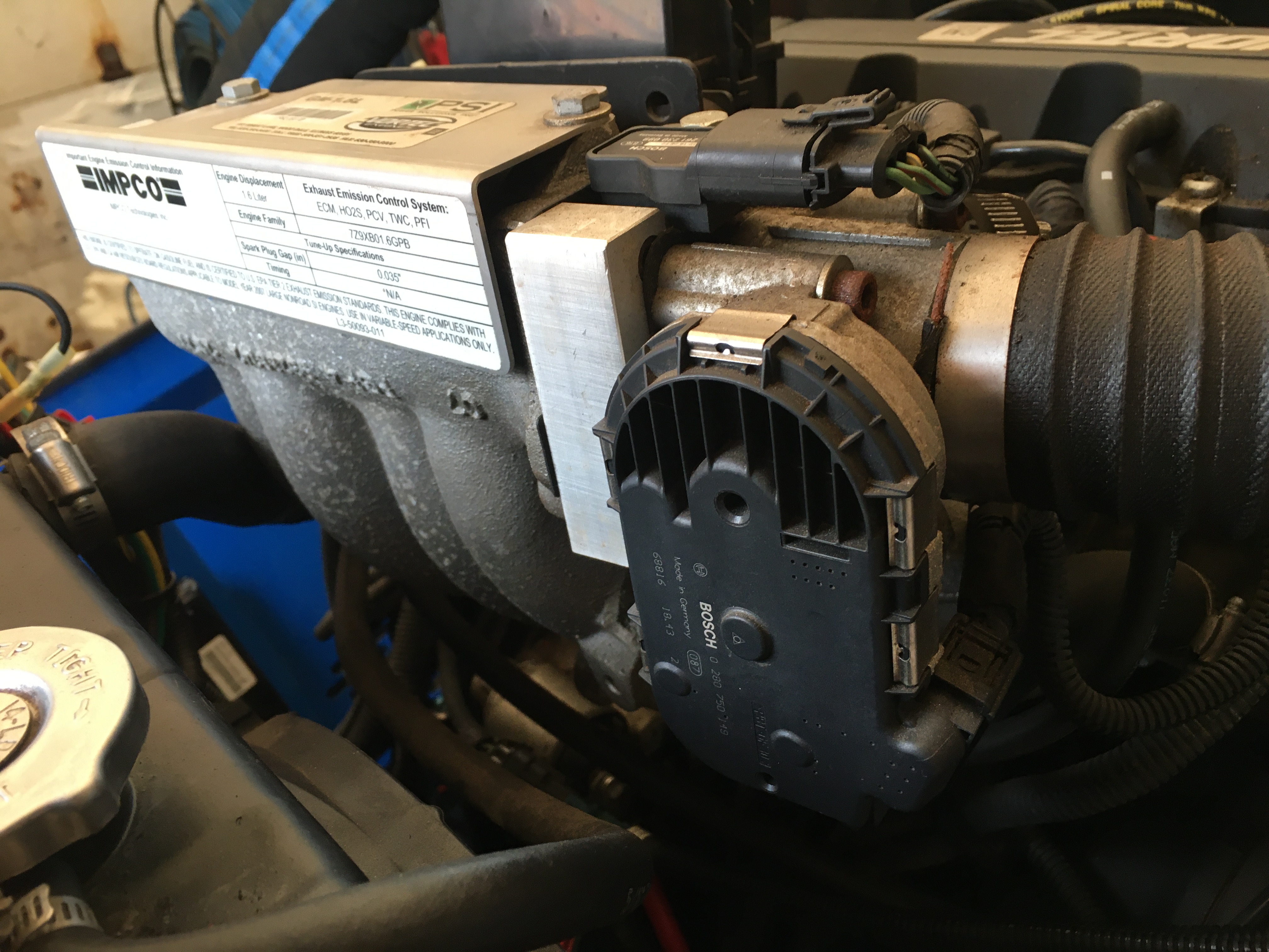

That connector close to the floor is where I’m reading 35psi right before the injectors.
Justin told me 55. And the chevy Aveo engine has the same pressure of 55ish also

It held 35psi from idle to full throttle. So my goal is to get it increased somewhere between 41-47psi. Is that correct?

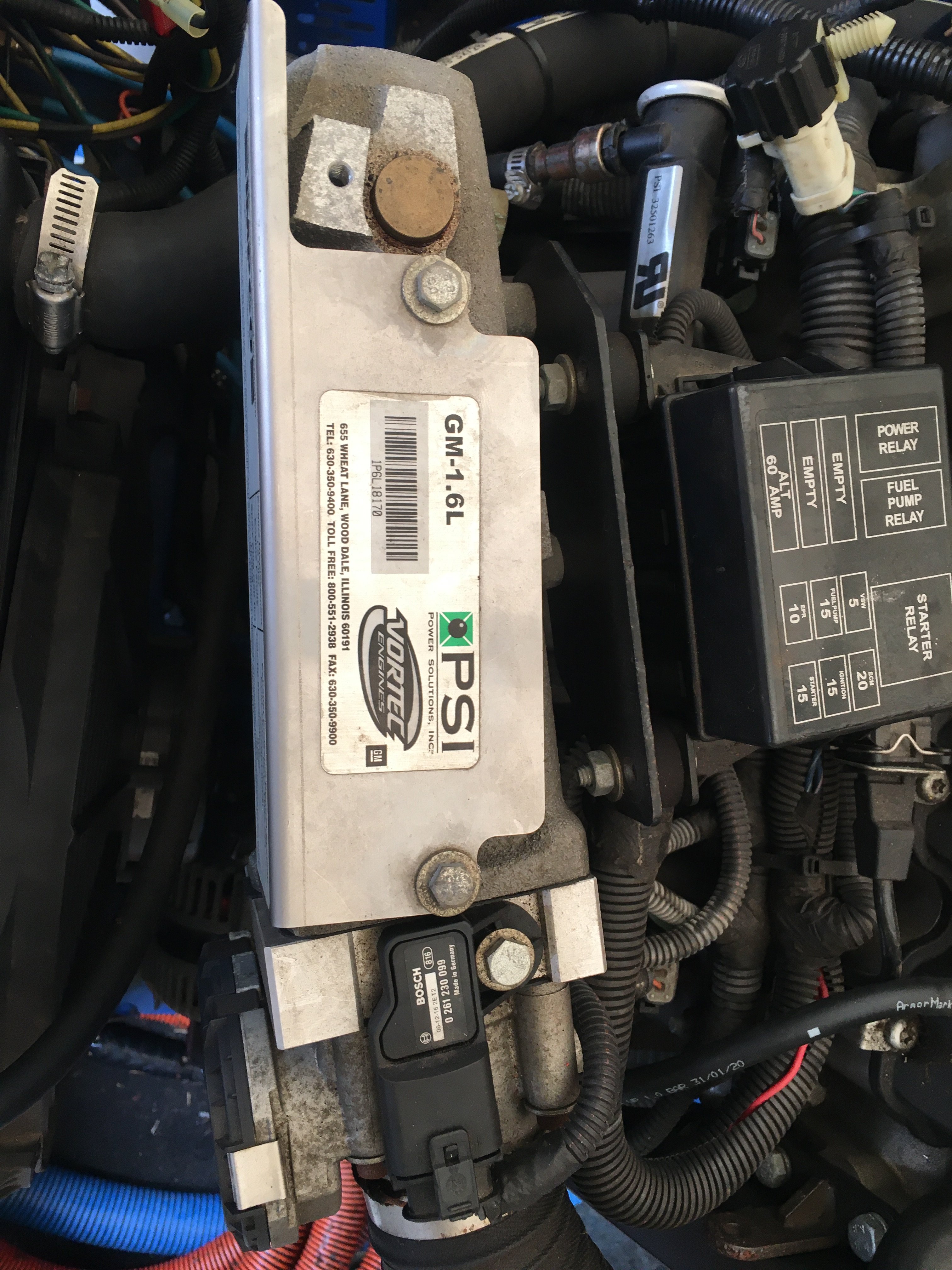

It’s the MAP sensor I replaced yesterday. It’s called a FPR in the manual but is a MAP at the auto parts store.

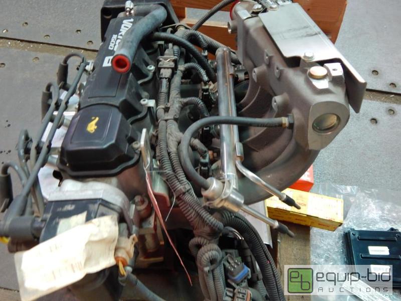

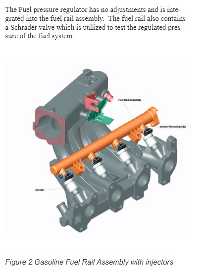

The voltage readings came out normal on the sensor on the fuel rail. I don’t see a regulator on the injectors.
And there is no Shrader on the fuel rail assembly
Reactions: FB19087
have you tried calling PSI
but that may be talking about the type where the FPR is on a tubing rail and not applicable here
