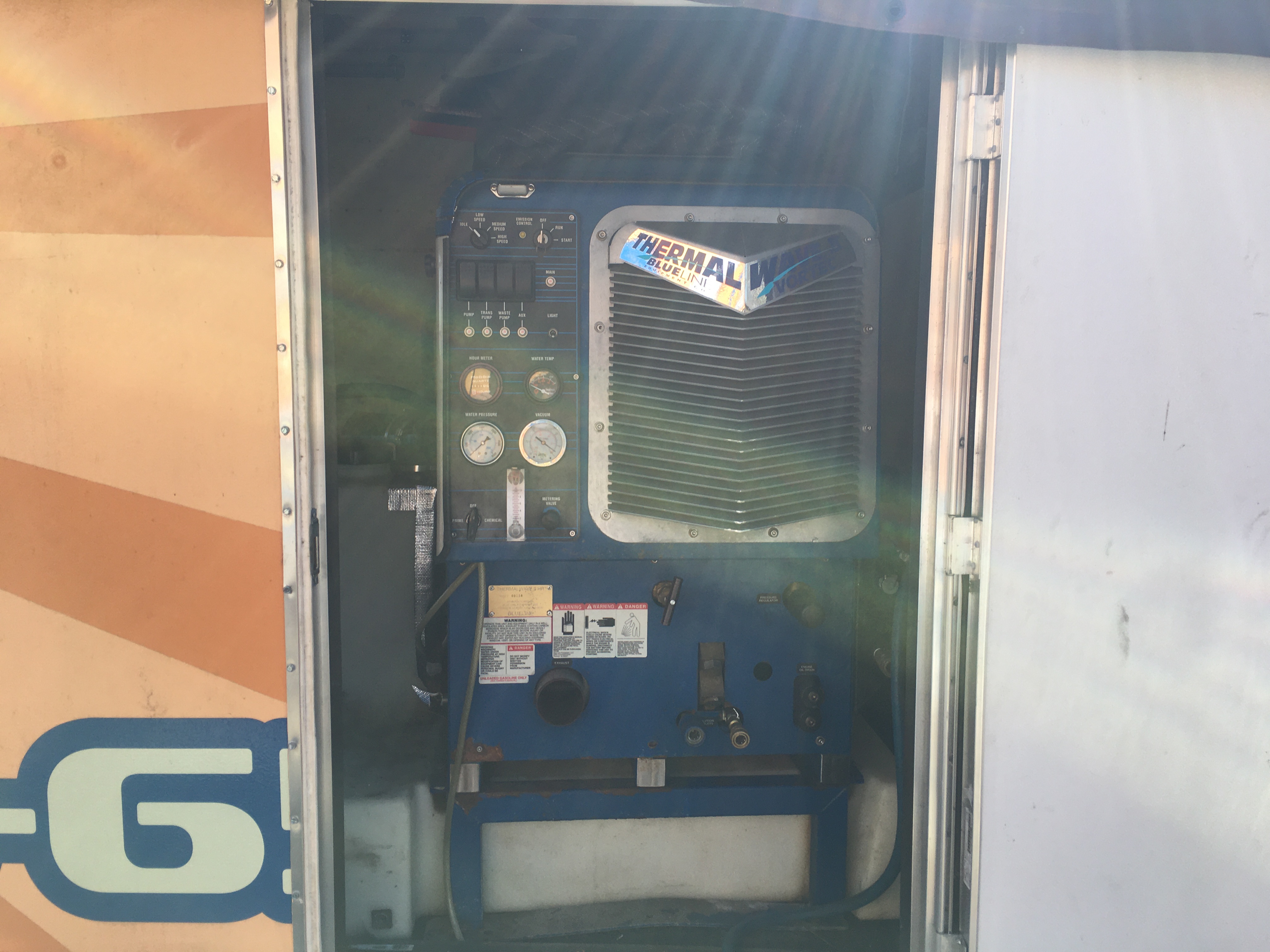

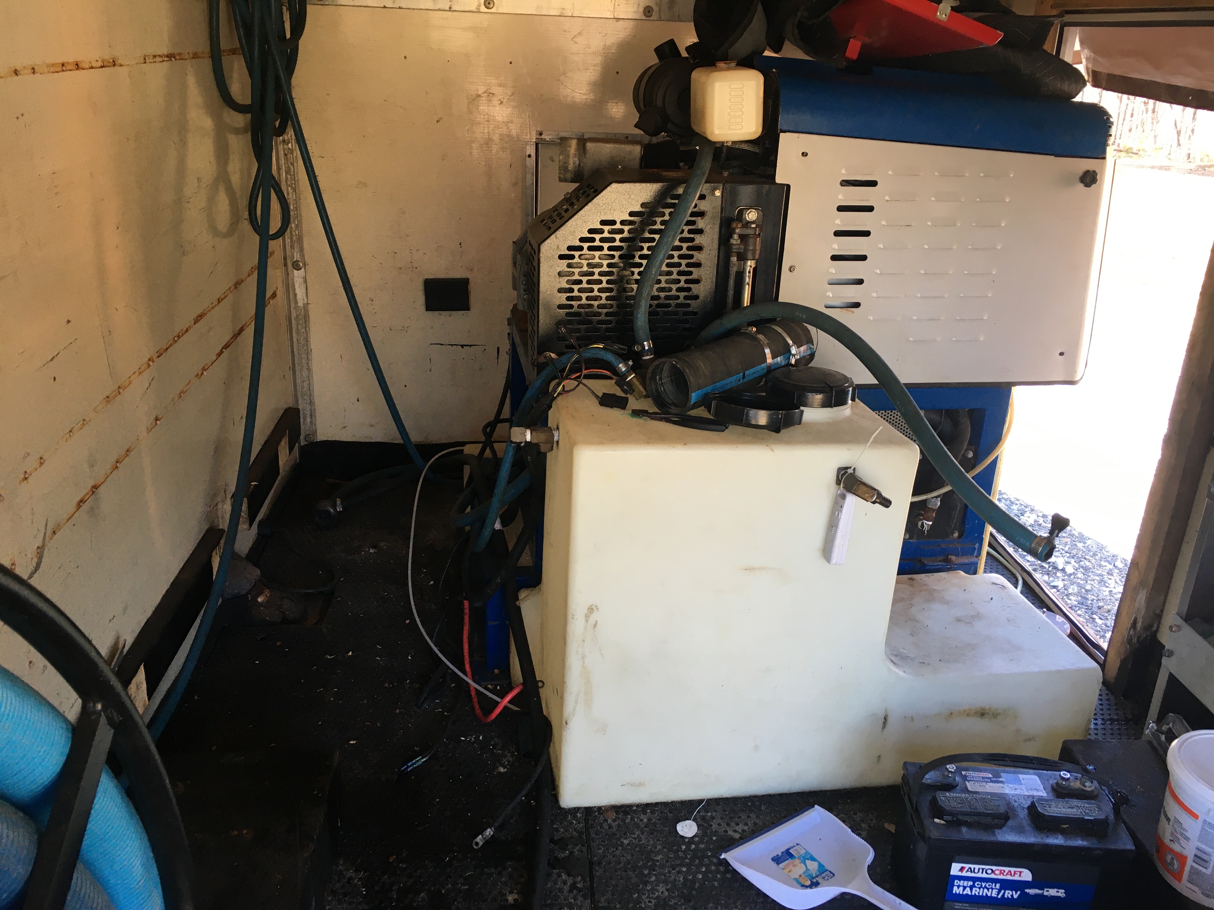

I’m taking it to the forklift later this week to move it. Rubber mats underneath are getting pulled up.

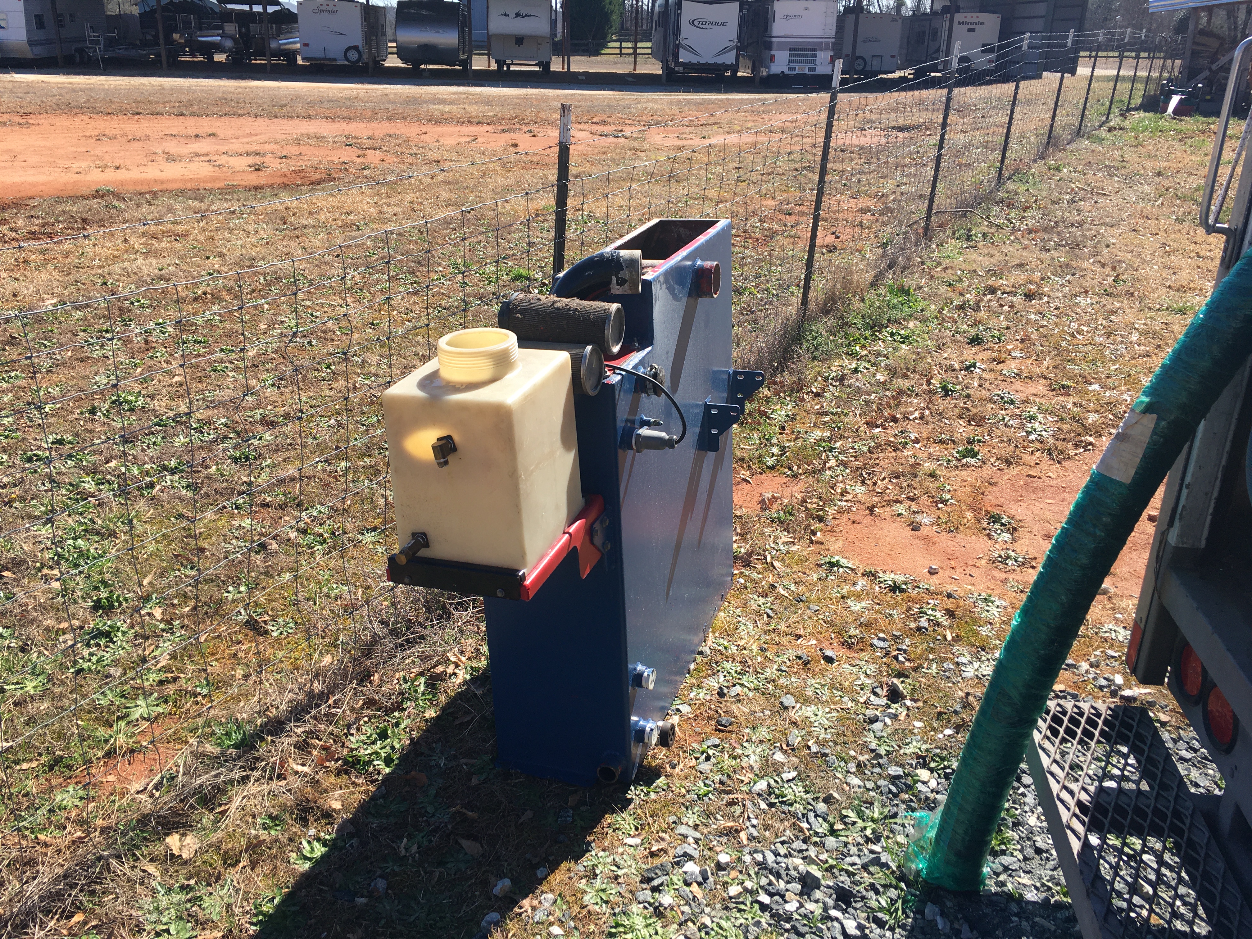

The waste tank was behind it but I think I’m gonna move it to the left side of the machine for better mounting space and ease of access to the rear and right side of the machine.
The van needs a power steering fluid reservoir, a tuneup, and a new rear door
As for the tm, the water pump needs tlc, and the 185f thermal relief valve needs replaced. 🤞. Once I get it completed, we’ll see what other issues it might have

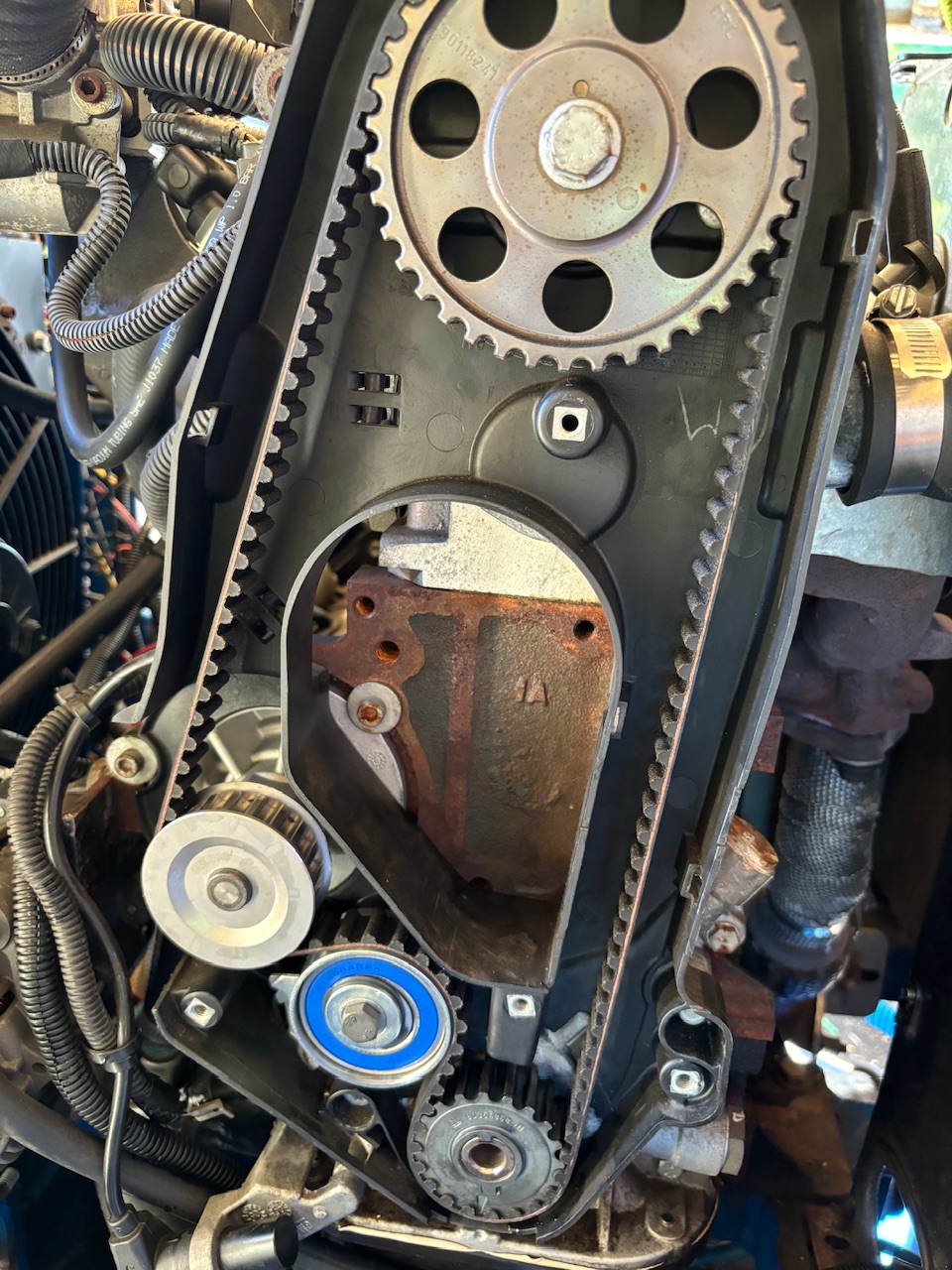

on the left side of the tensioner there is a "tab" with a hole in it. Push "up" on the tensioner to line this hole with the one behind the tab. Insert punch through lined up holes to hold it in place. Remove belt. Unbolt.
14,630
Thank you.

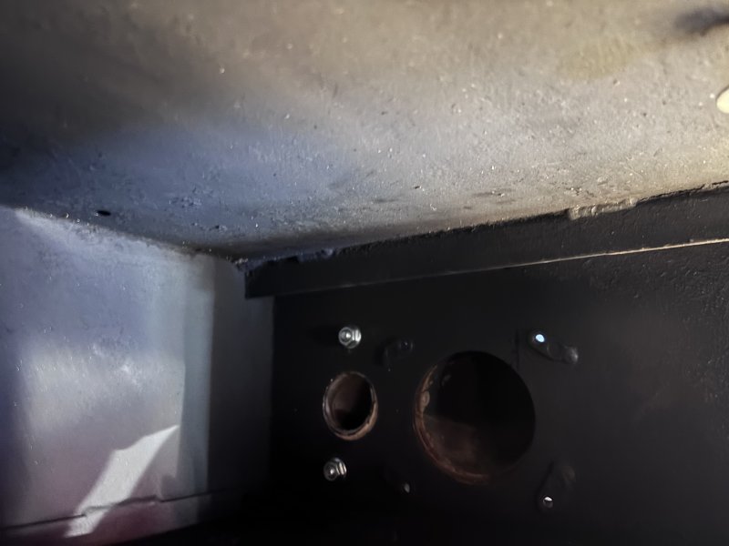

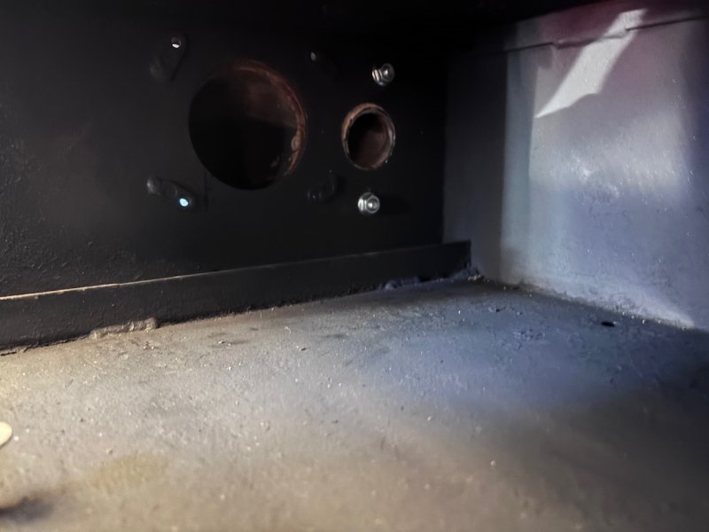

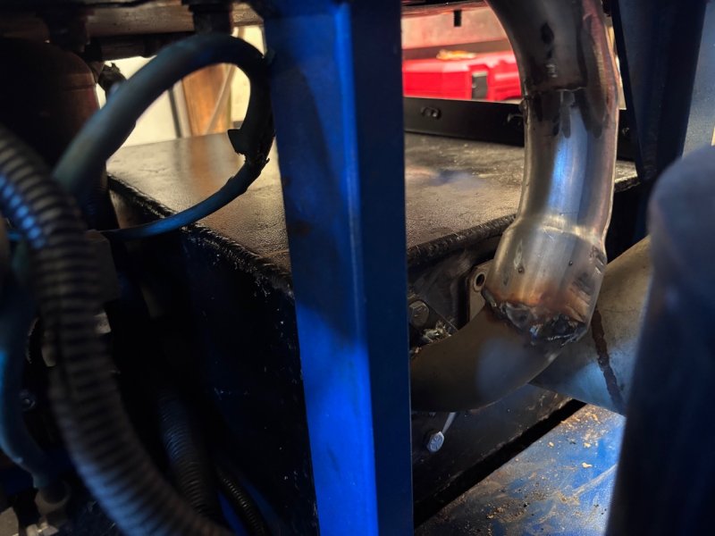

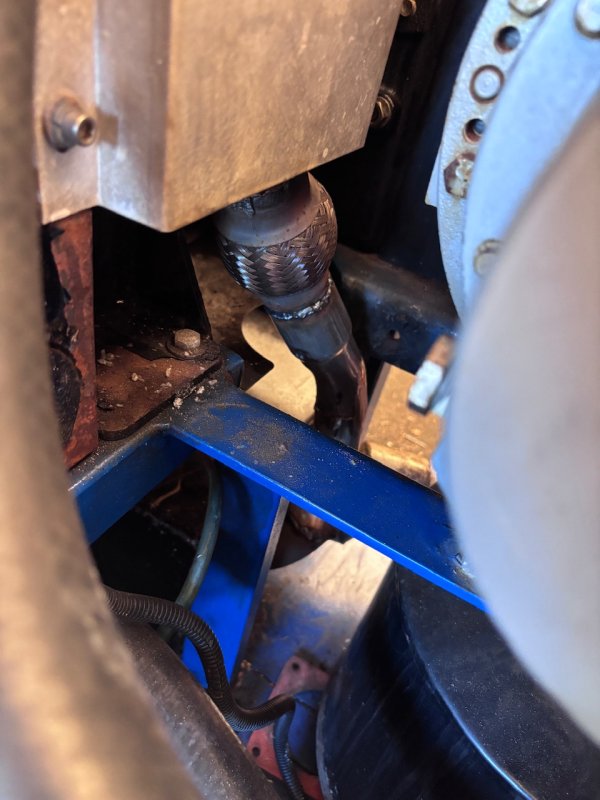

I finally removed the exhaust pipe/muffler that sat on top of the heat exchanger and routed the exhaust in the back of the heat exchanger box just like my Everest. So no more 700f muffler sitting inside my machine. It is now 250f external heat and using that to heat the water better

Yeah, it's been a long time since I started this project.
Yes, it has been cleaning allot of carpet with no problems. It's a very reliable setup and has been a great backup. It just never gave me the hot water that a machine this size should give. So I just kept wondering and asking others who have a really good understanding of this model how I could make it do that, and as I kept comparing the heat exchange system on all the other truckmounts this size (Everest 650, Hydramaster titan 875, etc) I got in touch with my shop guy and came to the conclusion that this is the best way to get that reliable heat without putting back pressure on the engine's exhaust.
