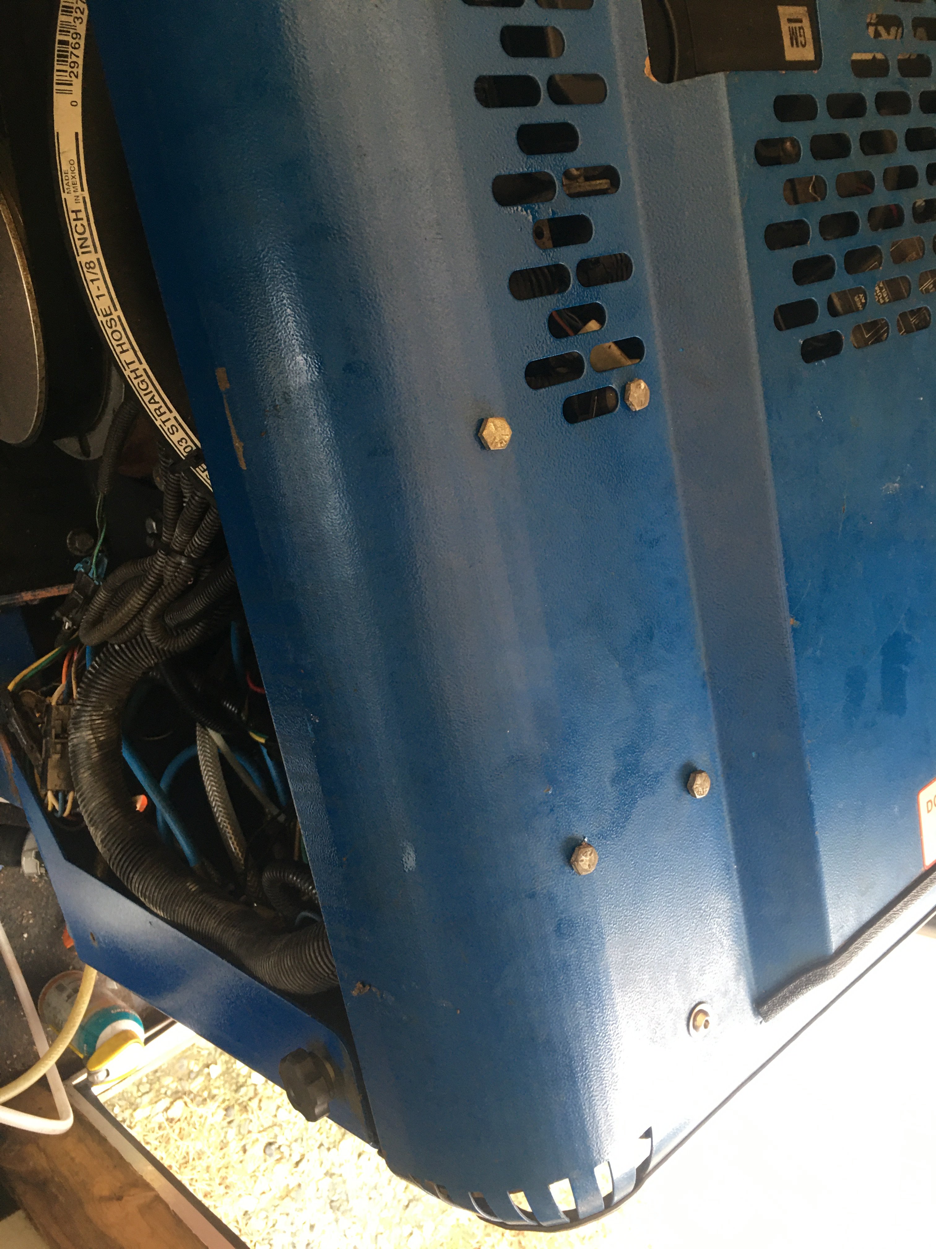

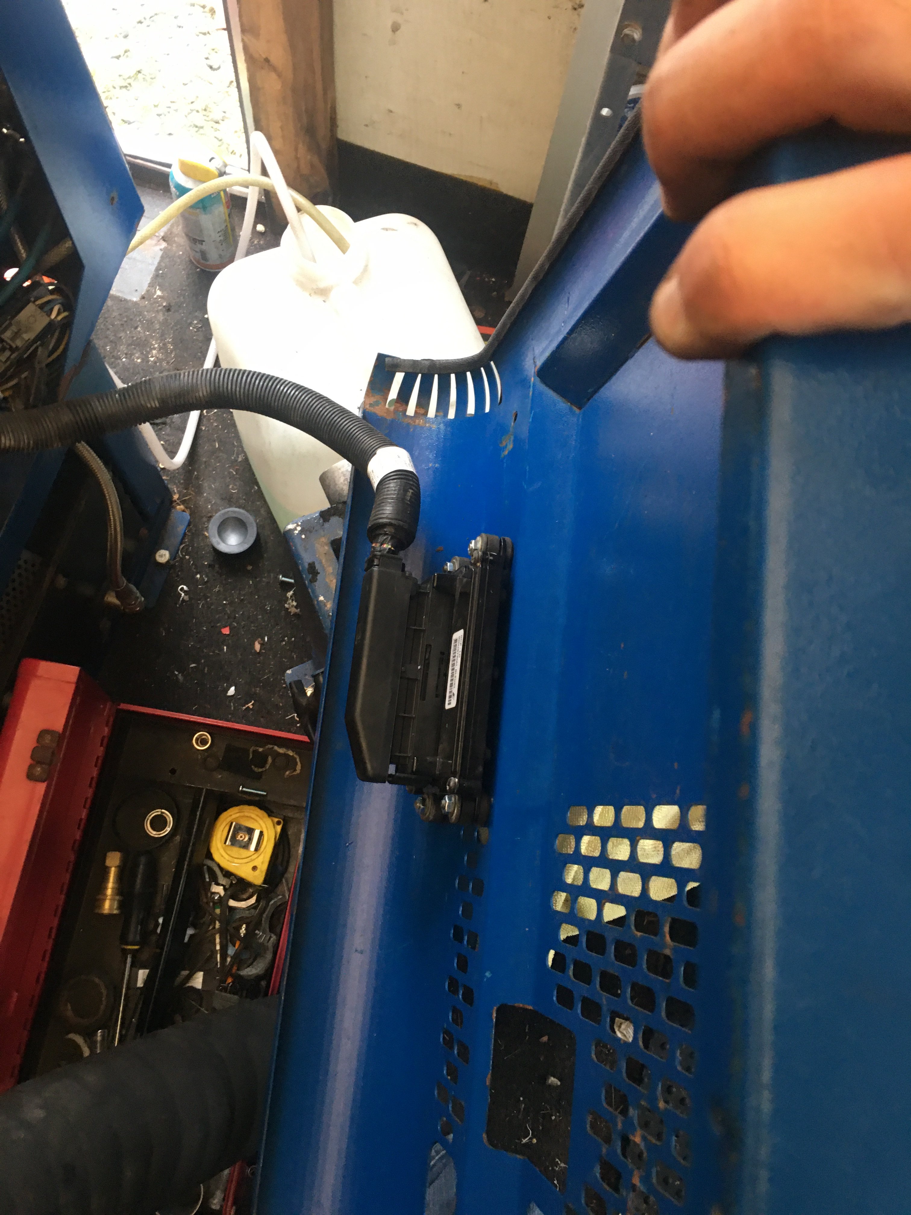

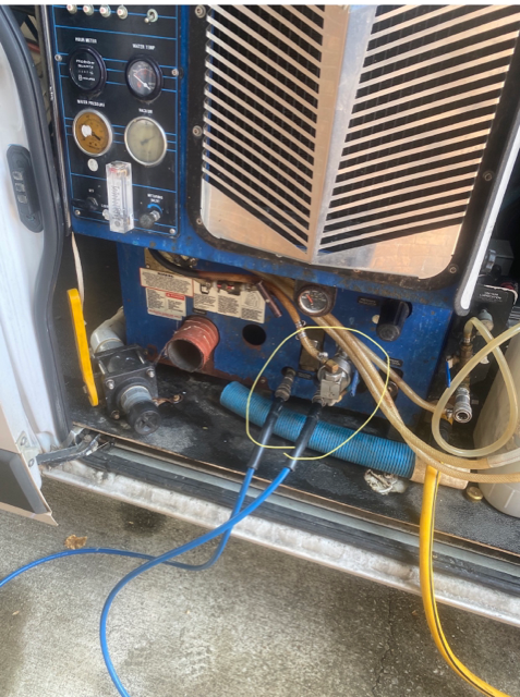

I’m taking it to the forklift later this week to move it. Rubber mats underneath are getting pulled up.
The waste tank was behind it but I think I’m gonna move it to the left side of the machine for better mounting space and ease of access to the rear and right side of the machine.
The van needs a power steering fluid reservoir, a tuneup, and a new rear door
As for the tm, the water pump needs tlc, and the 185f thermal relief valve needs replaced. 🤞. Once I get it completed, we’ll see what other issues it might have
View attachment 106620 View attachment 106621 View attachment 106622 View attachment 106623 View attachment 106624
When I go back to my original comment, thinking that was the only thing that was needed on this previous hunk of junk (now good running tm)...I GOT SCREWED!
