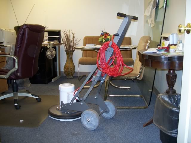

The New Defender.

Clark, It looks nice and manageable for weight and size. Can you tell us what is that new machine going to cost? Can you put a tank and sprayer on it?
Another idea is to come out with a light(like that one) and inexpensive cylindrical pre-scrubber. There are several of us that like the idea of the Windsor machine or Sebo duo brush or a used Host machine for agitating prespray in residential jobs.

Yes, It can be equipped with a tank. It is ugly. We put a platform behind the motor for a standard 5 or 2.5 gal container. The holes for the spray system are already there. But in residential work it gets in the way. And spraying furniture is a problem. The CX is designed for a spray system.
The price is $1895 and the MB special applies.
The light weight CRB is about 6 months out. The casting are in the works now.
The big CRB we build now will have a full HWE system on it. Pre-spray in the front, brush in the center and HWE in back. All Stainless Steel.

Clark:
Looks like my 17" Brute. How is it different?
The Brute without the spray tank is a very manuverable and versatile machine. (Encaps, padcaps, pre and post scrubs, cleans grout). It outperforms a rotary and is lighter in weight.

John, it is the same as our Institutional Machine, it is NOT set up for a spray system like the brute is, but it is very manuveable and easy to use.

The Brute handle is moved forward to support the weight of the tank. This is not the smoothest place for the handle. It works for the Brute with a tank. Without a tank it is much better with the handle back.

The machine in that picture.
Looks like the size I would want.
Will it or wont it knock the Thomas Kinkade's off the mobile home walls?

Mike, it is a definite possibility. However, the chances are slim.

I run it in my home with no problem. A 1/4" plywood floor in a mobile home might be a problem.
