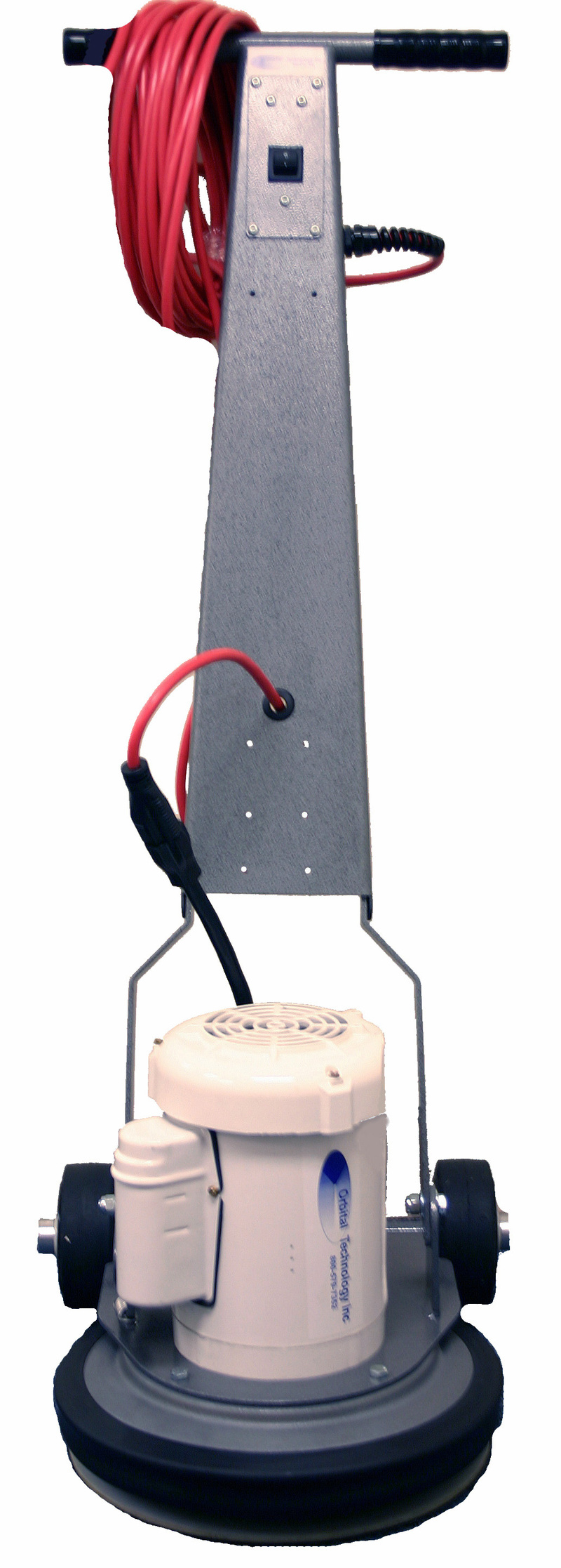

Is this what you're proposing?
17" would be great.

No that is a 15"OP. I have one more pass to make on a Rug Revolution cylinder and I will make some pix. It looks like a CX. But the handle is moved back. It run smoother than a CX. The handle back will not support the tank and solution.

My 175 is 1.5
which is also what JG claims is best.
Sell me on the 3/4.

I tried 1 and 1 1/2 hp buffer motors from GE, Howell and Imperial. They died in 4 to 6 months. I had to replace every one. I still have 30 in my inventory. The motor I use now is made for my use. Buffer motors a geared down from 1800 rpms to 175. OP is at 1800. I have had to eat enough motors to know what will work. 3/4hp for a 17" OP is more than enough power.
