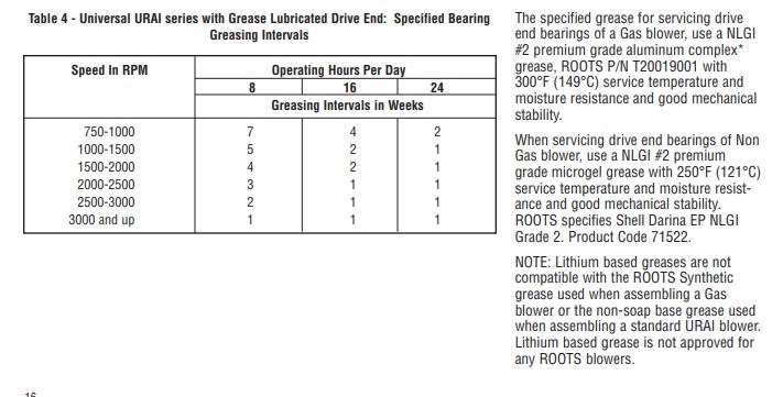

I’ll be getting another tm in a couple weeks and it has a 56 blower with grease ports. I forget what type of grease to use and how often.
Should I grease every 100hrs with oil change or is there a better schedule it should be on???

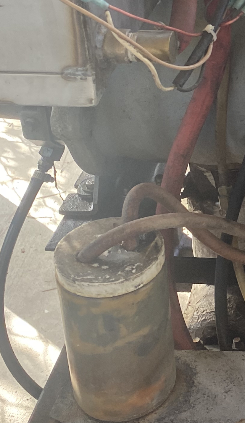

I also want to attach some hoses to the drain ports so the grease doesn’t make a mess. Any idea on what type of container I can get that doesn’t look like a beer can?
Poke a hole in the lid of a mason jar. ;)
14,635
Eh, I’ll try to find something to blend in. If I can’t find anything, I’ll just spray paint the jar to blend in with a zip tie around the lid attached to the frame.
I was at the local distributor and he was ordering a replacement blower for a cleaner. When he got off the phone he showed me where the guy had attached a hose with a small petcock type valve. Sharp guy, accounted for the extra oil and everything.
Except he didn't count on bumping it a little and it opening enough to lose the oil while cleaning. The blower ran dry and wrecked it.
If you do add a hose, don't put any type of valve on it.

Hard to get 8 machine hours per day on a TM.
I would just go with the 100 hr schedule.
And no need to run it while greasing.
Grease it slowly till it exits the vents. Normal operation will expel any excess grease out the vents.

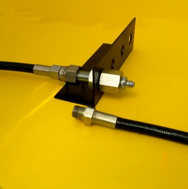

Just pump 4-5 squirts in the blower when ya service the engine. I always do it when the blower is cool also.
I buy Lucas brand grease that's green in color. Has a high temp rating.
A quick wipe with shop towel.after first job takes care of grease droppings
