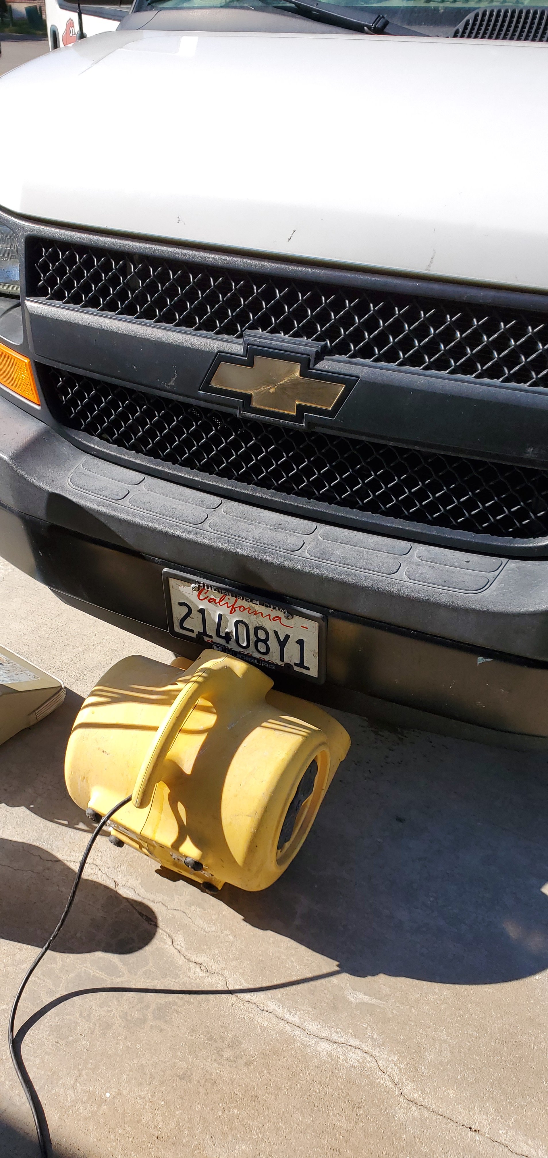

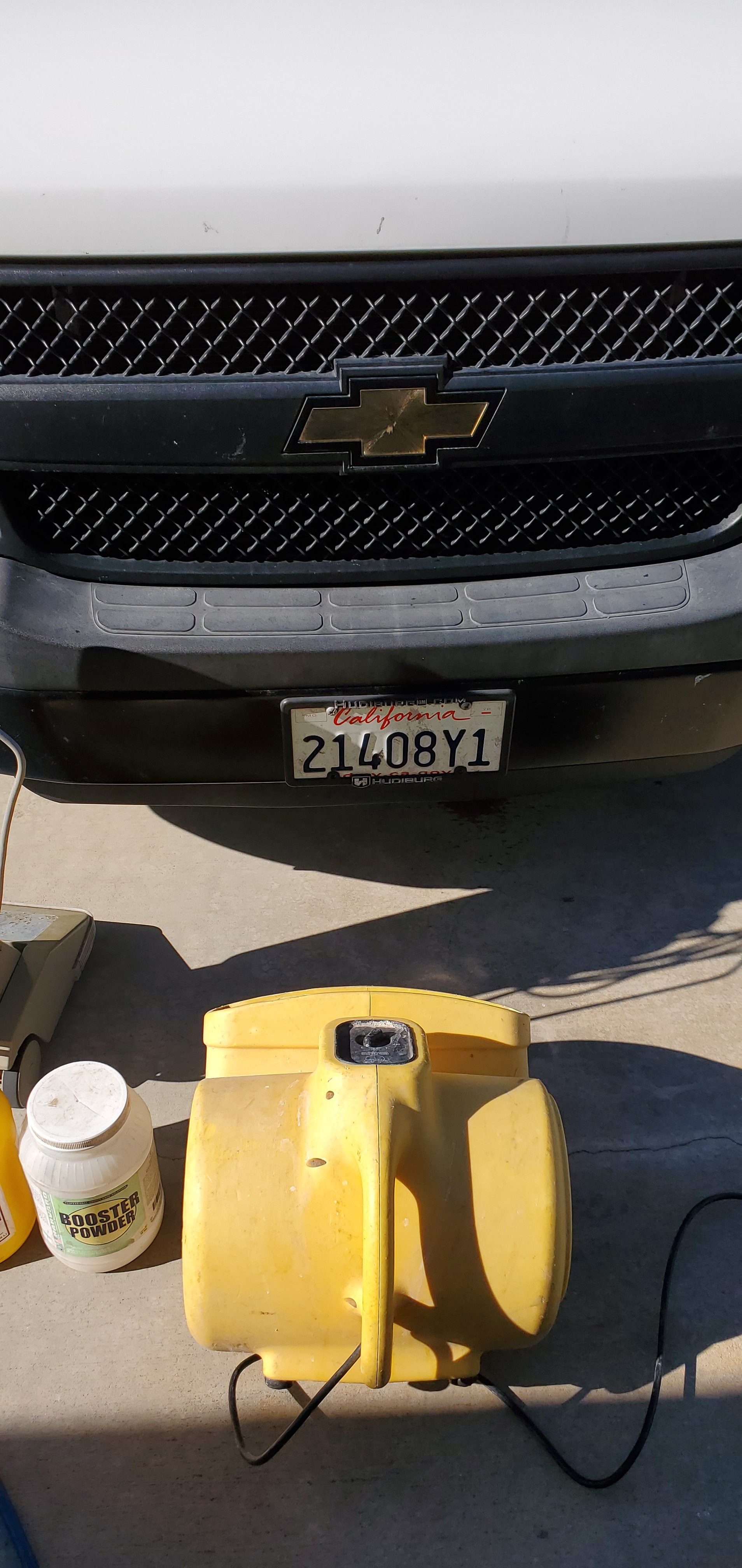

Blowing a fan at the front makes no difference with air flow.
Couldn't feel anything until the van fan kicked on
And only on the passenger side could I feel movement of air.
I could see a higher rpm helping with fan speed but that would create more heat to cool also.
I really hope to get the 5 years out of this van get it paid for and give it away.
2 more years of payments and I'm starting to get discouraged.
I dont see what sapphire could or would do.
Seeing as though there's alot of end users holding the stick
Probably my last sapphire unit at this point.
Because the 870 650 is way overpriced and the 570 isn't available here, and the little machine have heat but no where near the vacuum.
A slide in with a decent blower exist just have to look.
would you expect it to?
and isn't their a lower radiator baffle or is that removed?
I wasn't sure but that's been suggested to help cool it down.
Iam saying it doesn't appear to help.
Maybe if you shoved it in topside but it isn't going to blow through the radiator and I think there is a baffle/plastic shield that would prevent airflow from entering the engine bay as you have it directed

I wasn't sure it airflow would go through the radiator.

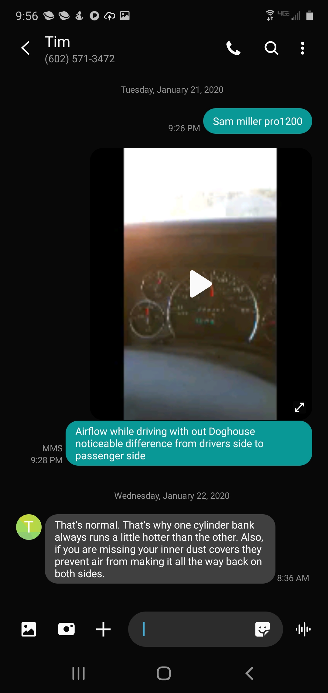

But when I drive it at 50mph there significant airflow on the passenger side with the Doghouse removed but practically no airflow on the driver side.
At this point if they figure out the engine code and fix it I am tempted to leave the dog house off

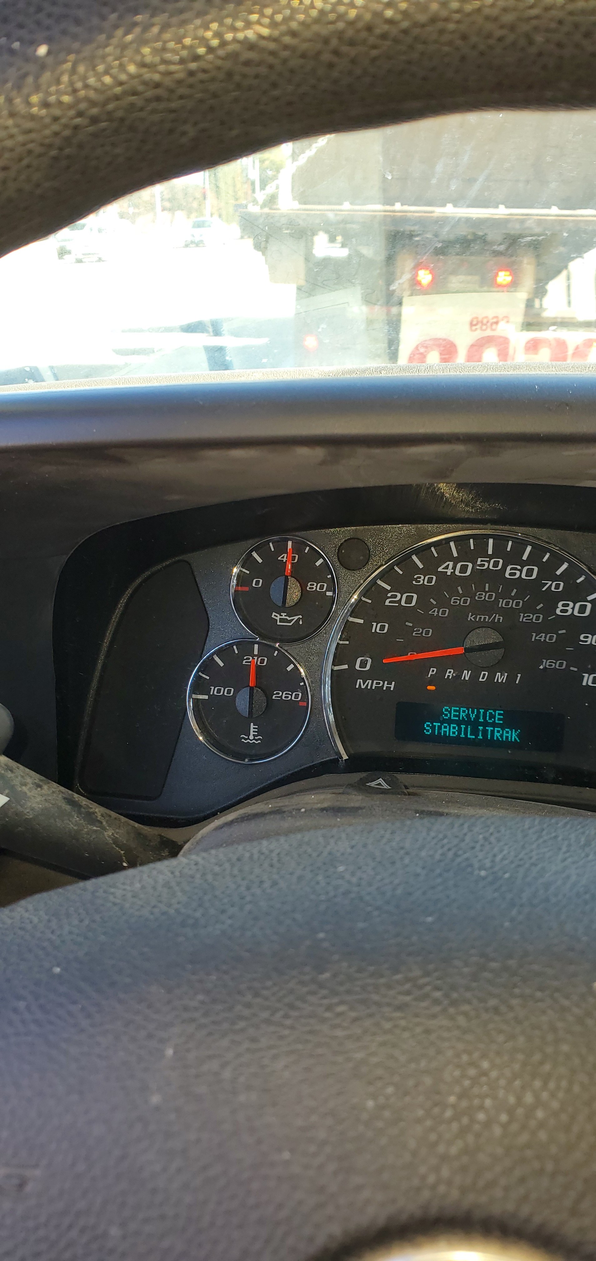

Its was bank 1 bank 3 bank 5 bank 7 open injectors.
Today they said it was an injector code.
Like if I use the van after a computer reset it takes 2-3 days for the check engine light to go on and goes into limp mode. Sometime it kicks in faster.
But I let it sit for 3 days and it ran fine when I took it to Hugo's.
Hugo's notice it went it and out of limp mode depending on how hot it was.
He suspected catylic converter possibly.
It's a 2016 chevy Express 4.7 liter engine 42000 miles.
When I Google the engine code its says bad injector or bad wiring or Ecm.
I would think they would look into those three things
