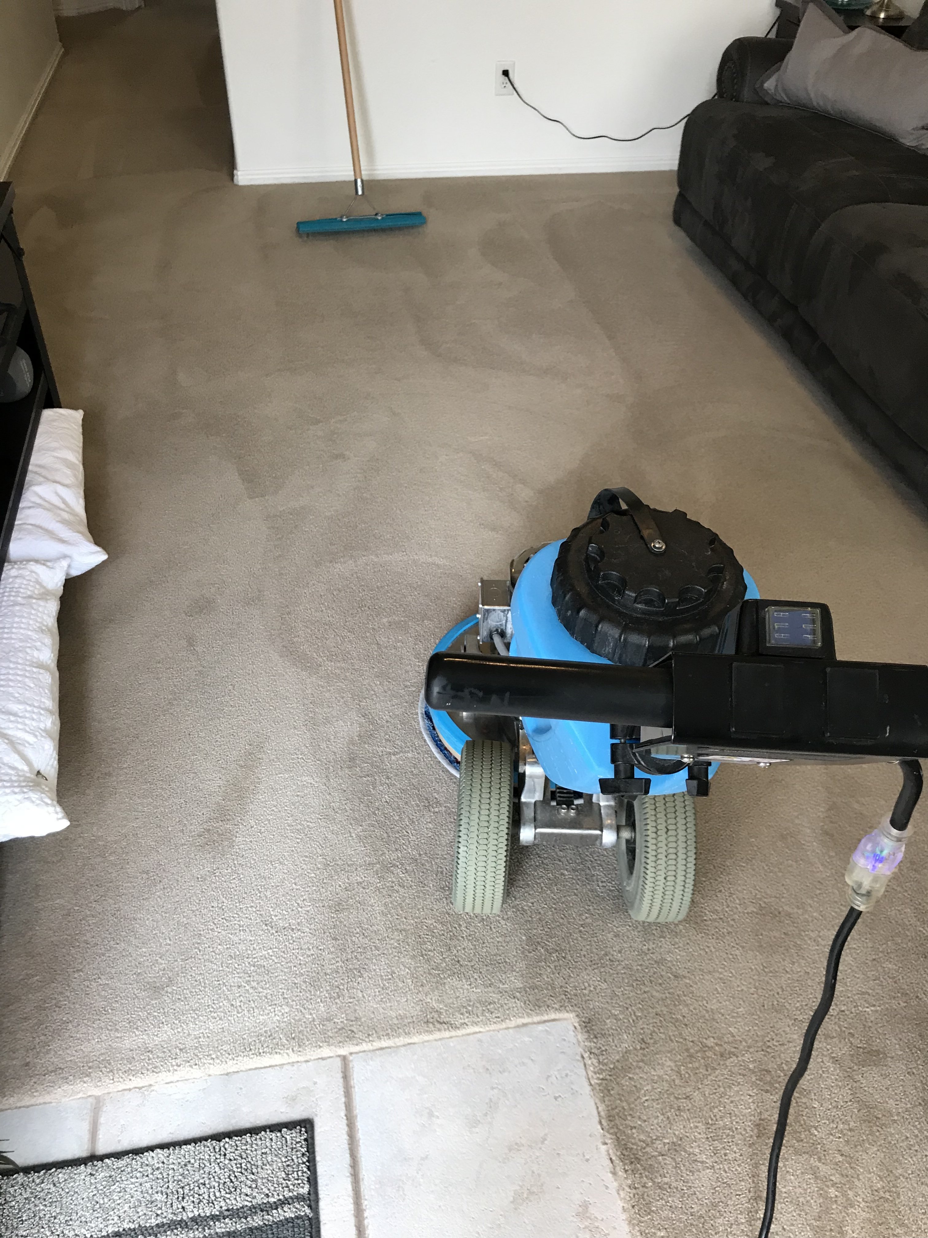

Eric
And broke down in the customer’s driveway today. Good thing ole trusty was in the van.
