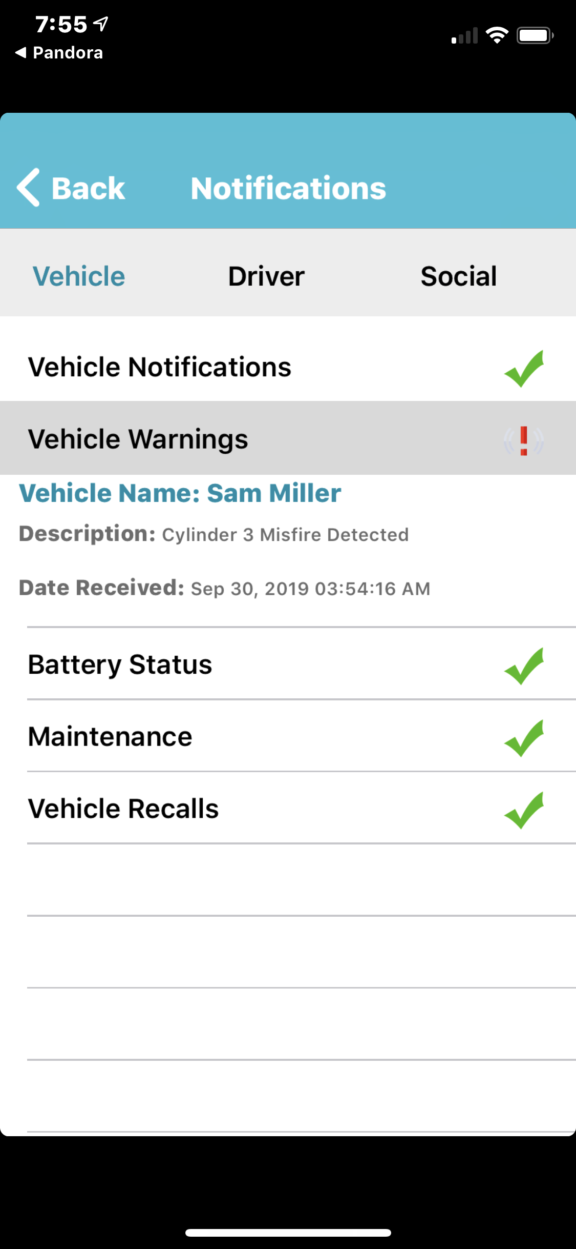

Originally it was cylinder #5 misfire now it’s #3 misfire
That’s the code my Vyncs gps device came up with

Put on the one wire for today reset computer and it runs good $40 cash for my mechanic to help me replace it
