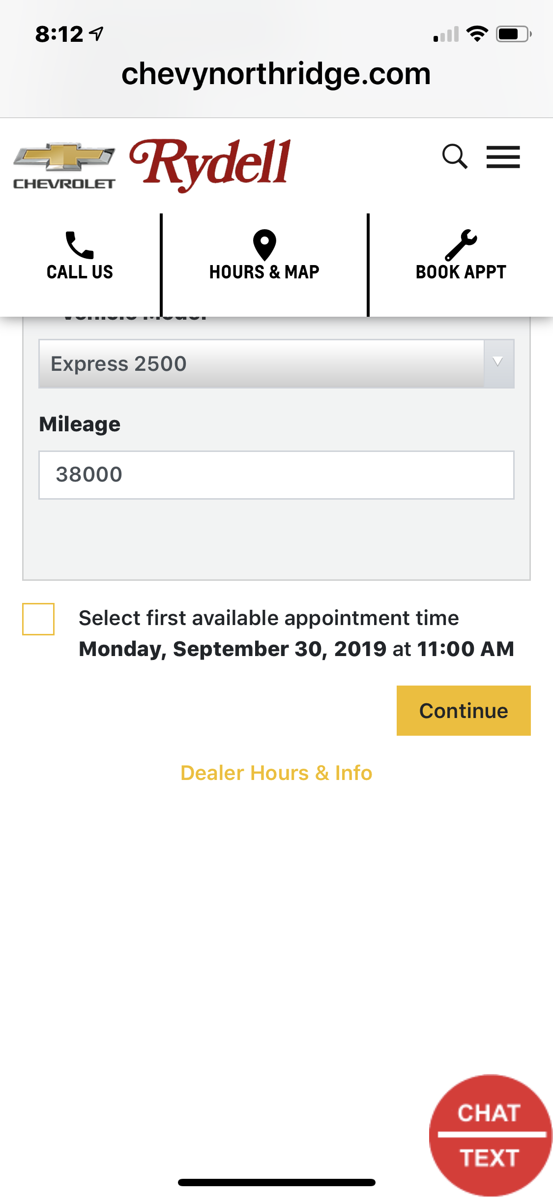

Ok so Chevy says van ready to go but I should tow it to Northridge.
Aprox $500 to tow it 62 miles.
they day it’s a couple bad fuel injectors but won’t know for sure until they tear it down.
I figure I bought the van through Empire they got it through a place in Oklahoma the place hydramaster uses.
Well I’m going to have towed tomorrow to Northridge. But I’am not having. It towed back to the AV.
There a Chevy dealership in Northridge.
I’ll bring it there and let them work on it.
Afterwards Empire will send somebody to pick it up and and reinstall the clutch drive and I can go pick it up.

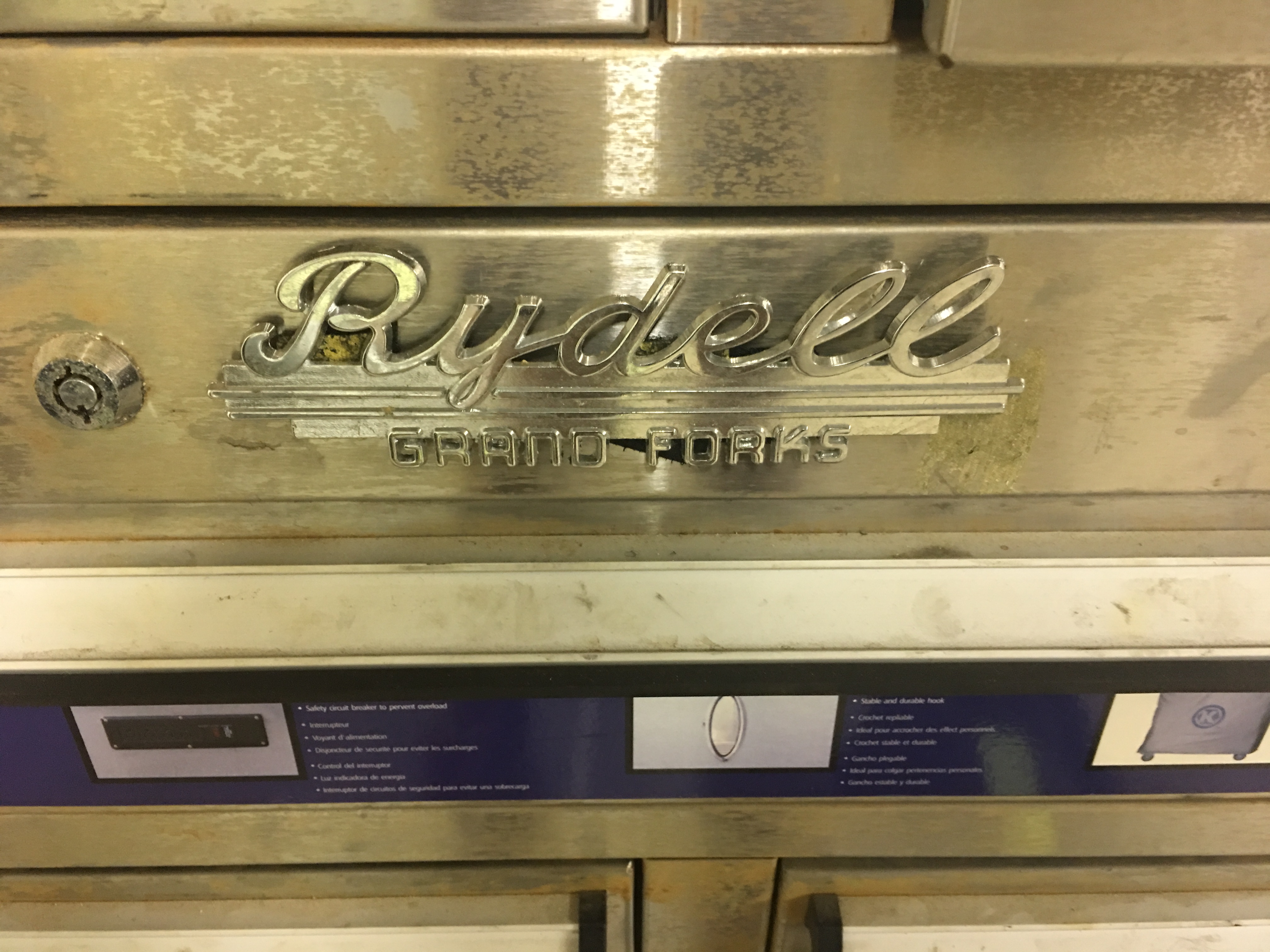

Rydell Chevrolet... 30 minutes from my home town of Warren, MN in Grand Forks, No. Dakota and Grand Forks was the start of our family business 53 years ago.

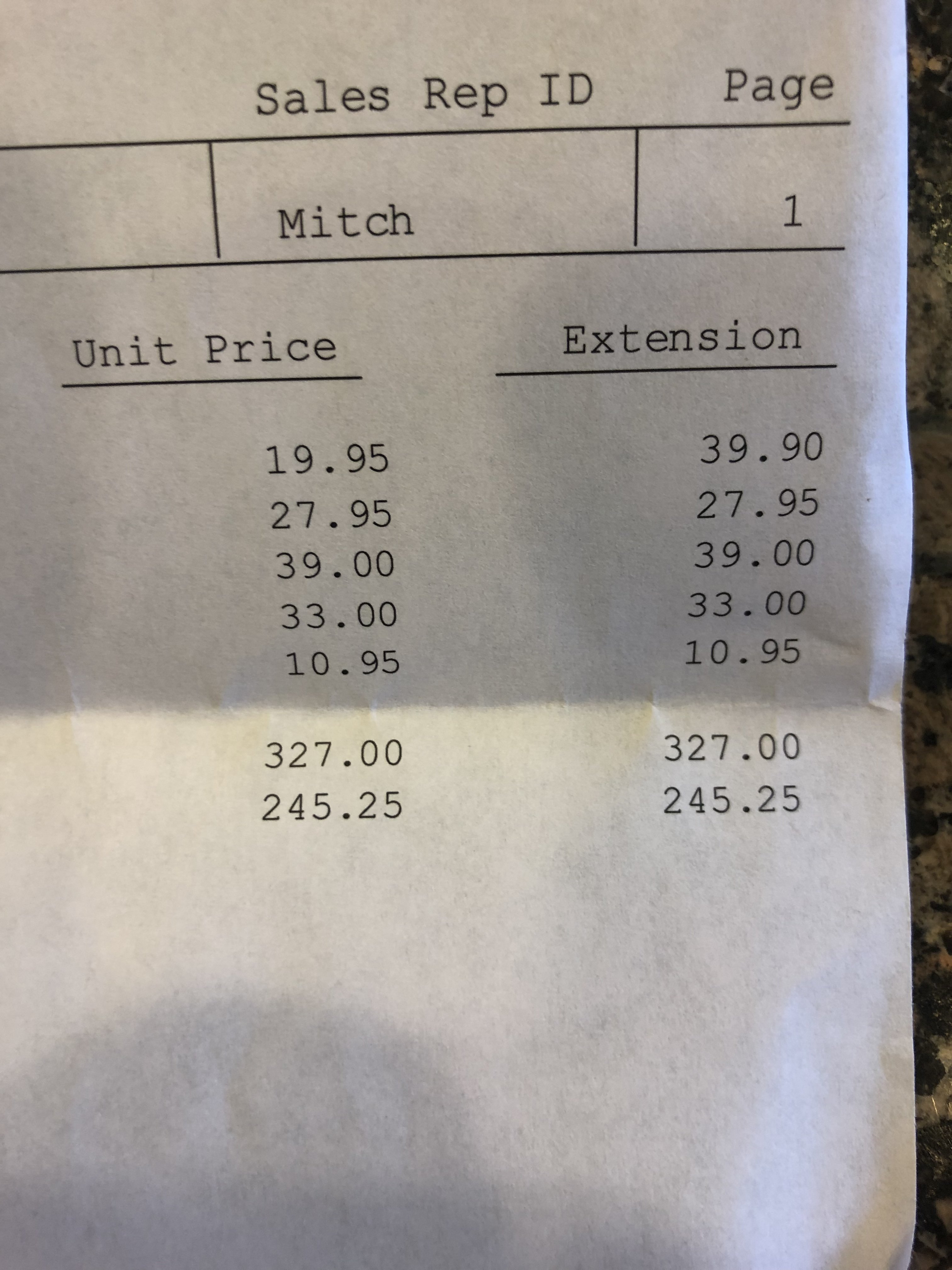

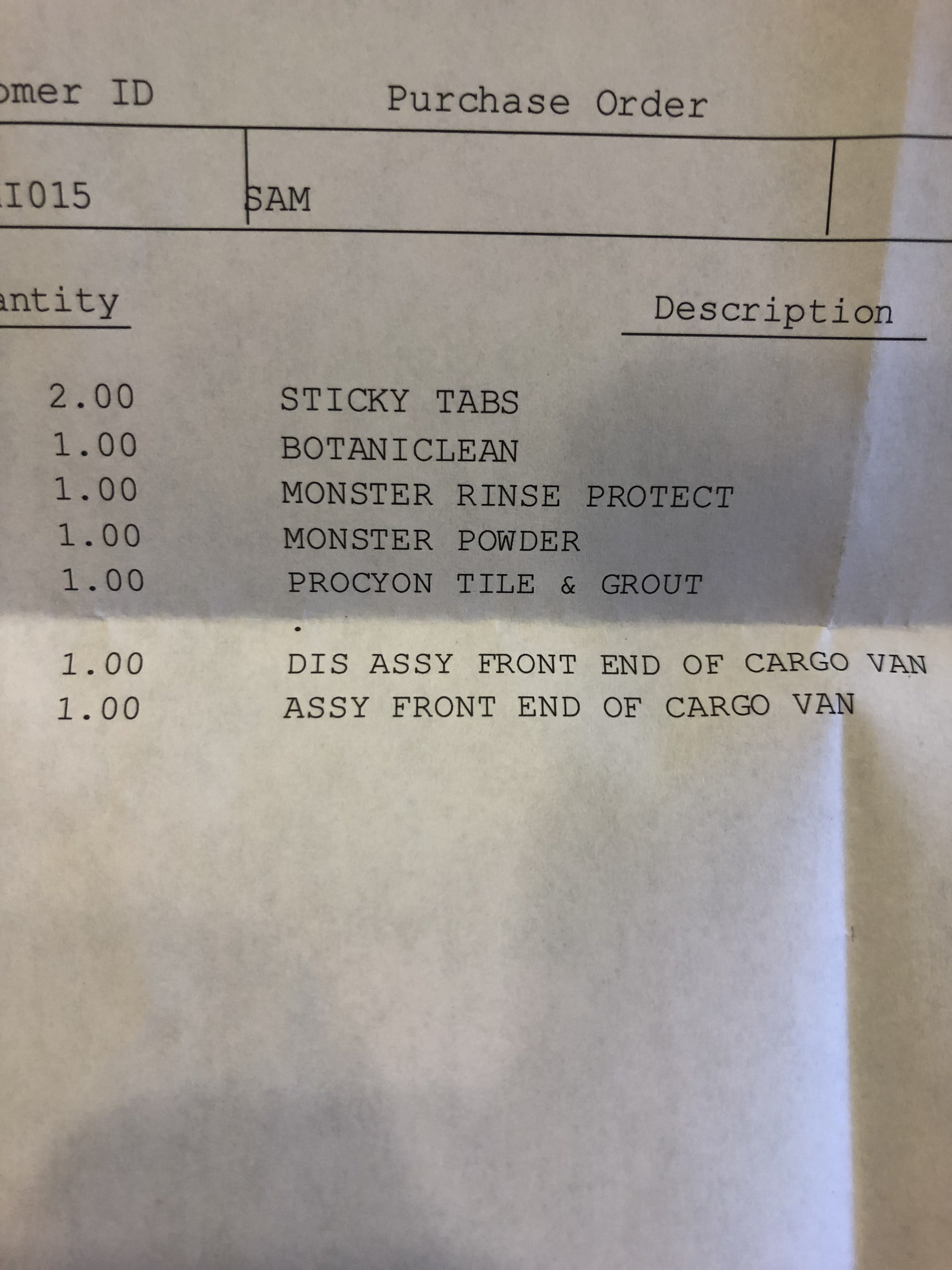

11,309
California
All for a $35 wire and an idiot who couldn’t plug the mass airflow censor back in
$520 new battery and spark plugs
Tune up too!
Uninstall reinstall truckmount clutch drive
$572
$300 labor to find bad wire
