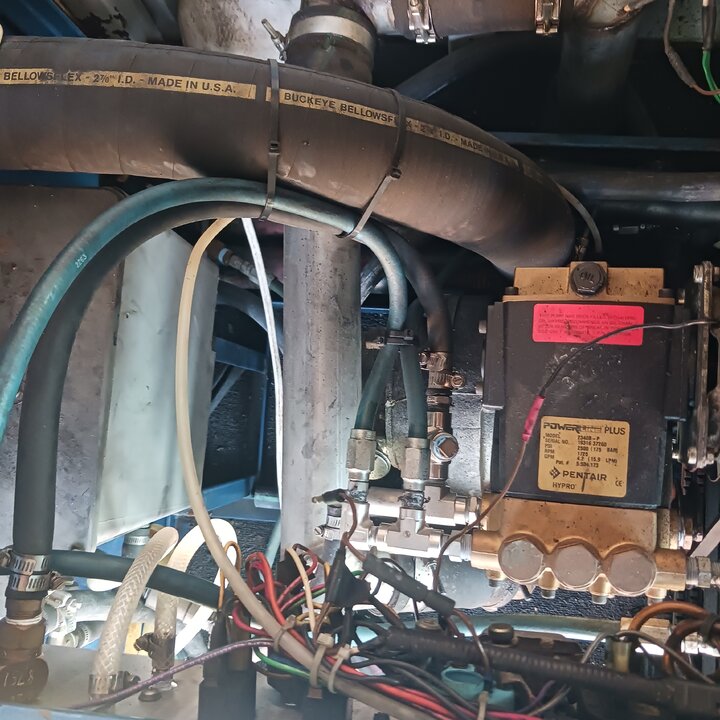

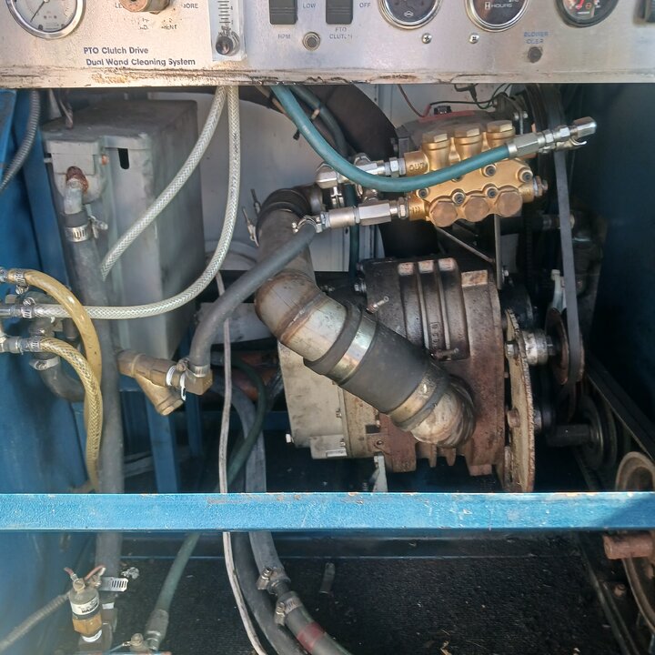

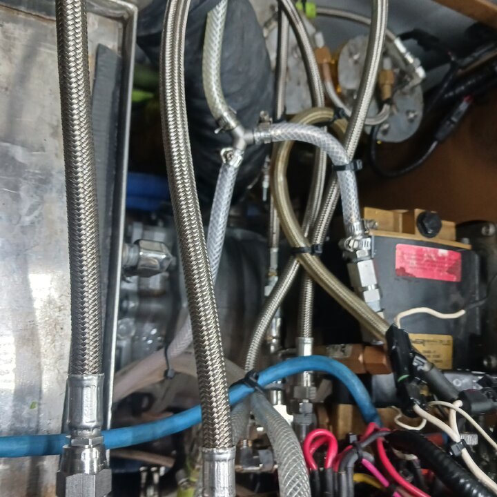

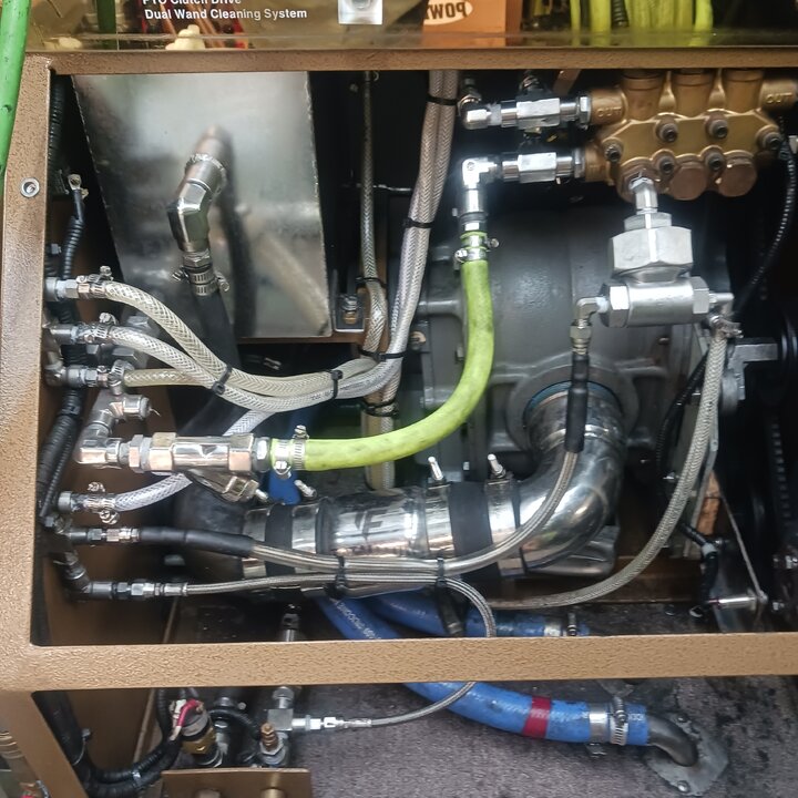

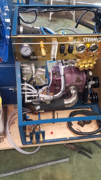

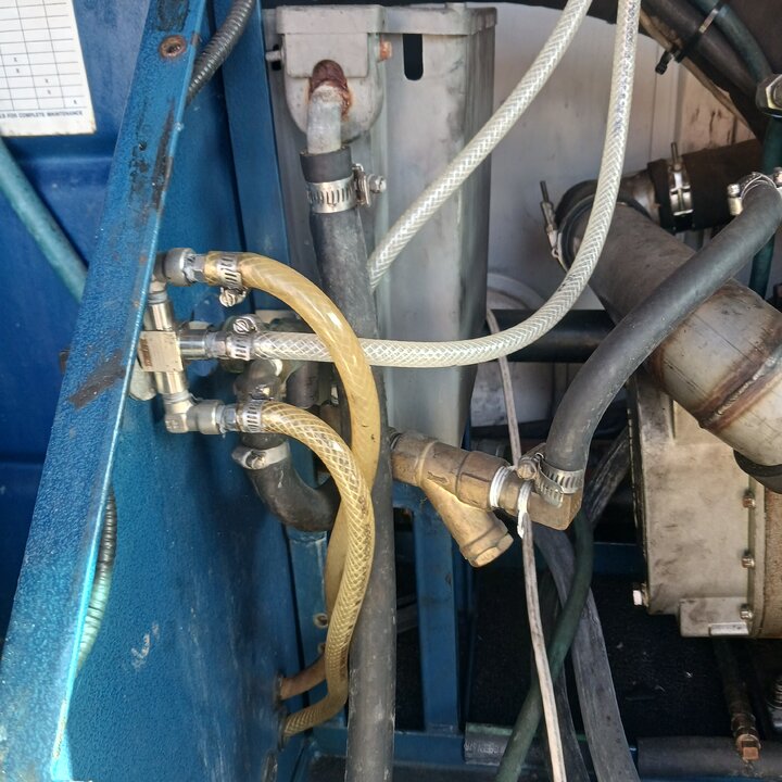

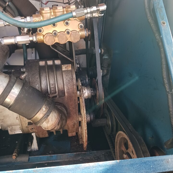

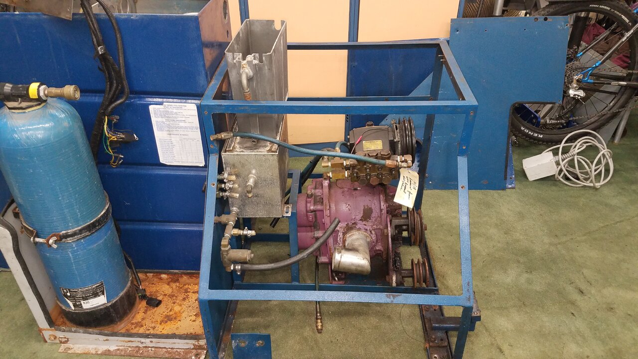

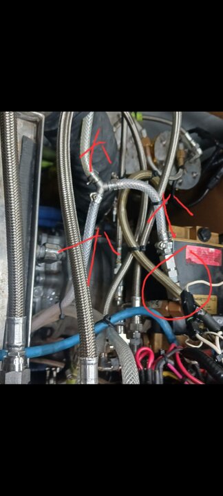

Heres what the insides of a "near original " steamgeni pto looks like the 3 hose valve on the left (red outlined) is chemical tank selector (not stock ) and white duplex wire is waste pump other than that its a stock 2000 steamgeni pto with 10,363 hours as simple as a powerful machine can get 3 belts 4 hoses a pump n a blower 3 tube and shell heat exchangers a lot of open space still in a 3×3 box tucked behind the drivers seat
View attachment 132463 View attachment 132464 View attachment 132465 View attachment 132466
Here's a side by side Frankenstein vs near original
20250906_173446.jpg 20221108_170827.jpg 20250906_173425.jpg 20241109_153921.jpg 20250906_173322.jpg 20250208_160041.jpg 20250906_173314.jpg 20250208_160041.jpg 20250906_173425.jpg

That's sweet Dwain. Thanks for the pics. I like simple!

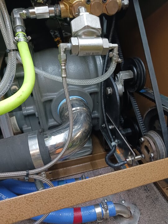

On another note my waste tank was filling up rapidly this past week. Like 4x as fast as normal. I ordered a new thermal relief valve as I am sure that is what has been causing it, frankly there is nowhere else that could be dumping tons of water into the waste tank. I put a ball valve at the top of the rubber hose coming off the thermal relief valve so I can keep operating for now...
Question, since the thermal relief valve is before both of my heat exchangers, is it just a fail safe in case my relief orifice heats the waterbox up too much thereby sending too hot of water to the pressure pump? How else could water ever go into the pump hotter than what the pump is rated to handle, something like 180 degrees? If the machine runs continually for several hours can the waterbox actually get that hot even when constantly mixing with cool incoming water from a garden hose or fresh water tank?

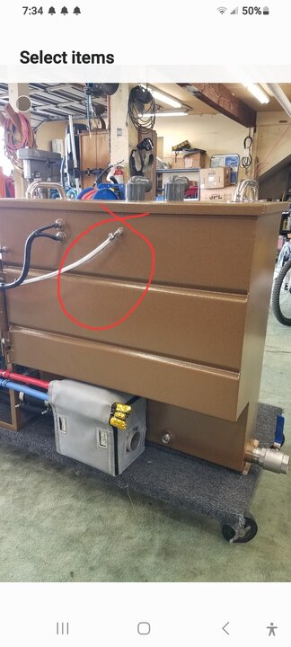

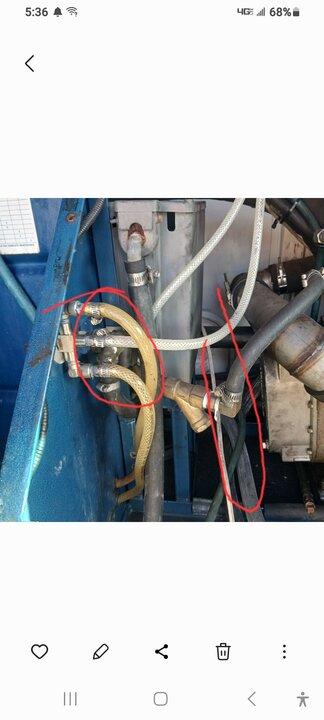

I installed a 140° thermal relief in frankinstien where the bypassed water reenters the pump the pump pumps cold water but when im not using it the bypass regulator recirculates back into the pumps inlet and as it's recirculating with each pass ot heats up so if or when it reaches 140° it dumps into the wastetank using the same hose y'd off from the chemical pump prime i also added a check valve to prevent air from entering thru the thermal relief in the pictures circled is the thermal relief (brass) with check valve( stainless connected to hose) lower left hose is chem pump discharge top is to waste tank

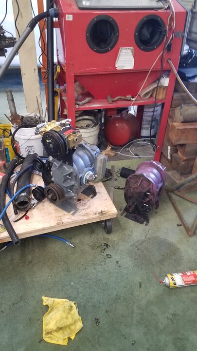

I over drived my blower inorder to reduce engine rpms my engine runs at 1230 rpms to get 3000 on the blower which gives me a shit load of vacuum by design. I have a 47 blower on a 50 gallon wastetank so with 75' of hose laying on the ground and the machine on high my guage reads 13 and the relief opens @ between 15&16 so it takes frankie no time to reach max vac. At high rpm and max vac my burn is 1.6 gph and around 11-13 mpg driving higher on the freeway . However frankinstien rarely sees a freeway closest one is over an hour away only engine choice i had was 4.3l v6 and 6.0 v8
My blower is a Tuthill 4007, not sure what I'd call that on the street. Is that 47? I read in the blower manual that it can handle over 3000 rpms, I wonder if these things are over drived from the factory setup or is my blower actually running at my engine rpm settings of 1300, 1400, amd 1500 rpms? It is powerful, more than I need. I keep it on low and medium almost all the time. I think my relief opens up at 13.5 hg, thats the highest my gauge reads when the vacuum is blocked off.
My blower is a roots 47 47 is the model stands for 4" gears 7" lobels its rated to run continuously @ 3600 rpms . Most companies that build machines don't run blower at max rpms for a couple of reasons #1 noise at 3600rpms my blower screams! #2 is heat i know that cleanco runs there blowers at 2900 to get more heat outa the blower heat exchanger so when setting mine up i went with their recommendations. My spare machine is simply set at engine rpm of 1350 steamgenis recommendations never bothered to check blower speed. (No blower heat exchanger on the spare). As far as maximum vacuum lift on your machine. I couldn't tell you all my experience is with sutorbilt and roots blowers. But a lobed blower is positive displacement and with no vacuum relief theoretically should continue sucking and pumping down till eighter something breaks, belts spin ,engine stalls or tank collapses . the vacuum relief is or should be set at manufacturers recommendations. Roots says 15 i set @16 im only 6.5% over and should be ok. My old 47 (retired 47 pink, used for mockup of frankinstien) originally came new in a 1991 steamgeni pto and is 34 years old. Used in 3 different machines before retired and has oner 17k hours on it running @ 16" lift. It still runs. It is shelfed as a spare, it started to have a slight knock and is the reason for retirement. If it weren't for that it woud have been rotated back to service in my spare machine replacing the sutorbilt 4m (roots 45 equivalent)
