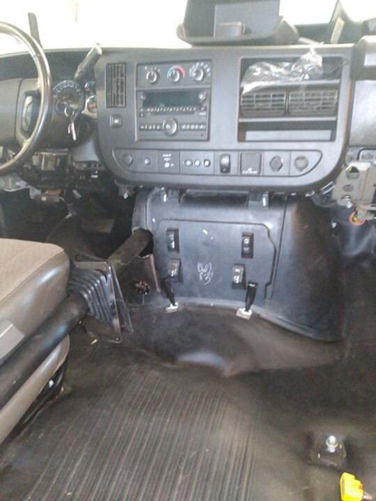

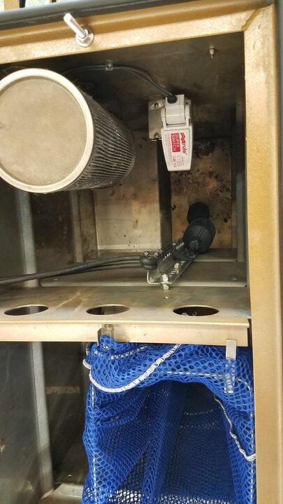

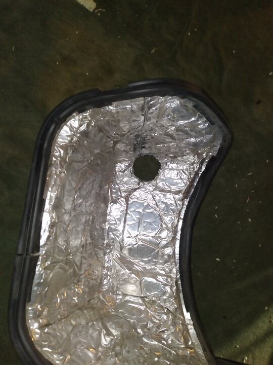

Design, for instance drive shaft, straight with inner and outer only 2 bearings easily rebuild no ujoints. Belts are adjusted with camed idler pulleys 2 cresent wrenches 1 bolt from start to finish less than 5 minutes ( including removing and installing covers)Wastetank/ solid stainless steel. Standard steamgeni uses starvation for chemical feed,no chemical pump and related parts (lines,valves,check valve etc.) Instead of a throttle controller steamgeni uses a somple solenoid( but only has high&idle). Acess front and top covers remove for complete access to all components. Its not that things don't wear out and need repairs. Its that everything is open and easily accessible. All machine components control panel, everything is in 1- 3'×3' box behind the drivers seat also when things need repaired or replaced, you can do it without standing on your head the difference between working on a steamgeni and working on yours is like the difference between changing spark plugs on a car built in the 70s vs. finding and changing plugs on one built today plus the added longevity of stainless construction. In short they are built to be repaired not replaced. Keep in mind when showing pictures of frankinstien ive added chemical pump, salsa heat, dual chemical tank valve dual wastepump float switches,throttle controller/ remote start/stop on machine and on the pressure pump. Blower Tachometer etc etc In short theres a lot more shit in the 3×3 box than a stock steamgeni, and still you can see and acess all components easily. I have a near stock one as a spare. Maybe this weekend if i have time ill pull the covers off and take some pics and put um side by side woth frankinstien. To show how much more simpler the stock ones are
View attachment 132436 View attachment 132438 View attachment 132439 View attachment 132440
That's cool Dwain-o. I really like the adjustable belts with the idler pulleys, and the simple driveshaft construction. I will challenge you on something though, I think this CDS 4.8 is even more accessible than your sexy Steam Genie. If we consider removing your panels on par (or close enough) with removing my driver and passenger seats, then it seems to me my layout is way more open and accessible as it is spread out across the space between the driver and passenger seats as well as about 20" or so behind each of those seats, like wide open, rather than stuffed in a box. I'll remove the seats and share some pics tomorrow.

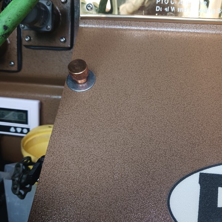

Not even close.top panel slides off (no screws and front of machine has giant thumb screws. I can open up my machine probably quicker than you can remove the fiberglass top between the seats. I can also if needed remove the drivers seat and pull the side cover there too if necessary. Ive only done that to replace blower front seal ( instead of removing the blower to do it)
