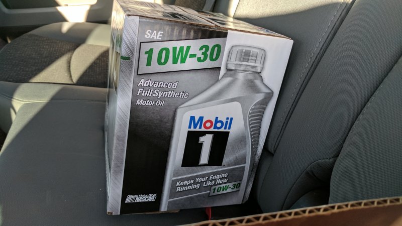

Royal Purple for the VATS
And this for the 370..
14,637
Where do you think I live?

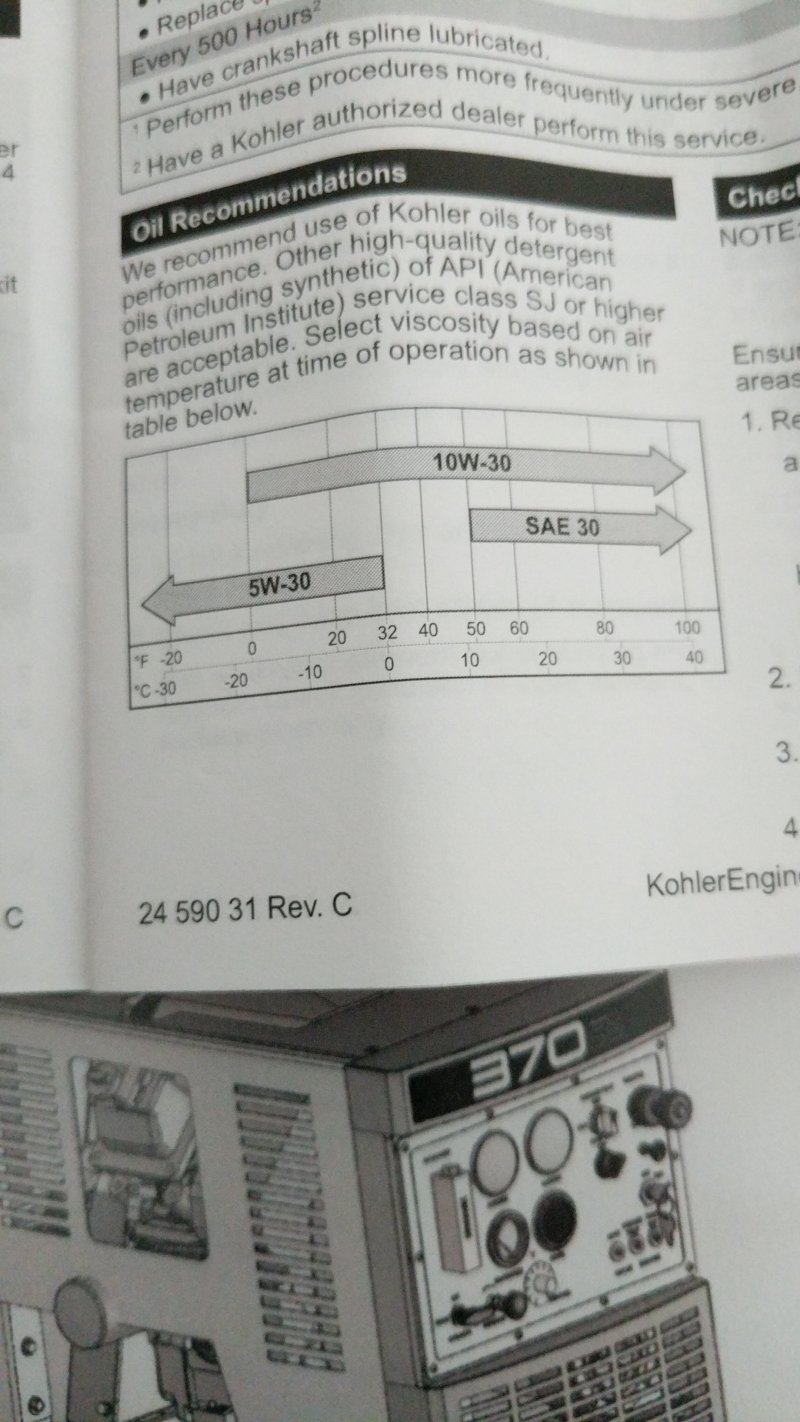

It's the same weight as the 10w30. I've read that it stays on the cylinder walls better for the cold cranks, which is the time when the engine suffers wear the most. Does the manual say to use 10w30 on the west coast?
117,332
The graph is all it gives me Matt
But I'm not on the coast, I'm on the east side of the Sierra at 4800 ft elevation. My working temps range from 15° to 105° through out the year, and on some occasions, the same day. :eekk:
