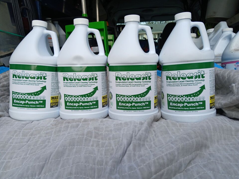

I'm getting excellent results using Releasit Hydrox and Encap Punch on Residential and my Apt Complex
I ordered two cases of Encap Punch but for the second time in 6 weeks Fed Ex damaged something I ordered so I only got one
Yes I know. Nobody cares

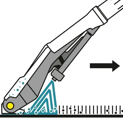

"The weight of the machine pushes the detergent with the dirt inside down and when it dries ( 1-2 hours ) it crystallizes. What don't you understand ???"
-I'm glad you're confessing your sins of pushing the dirt deeper in the carpet when you buff it
"Residential - A detergent is sprayed on carpet loosing dirt. CRB scrubs carpet breaking soil away from the carpet fibers into the detergent. When carpet dries the dirt is encapsulated in the detergent then crystallizes. UNDERSTAND ???"
-Yes I understand. I understand that the whole "all the dirt crystallizes for the customer to vacuum later" is a scam almost as bad as a pyramid scheme. Just remove the dirt. Don't come up with an excuse for not being able to remove it with a bonnet.
"HWE uses WATER PRESSURE that pushes dirt down ( COMMON SENSE ) but uses at least 5 times the amount of water. Takes 2-5 hours to dry ( if customer is lucky ) and has a TM and Van loaded with equipment worth $50,000 $$$$ outside blasting away, burning petroleum more $$$, and disturbing the neighbors. The dirt in the dirty water left behind after carpet dries settles at the bottom of the carpet with the powder from prespray and detergent."
-Now I see why you're attacking HWE. You were never trained the right way and you probably used an inferior wand that had terrible jet spray pattern that shot right down in the carpet vertically, not diagonally, which prevents the dirt from being pushed deeper. When sprayed diagonally, it improves the proper flushing so it can be extracted (not buffed deeper) properly. I'm thinking your wand didn't have a glide so the wand locked on the carpet, causing less extraction and leaving more water and soil behind and your body was wearing out from it, therefore causing you to switch completely to buffing carpet since your POS truckmount was wearing out and you couldn't afford a decent machine.
Look at the picture if pictures help with the diagonal jets . Sorry, I couldn't find a video showing how the water is extracted. You seem to be one of those guys that needs picture and video to comprehend

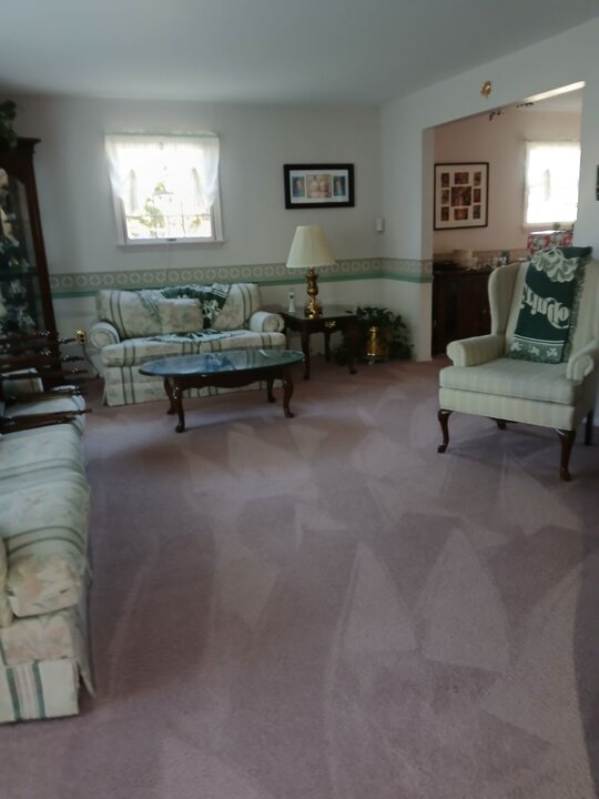

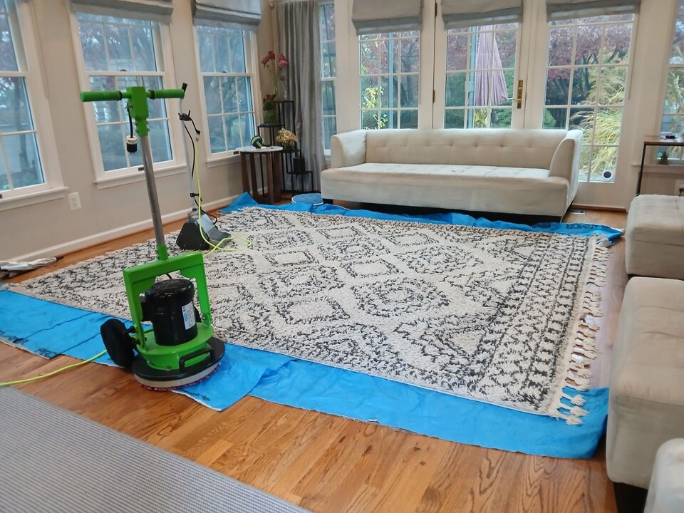

Can I add 4 oz of Odorcide Fresh Scent to Hydrox or Encap Punch and clean with. In one of your videos you say 1/2 or 1 oz can be added
I'm using Hydrox a lot lately at my Apt Complex, on Residential Carpet, on Furniture, and Area Rugs and getting excellent results
That Area Rug was trashed. Customer wanted to see if it could be saved. Yes it was saved with Hydrox using the VLM Method and dry in 1-2 Hours

The first thing you learn in an Odor Control Technician class is that the only real way to remove odor is to remove the source.
If you’ve got actual contamination in the carpet (urine, body oils, spills, etc.), you’re not removing the source by misting in some Odorcide and running a VLM pass. You’re just deodorizing what’s still there that hasn't been flushed out yet.
So yeah, you can add it, just be honest about what it’s doing. It’s not fixing odor problems, it’s just covering them up for a while.

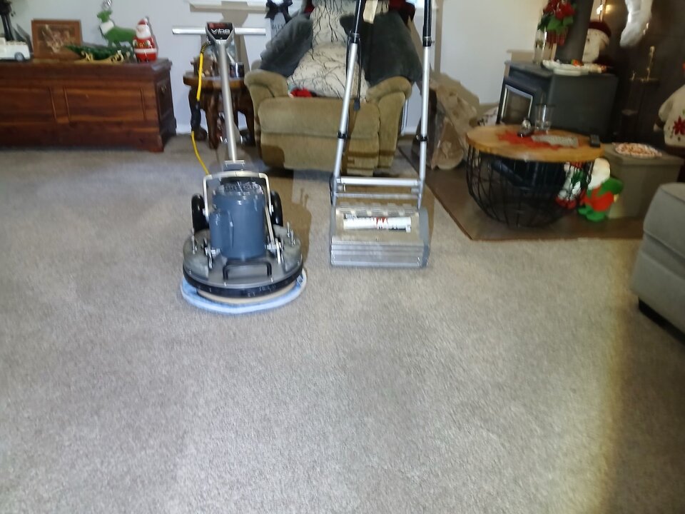

My feathers don't get ruffled
After 6 years of 100% VLM I'm very confident in the VLM Method
Hydrox on old Nylon
BEAUTIFUL !!!

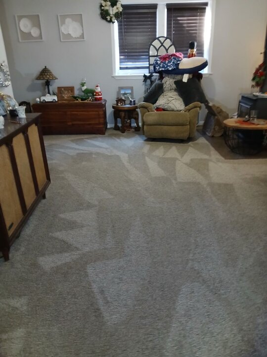

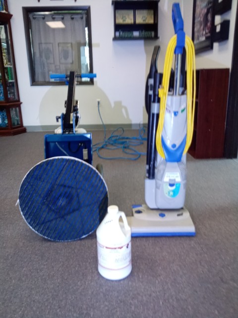

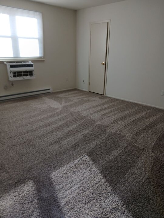

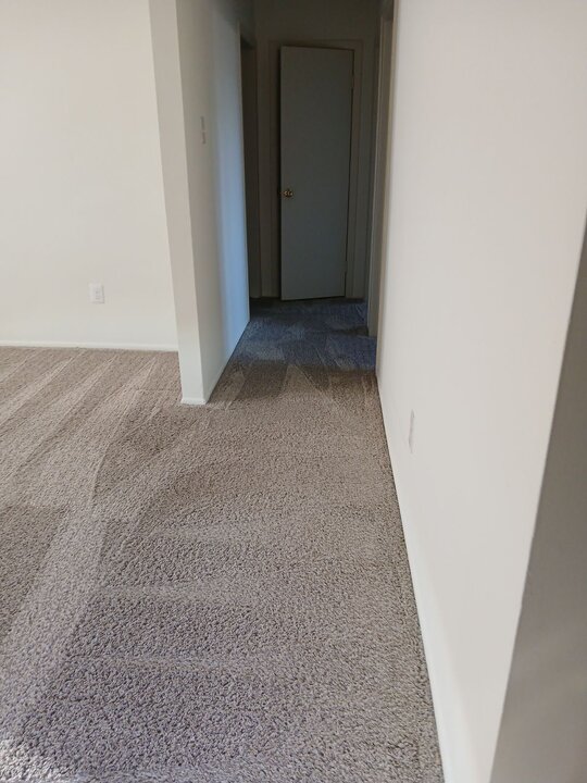

Hydrox is killing it at my Apt Complex
And it has low odor for Residential. Just a nice clean scent
I'm the last step in getting ready for new tenant but you can usually smell paint in those apartments
Fresh Scent Odorcide smells great and would add more to the clean scent and hopefully take away some of the paint smell
I love the Two Bedroom Apartments $$$

I'm not telling you not to do it in an apartment, but have you walked on carpet barefoot after cleaning with that product?

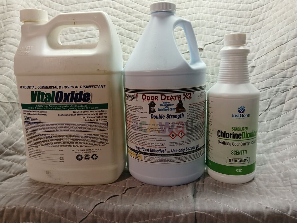

For pet urine and VLM Liquid Stabilized Chlorine Dioxide is a GAME CHANGER
It WORKS !!!
I have 3 Liquids Vital Oxide, VacAway Lemon Odor Death x2, Just Gone. Vital Oxide is CRI Approved
This was a new customer from back in August. She has a old dog 14 years old that she loves so she puts up with the pet stains and odor
Did this again yesterday. She said the first time I cleaned it she was satisfied so she wants to do it every 3 months
Spray down Just Gone heavy first and then thoroughly scrub with CRB with Grey Brushes
Then spray down VacAway Double Trouble and scrub with CRB with Grey Brushes
Thoroughly extract changing bonnets often with Tankless Vibe and 3 weights on each side for better absorption and thick Light Blue Microfiber Bonnets
3 weights adds 24 pounds of head weight
I put my head down to the carpet after cleaning and I couldn't smell anything
There was pet stains near chair that I couldn't see without my Head light, that disappeared after spraying down Just Gone. I wear a Light on my head that shows up everything
I told her the TRUTH about urine in backing and padding and the only way to remove 100% of the pet urine and odor is to replace but this will help the situation. She understands
I also cleaned a Sofa and Loveseat that was trashed from her 2 dogs laying on them

But, but, you do know that carpet is crunchy, not soft once it crystallizes
the way it's supposed to🤷🏼‍♂️ What do you do about that?
