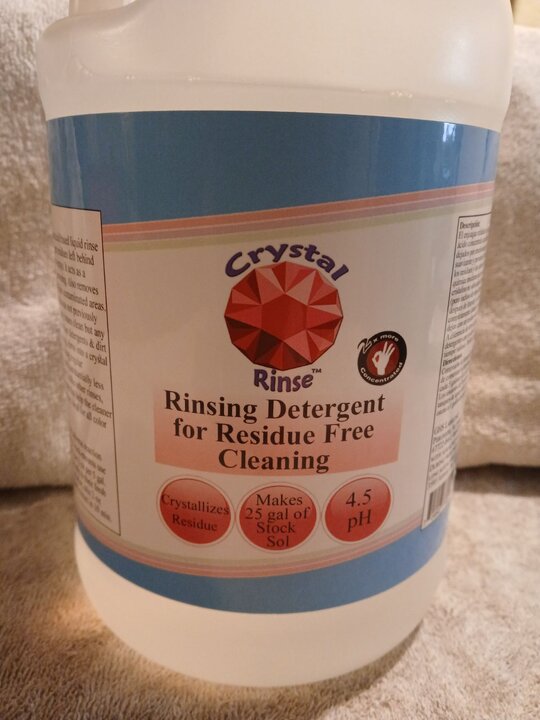

I have Magic Wands Crystal Rinse that I have used for many years
I use it a few times a year to flush out bad stains and pet stains with my portable
I won't know until I get there and see for myself what the odor is
This is going to be a PP 5000 UV Light searching for urine job
She said no visible pet stains
