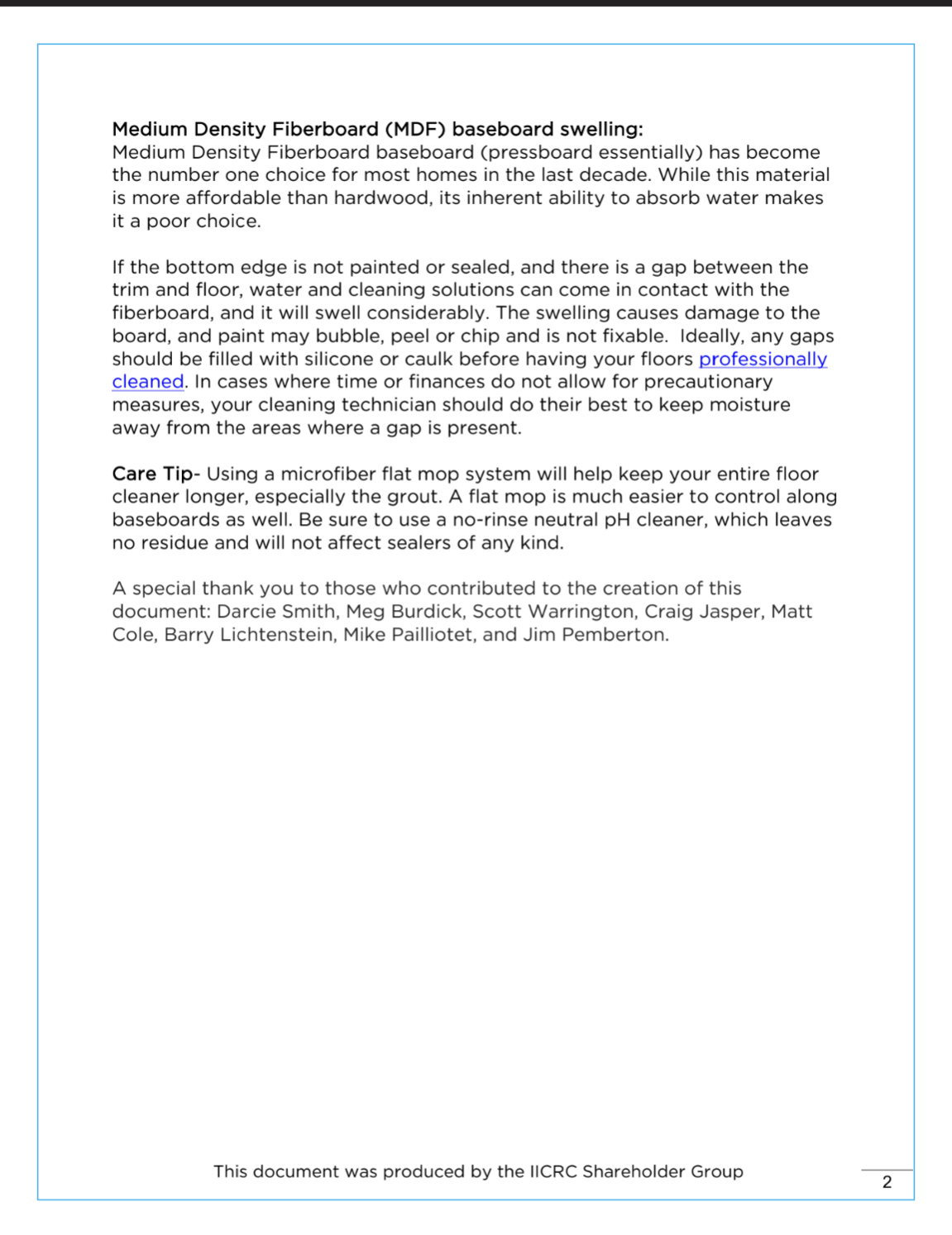

good info

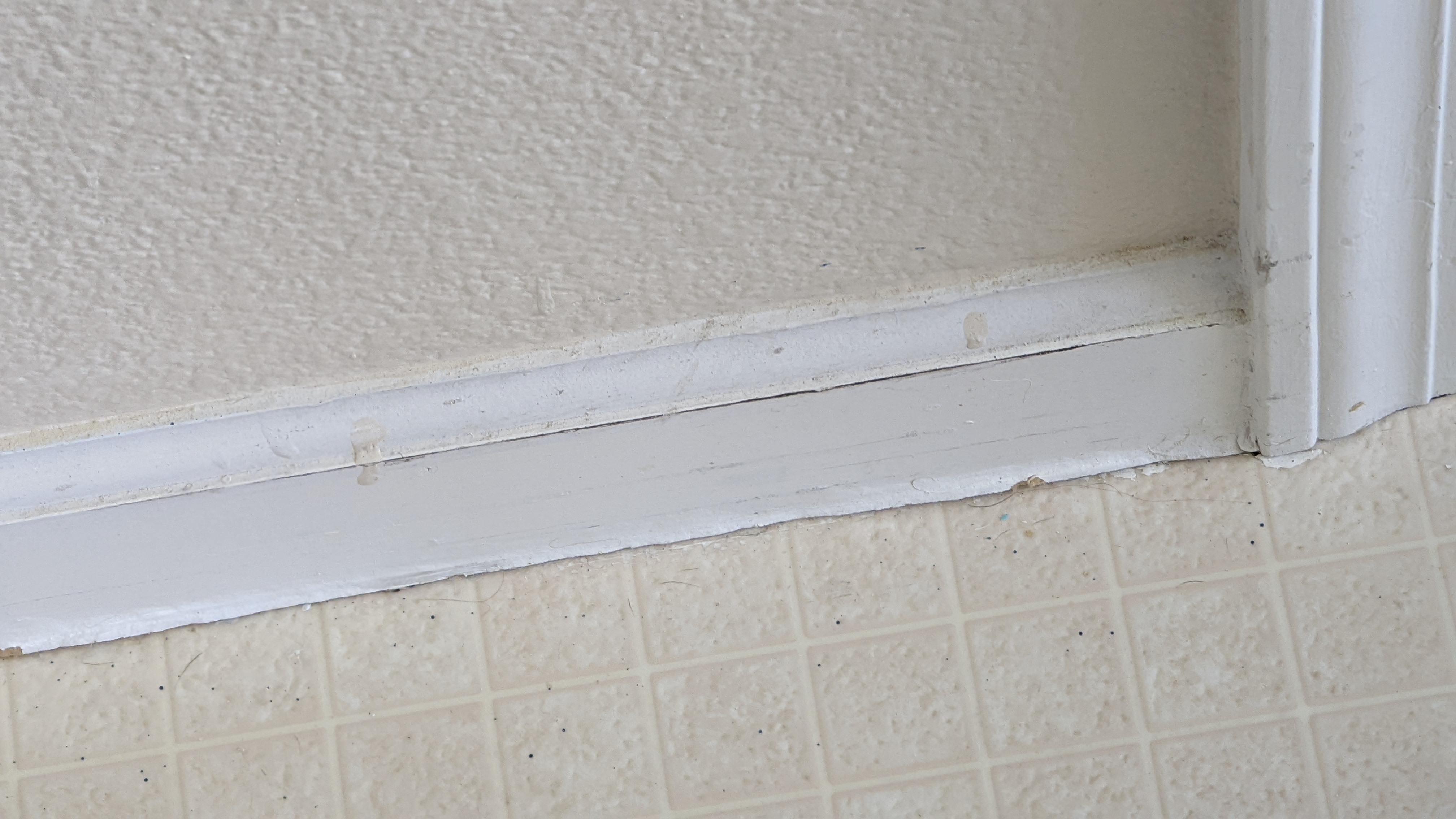

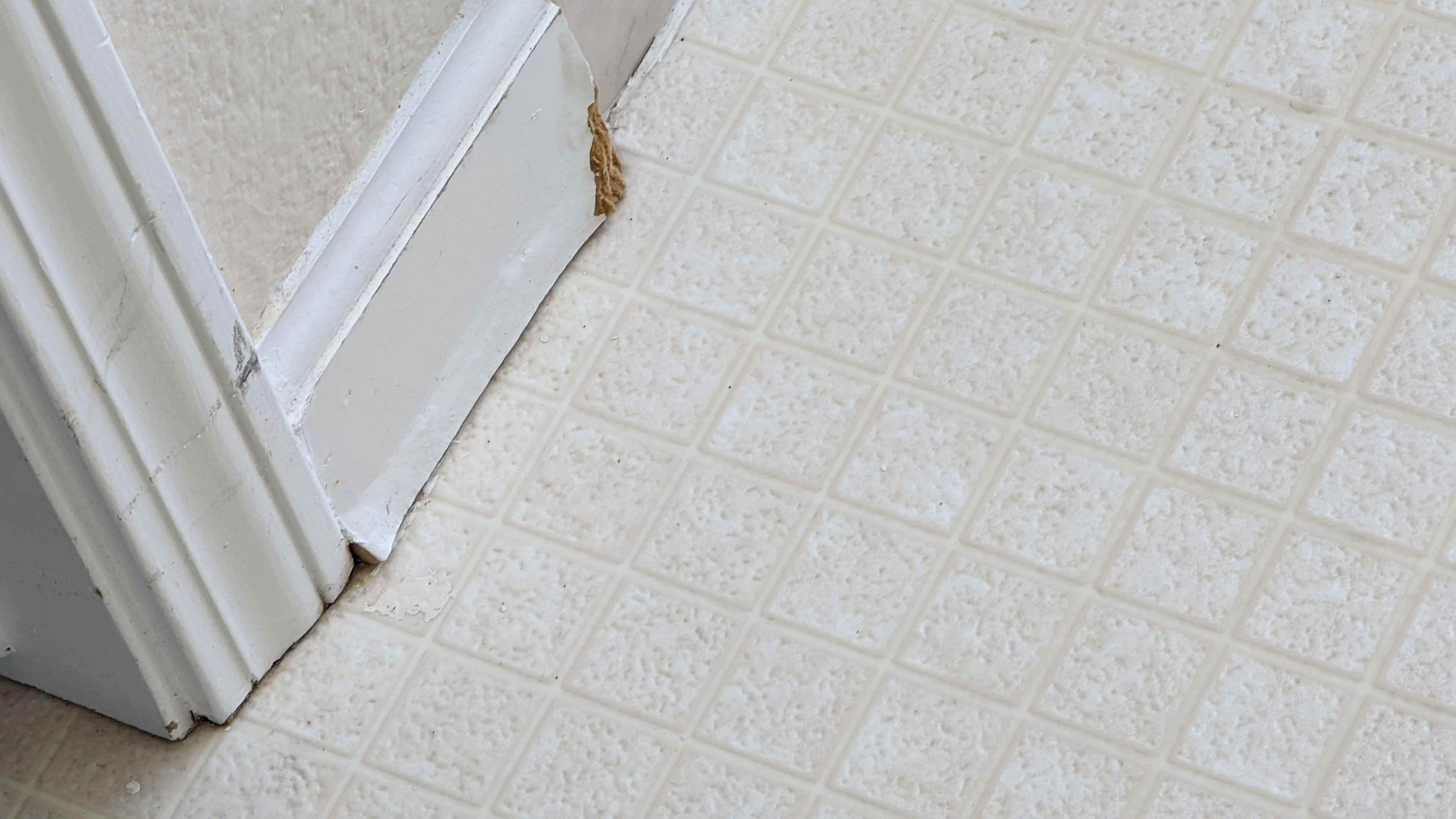

but that pic wasn't caused by a turbo regardless of what your customer says or when they say they noticed. I'm sure you've had plenty of customers notice things after a cleaning that were obviously there before. That is clearly a wet environment where MDF shouldn't be used in the first place and has had repeated exposure.
