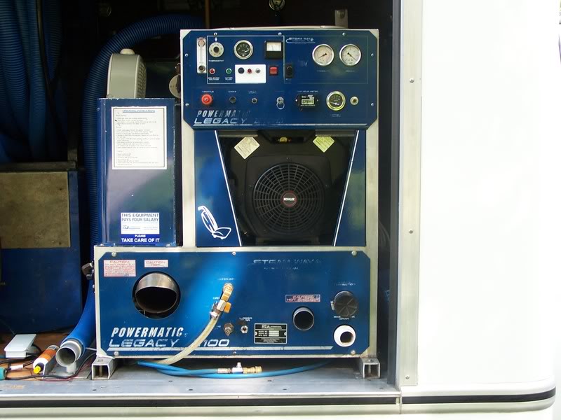

I have the opportunity to get one with 53 hours on it. Possibly even barter/clean for it.
The foot print is pretty big on these so what sized trailer would work with some room left over for a 175, hoses and what not?
Will my Chevy 1500 Silverado 2WD have a problem towing the weight?
I'm guessing a can of Kero and a can of gas can be safely mounted inside right?

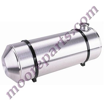

Mounting the tanks on the tongue is the way we do it here. We use Spun Aluminum tanks. A little welding and they mount up easy.

Marine Tank? These are what we use

Loren
117,379
They want 6 grand for it :shock:
Half of which they are willing to barter hallway cleanings for. :shock: :shock:
Overkill for a back up that may get used 4 times a year but when I'm ready to get another van on the road it will be ready.

going by memory, the unit weighs 930 pounds empty.
foot print is 35" x 60"
you won't need a big trailer.
You will need one that can carry some weight.
I'd suggest a minimum of 3000 pound payload capacity.
Your pick-up will handle that.
