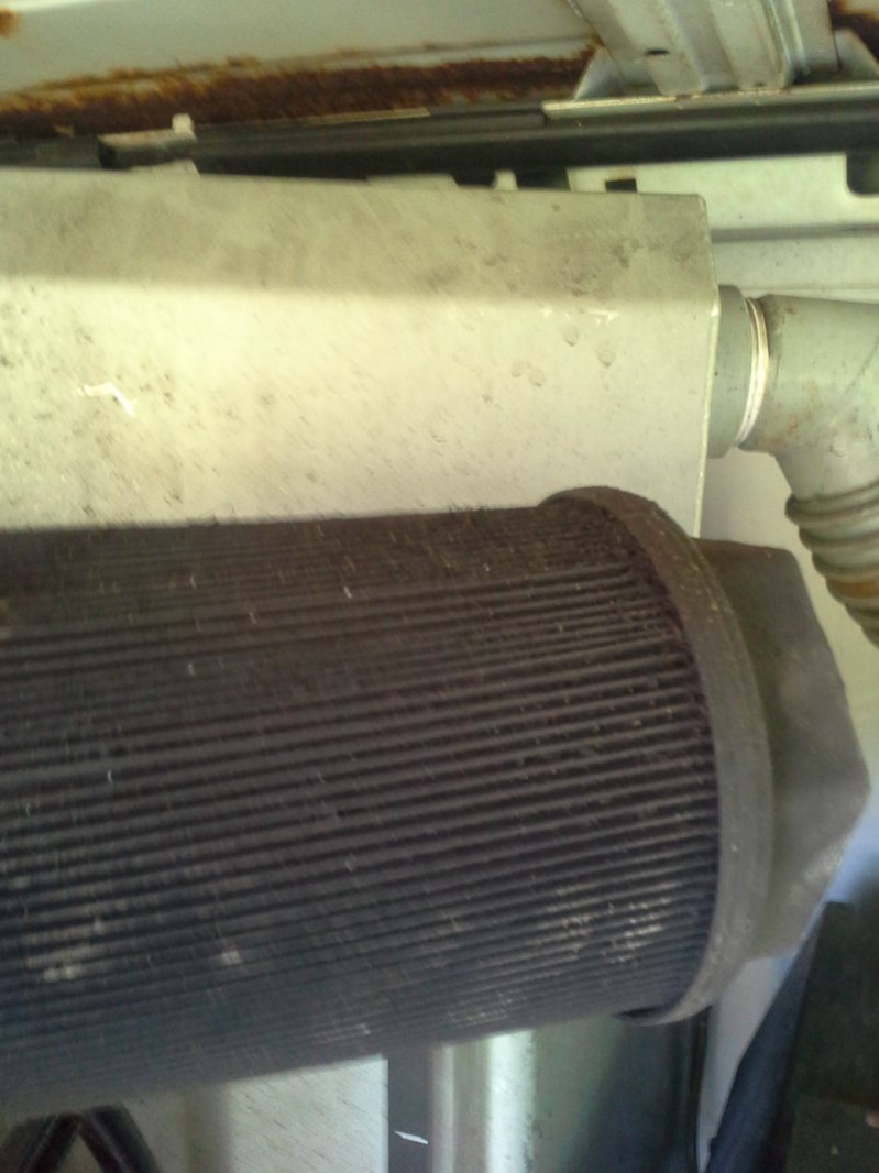

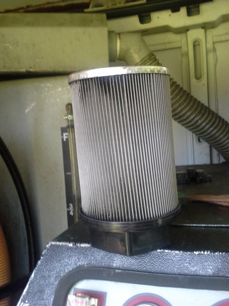

Vacuum filter need scrubbing with a brush, new foam seal on the lid my 405 is amazing again.
I thought my problem was leaky hose cuffs.
Like Lee said something could be blocking a elbow take a garden hose push it in the recovery tank side towards hose hook up if it's blocked you'll hit something.
Never...NEVER...scrub yor filter....run water from inside out at pressure...
