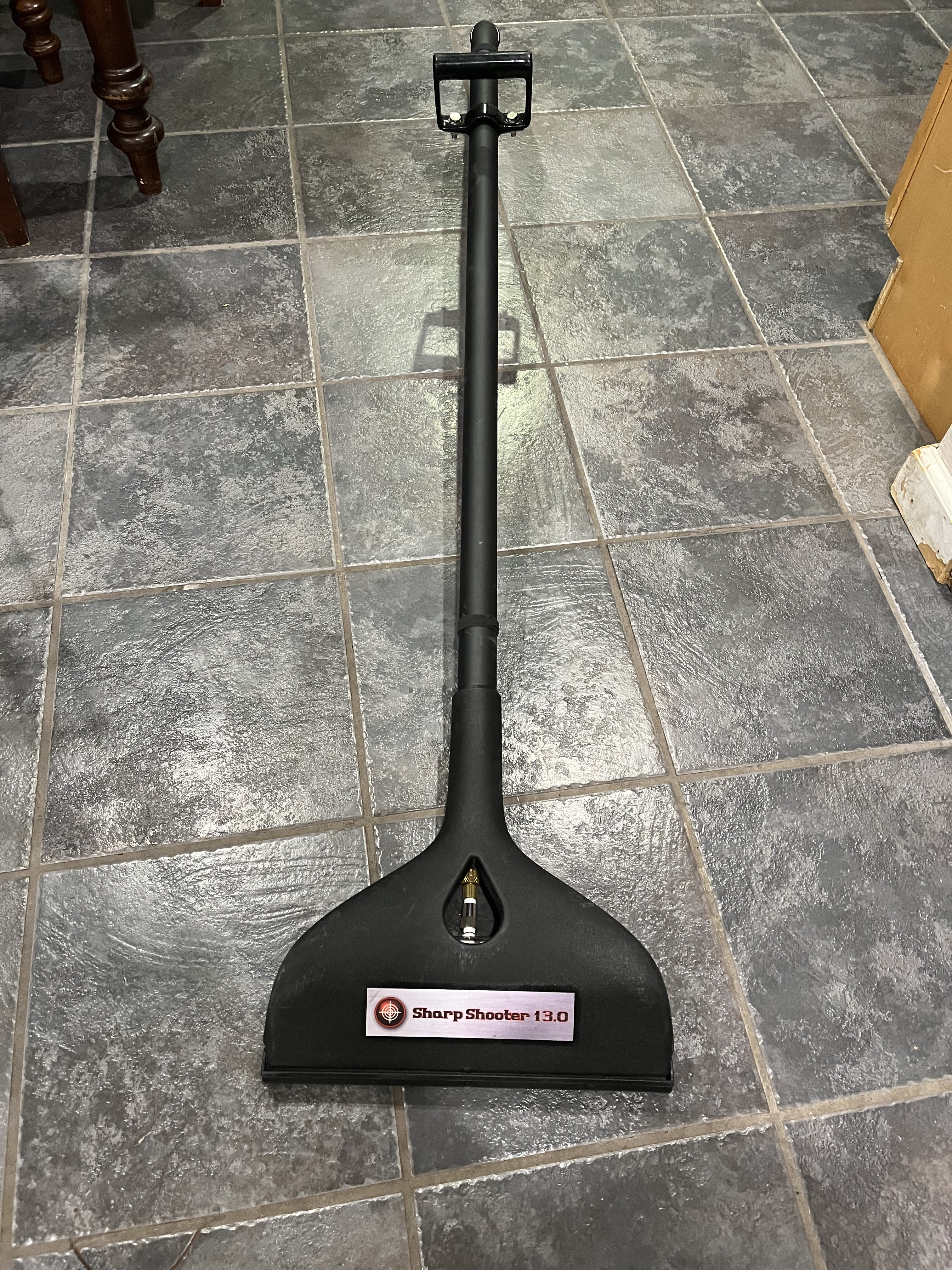

lots of requests for a GGlide for that wand.The unit I have came with a sharp shooter 2 jet wand. Same shit as the evolution wand with a split in the middle of the head.
You know it. And it’s been used once and is already curving. Same thing happened to my 16 inch evolution when I had it.lots of requests for a GGlide for that wand.
Im guessing they used the same triangulated Delrin glide as the HM stairtool, right?

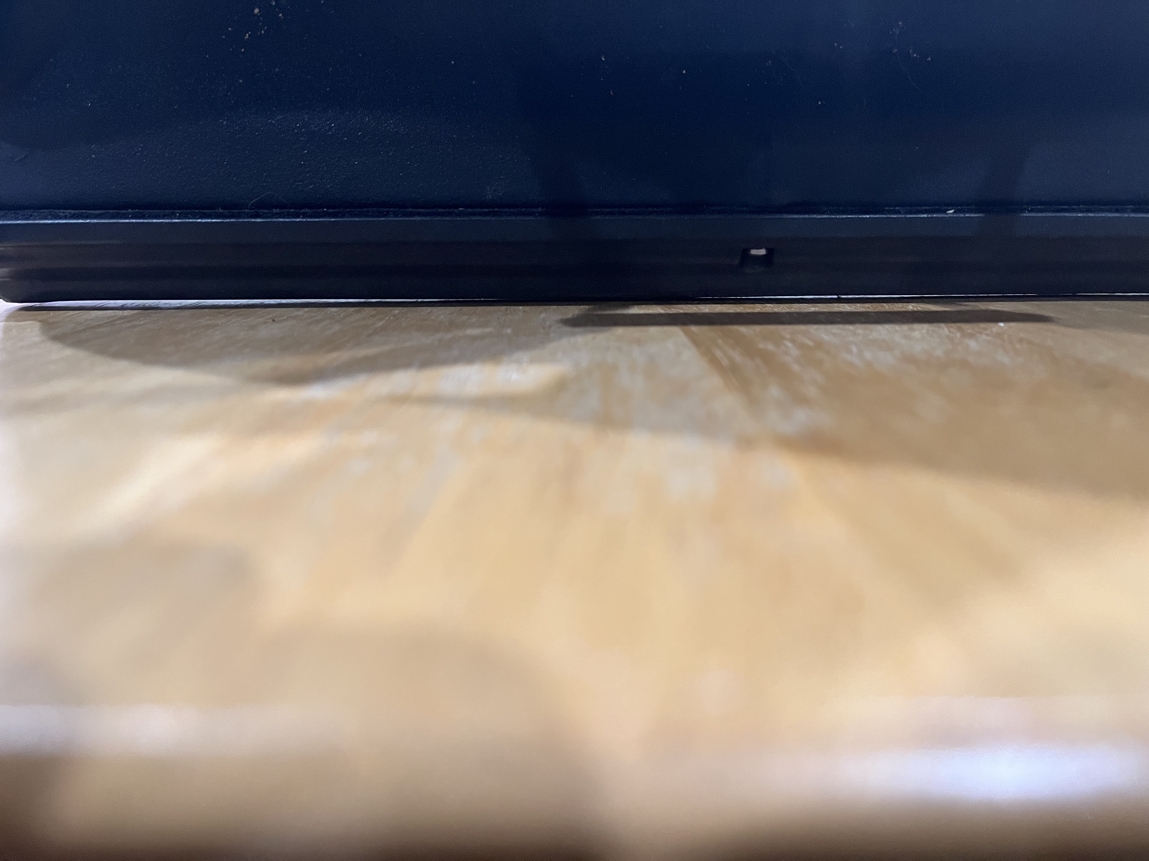

Bowing in which direction?You know it. And it’s been used once and is already curving. Same thing happened to my 16 inch evolution when I had it.
In a U shape. When I put it on a flat surface the corners are not flush to the table.Bowing in which direction?

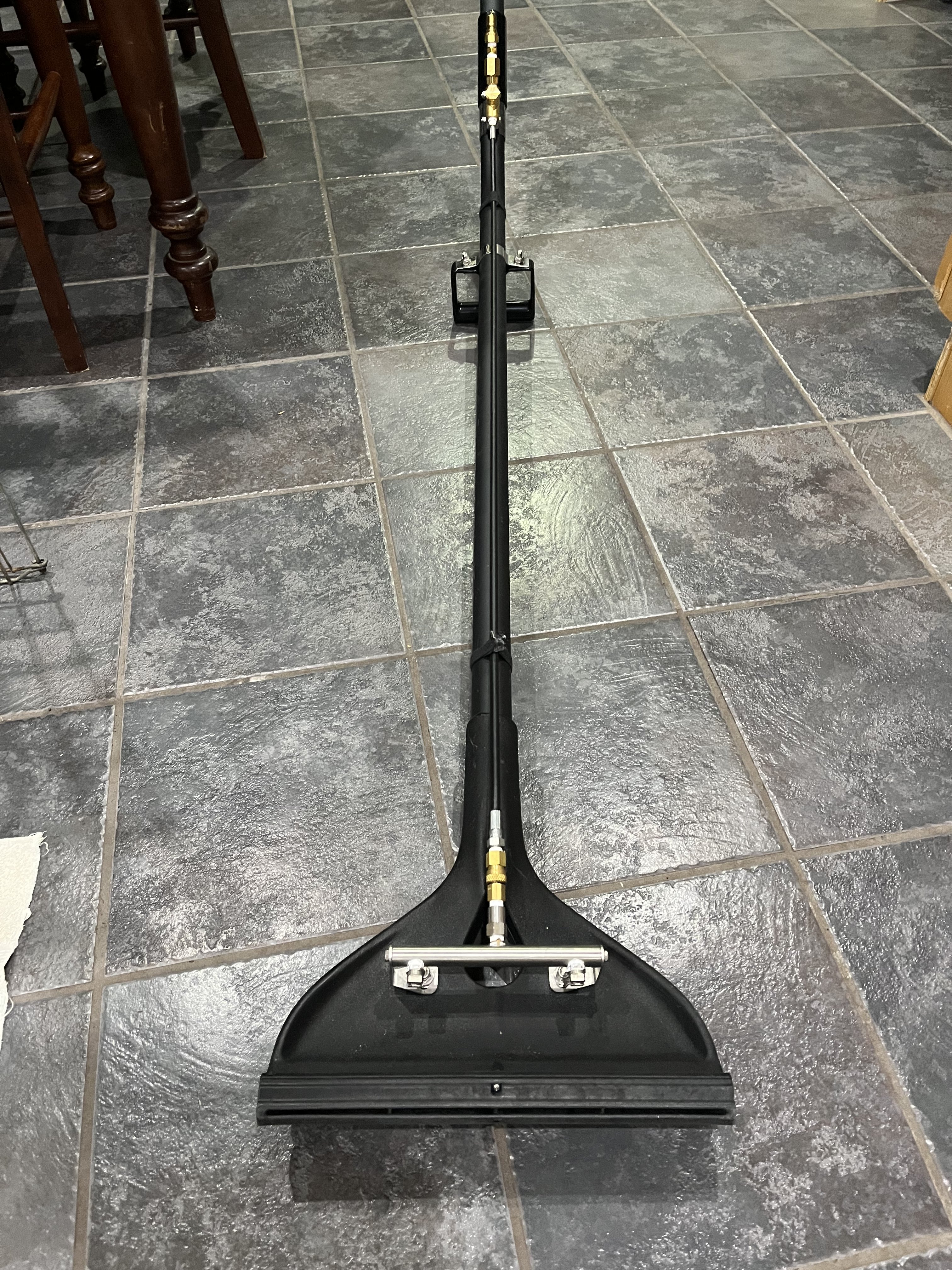

Yes there is foam behind the glide. Here are some pictures of the wand. Tried to show what I could on a flat surface. It won’t make much difference in plush carpet but as it gets used will now more.foam gasket on the back side?
View attachment 111948 View attachment 111949 View attachment 111950
