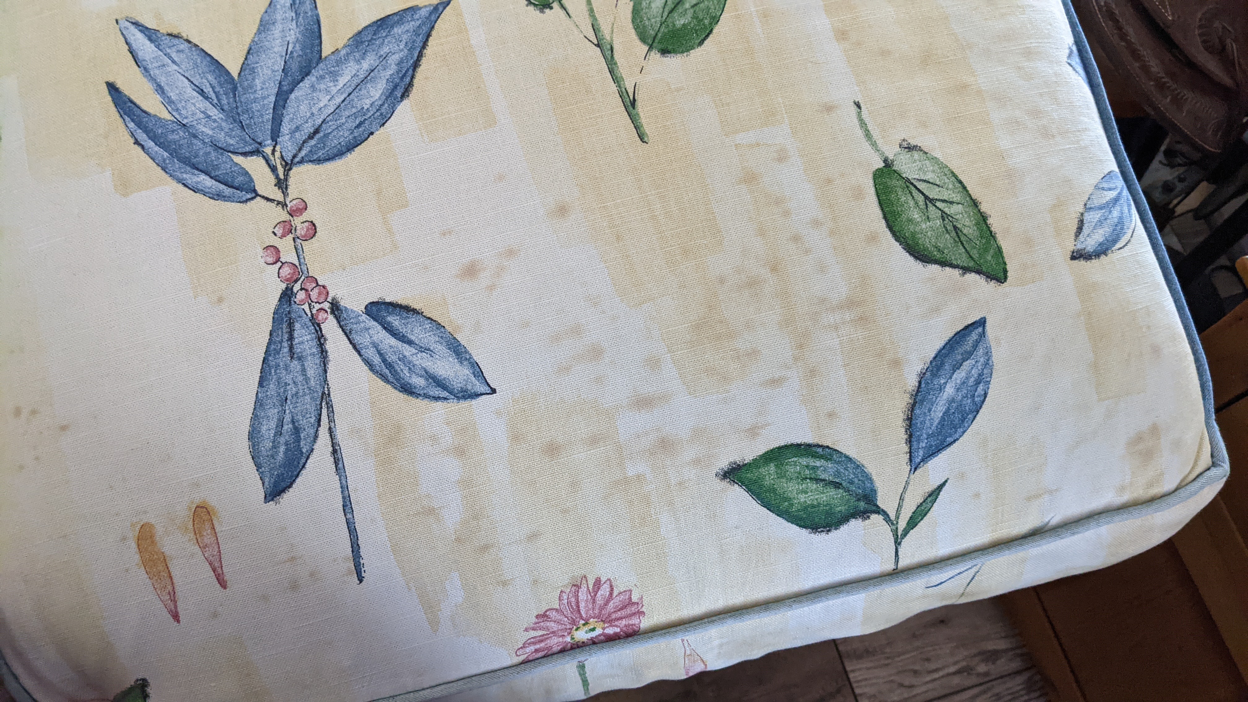

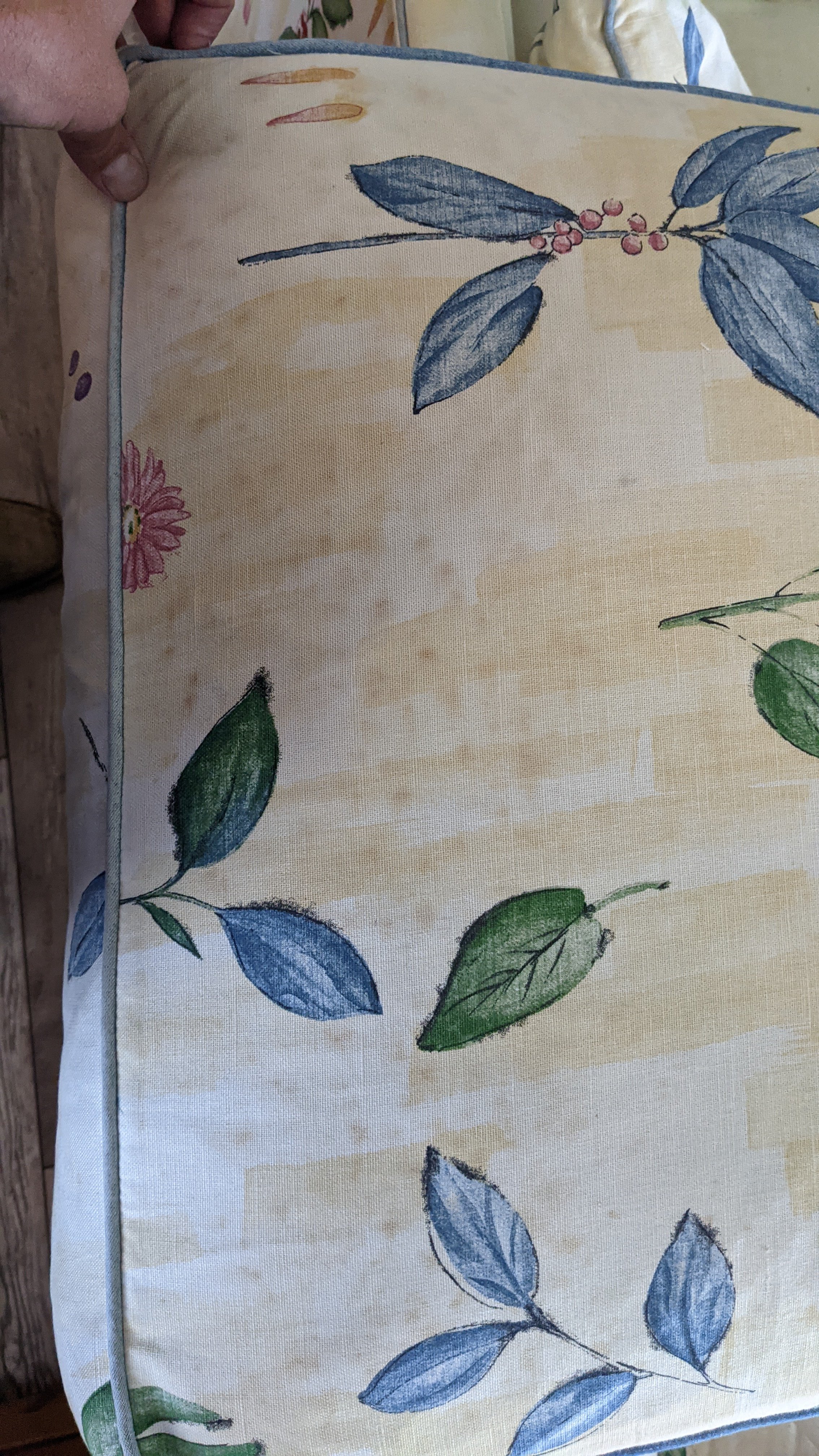

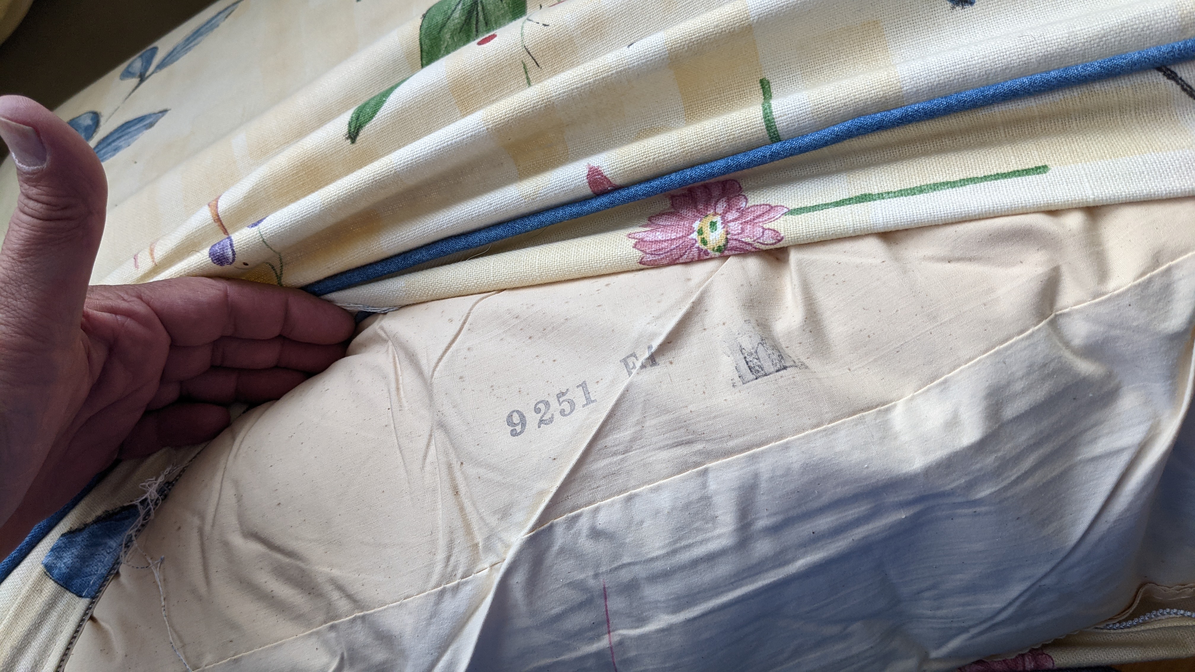

The spots have the appearance of flame resistant treatments, and both upholsterers and manufacturers have been known to use flame retardent ticking even if not required.
But those long parallel brown streaks scream "somebody tried to clean it".
So one or the other or both.
You were, of course, wise to not do it.
Did you ask them if it was sprayed with protector? Is it possible they applied a water base protectant on their own?
fire retardant treatment is my guess. Like Fred said, I first thought it was Haitian cotton seeds but if it's poly, then I would go with the retardant, especially if its from the 80's or 90's
28,275
somebody cleaned it. That's mainly cellulosic browning. Fred could be right about those dots though.

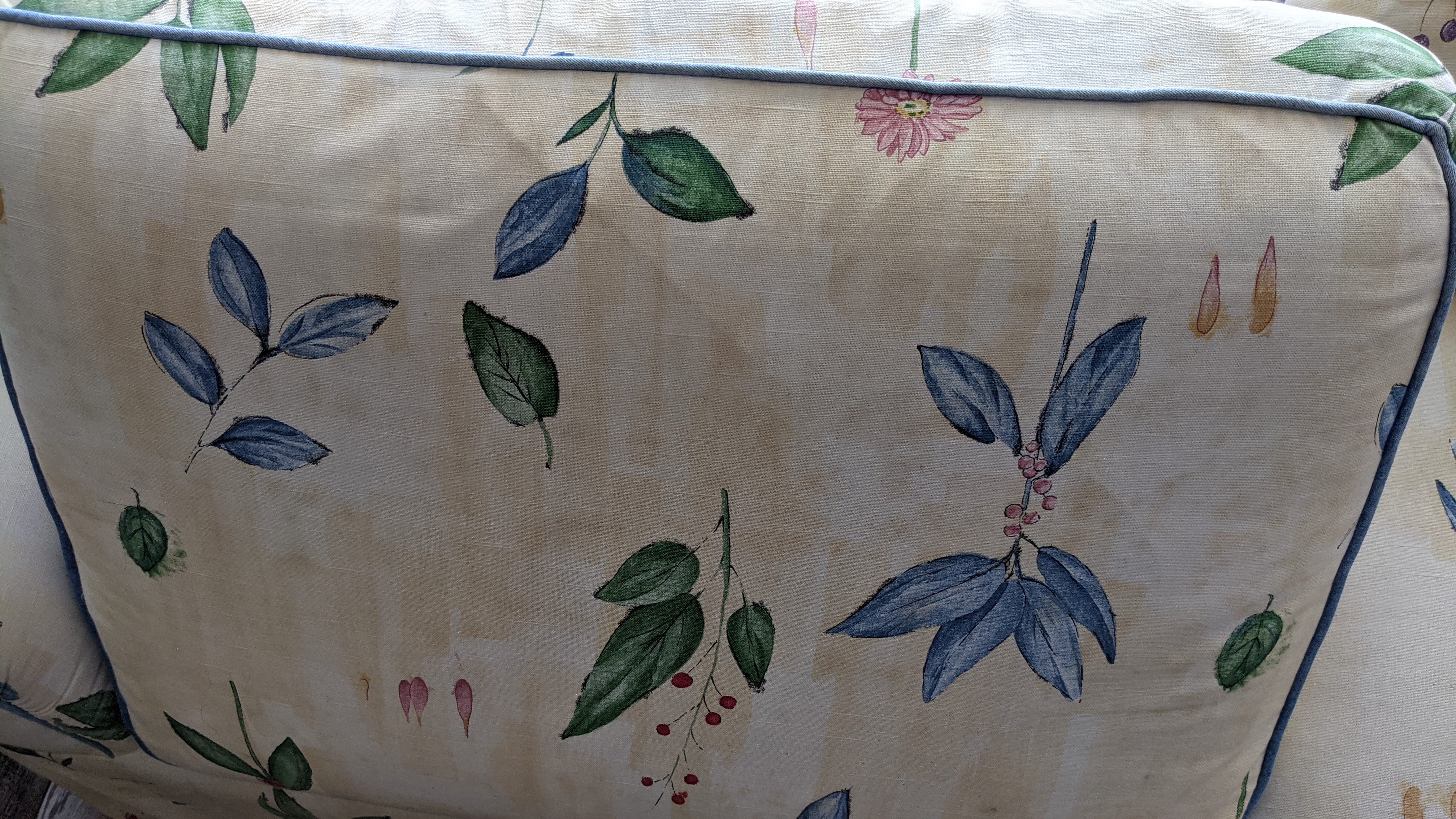

I having the same issues. It didnt happen on the cushions, which i test cleaned 1st. But the frame is having those same spots what wick up.
Im thinking its unfinished cotton in the padding and its the seeds- or the cotton was fire retarded-- but the fabric is poly.
