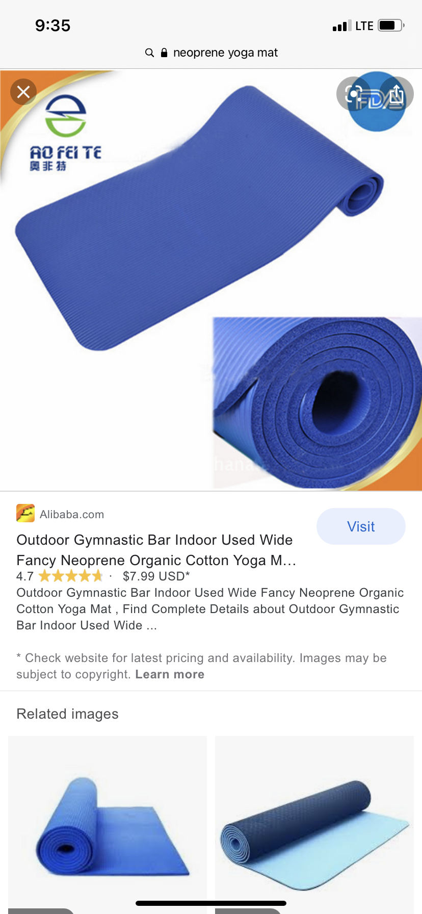

Go get a neoprene yoga mat....

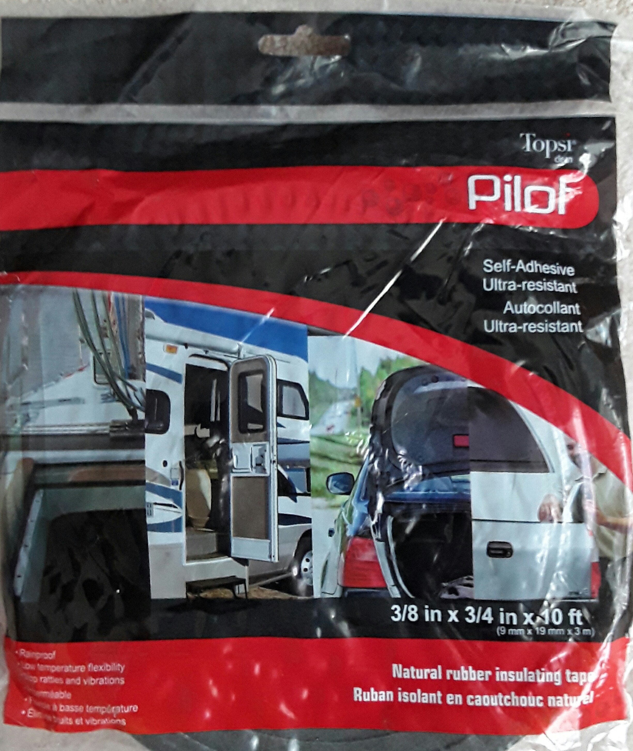

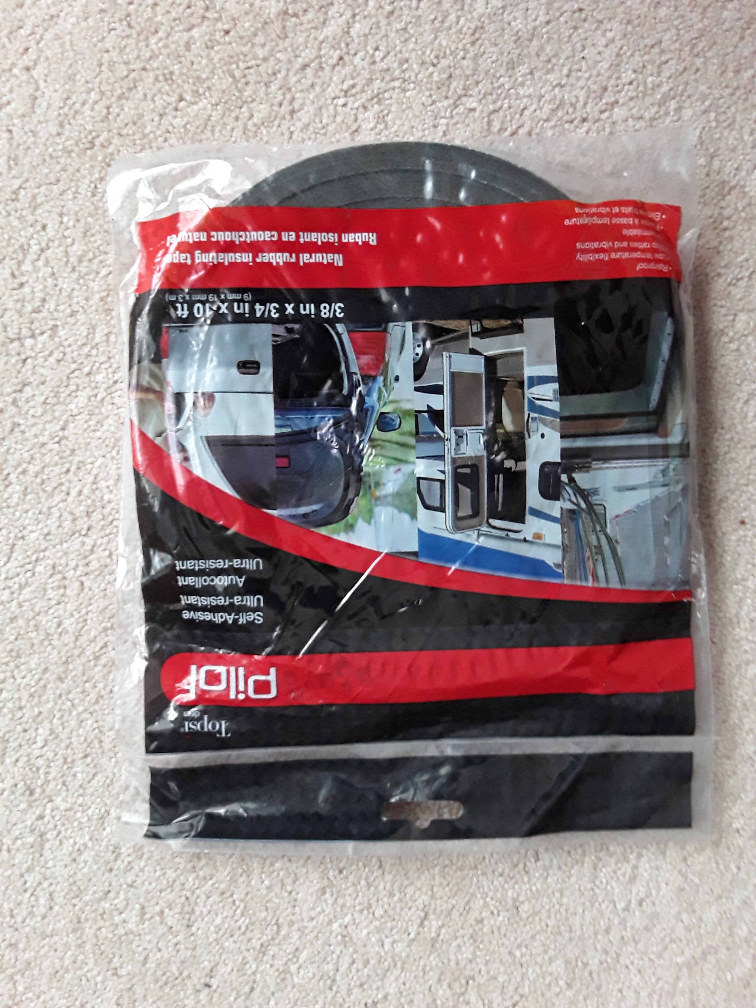

I've used the same type of weather stripping that you put on your truck when installing a canopy. 3/4 to 1 inch wide, self adhesive. Just have to make sure the tank lid is clean and dry before applying. It will eventually fail but should give you a couple of years, then just replace it.

After being ripped off by one of my suppliers, who led me to purchase some overpriced closed cell foam stripping along with a $50.00 tube of sealant, which was totally inadequate R&R, i purchased this product.
100% satisfaction and a breeze to install.

Just glue the Yoga Mat on and then trim it after it dries?
Actually, I took off the waste tank lid, and the blower lid. I scrapped off the old stuff, cleaned the heck out of it, then cleaned it again with a solvent. Once it’s COMPLETELY DRY, I then took measurements of the interior of both lids. I used a sharpie, a yard stick, and traced it out for both. I then lay the mat on a piece of plywood, use the yard stick as a guide, and cut it with a new snap blade. The width was around an inch and a 1/2....
I then dry fit it, once satisfied, I then applied the carpet tape, and then the new gasket....
Did the same for both....
Oh, I then used a hair dryer to get the new gasket nice and warm, to help the bond between the tape and gasket....
This was 4 years ago, and it has yet to tear, or delam...
This is how I did mine anyway, I’m sure there are other good solutions, BUT, by going this route, I still have enough material left over to do 2 more....
Best part is, it cost me around 20$ for materials....

I've taken the long, complicated route also. Nothing beats the simplicity, durability and cost of buying a ready to use gasket material described in my above posting.
