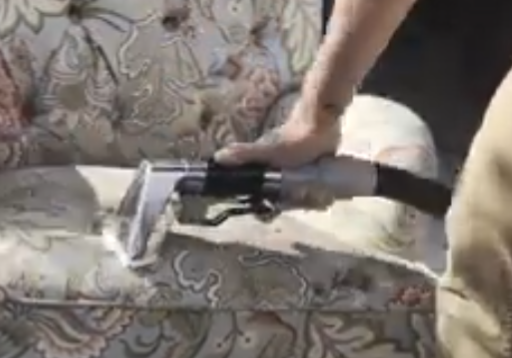

While China prepares to make my first titanium beta head, Ive been cleaning lots of upholstery with the steel mock up
It really is a very nice tool to clean with, in just about every way, especially once you learn it, as all tools need doing
The two items we need to address with the Glide will have to wait until I get the TI version as the end opening will be different and we need to make sure Glide can be taken off and on easily, as this action will happen a lot due to how well it works with out the glide on certain tasks
Patience is a virtue, that I've gotten better at but am far from perfect.

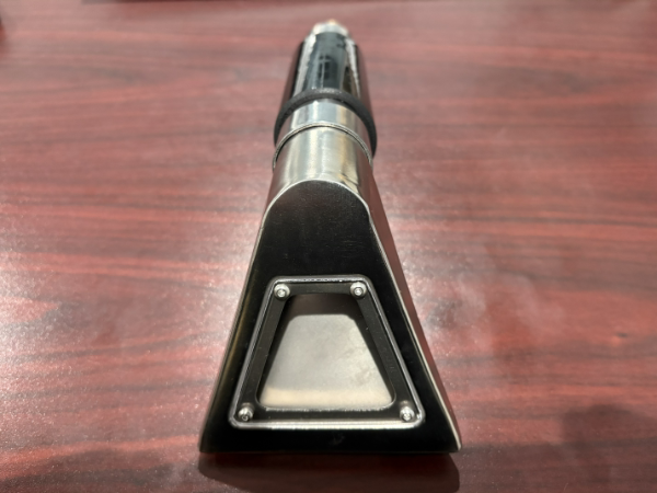

the 2nd Beta round is happening
Titanium
Internal plumbing
Window
Glide is being tweaked to last plenty of on/off cycles.
We'll have a functioning unit or two at the Cleaning Business Expo at the end of January in Vegas, which Tom Cermak and I will be doing demos with

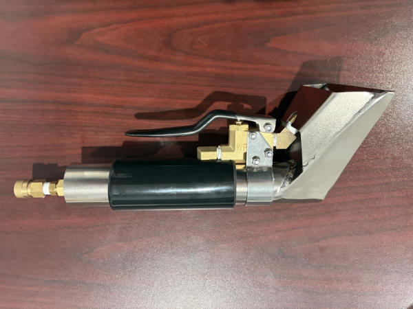

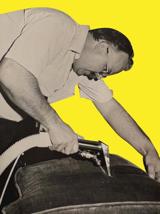

A while back I felt the need to call this tool the "GreenGlide's Jubilee" upholstery tool.
When Jim sent me this photo yesterday I realized I misspelled it
JubiLee is now official.
I have that exact tool I went home with after one of Jim's classes.
After I retired and sold off all my kleenrite, prochem, sapphire and various other tools I kept that one for my personal use.
It's not "exact"
Yours does not have evacuation ports between the two chambers or internal plumbing, or a window or the lightweight of titanium, or my Glide..
But even without all that it's still a good tool

Not yours. The one in Lee's photo.

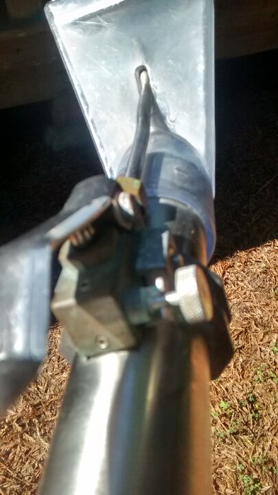

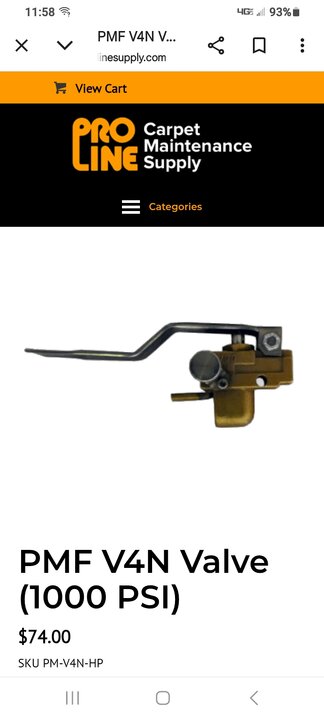

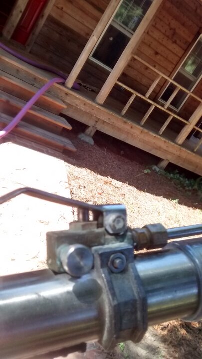

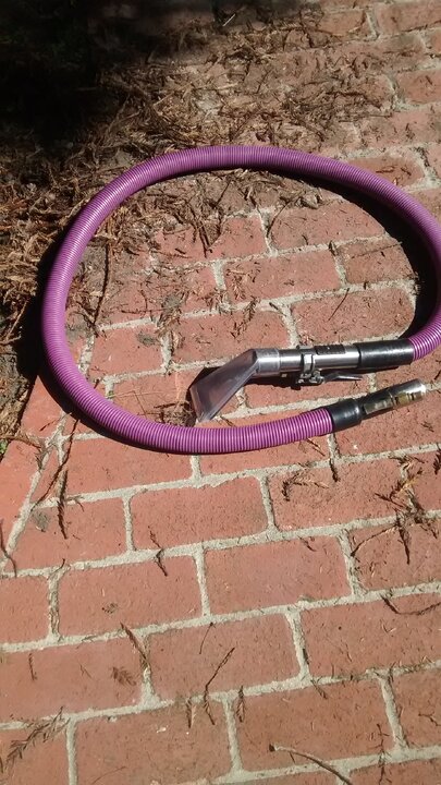

Too bad it doesn't have this valve, i really don't care for this tool. And only use it on the rare occasions that i have to do an auto or rv interior. What i really really really love about it is that it has an continuous adjustable bypass. It keep the solution super hot all the way up to the valve itself .
The stainless needle valve on the side manually controls how much solution if any is bypassed
