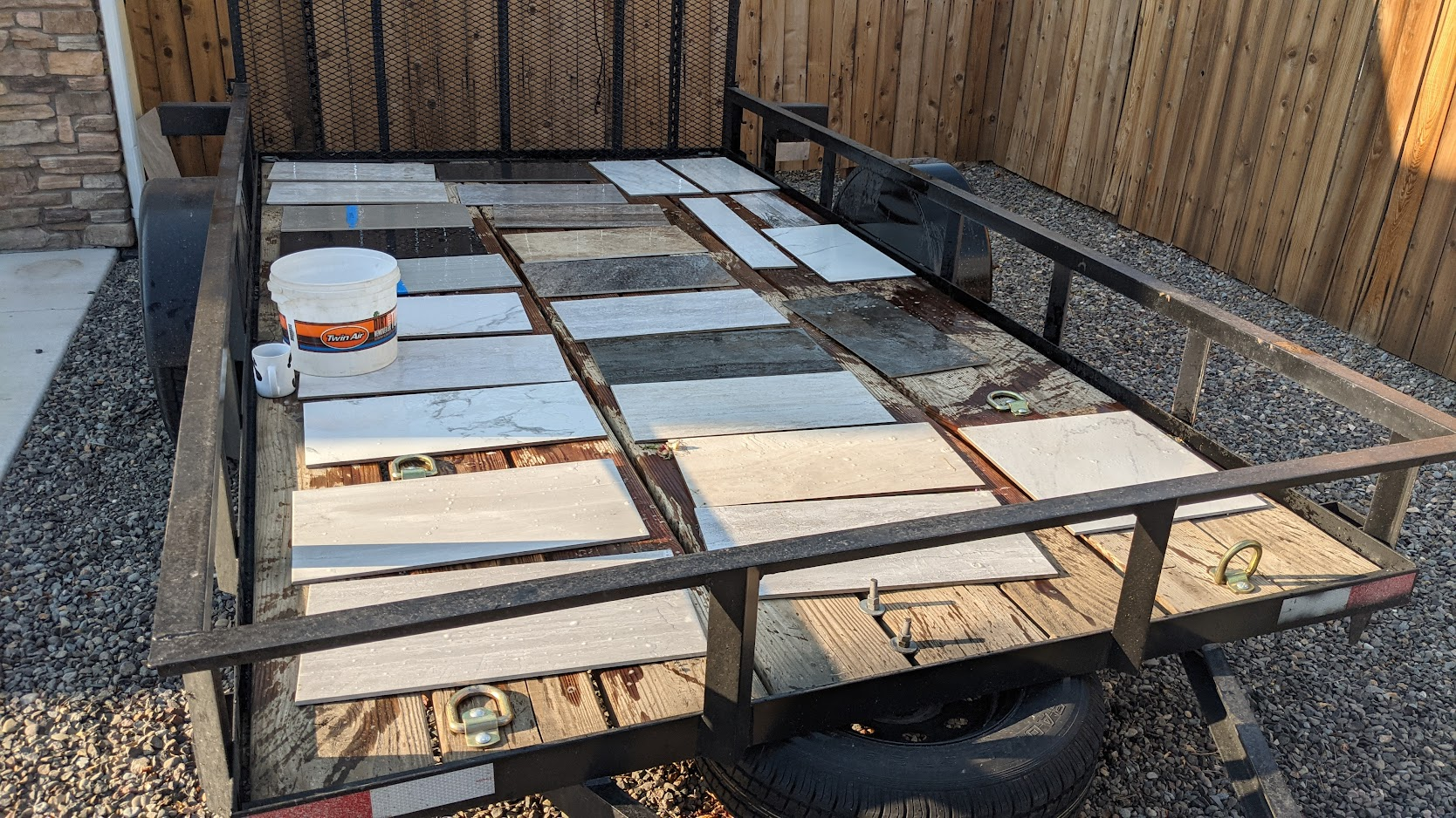

It is a thankless task that many have been involved with over the years. You have my sympathy and support.
Well on the case of tile and grout standards nobody's ever attempted to do it because it's such a hard course to teach what with all the props and equipment needed to teach it properly..
