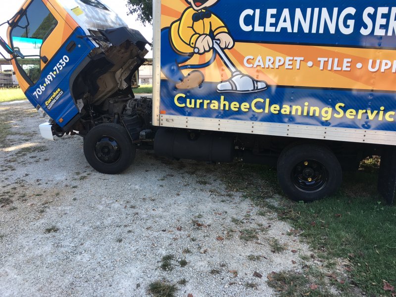

Back to the fuel tank. I bought this from a box truck salvage yard in Colorado. It comes with the mount that you have to mount the tank to the frame also. I putting it on the same side as the current tank on the truck, so I can just fill them up easily at the pump. They call it a saddle tank.
And the reason I wanted to buy a fuel tank made for a box truck is because of the element inside the tank having access to the whole bottom in case I'm on a hill with the tank low on fuel. Much better than a home made fuel tap with just a hose sitting in the middle of the tank.
