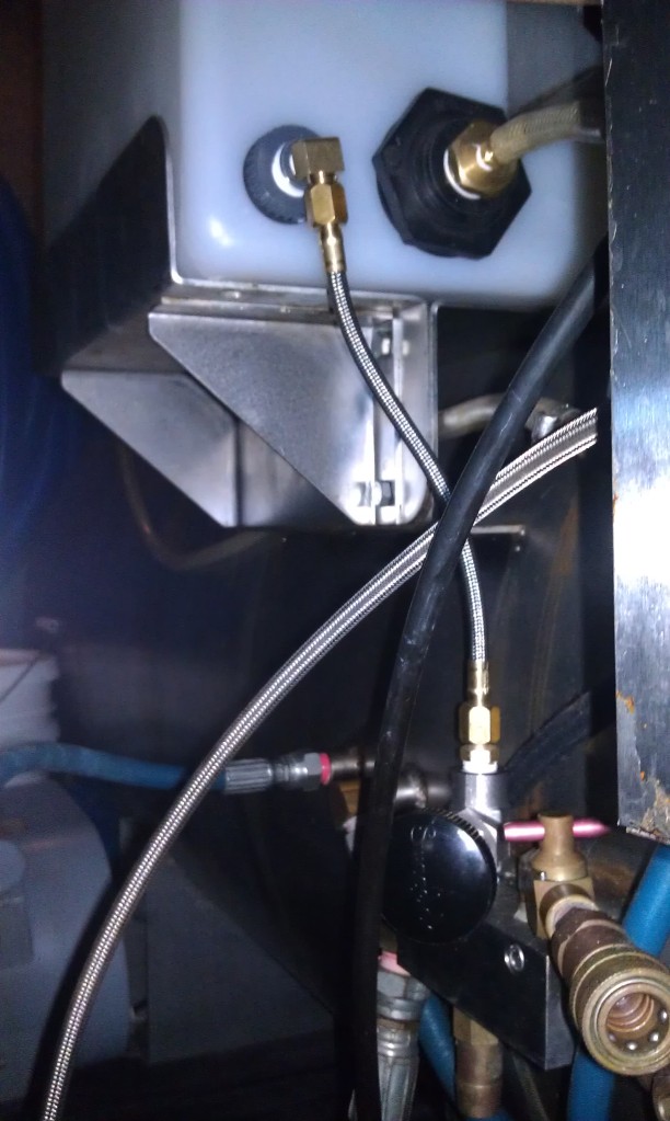

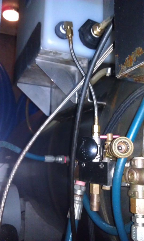

My solution tank cracked at one of the corners about 2 years ago. I hardly used any rinse anyway. Replaced with a 5 gal square pal that fit pretty good, but was a quick fix. Replace the tank and also installed a fresh hot water fill system to mix new rinse instead of having to put the water hose or solution hose in it. I have to say - very nice idea.

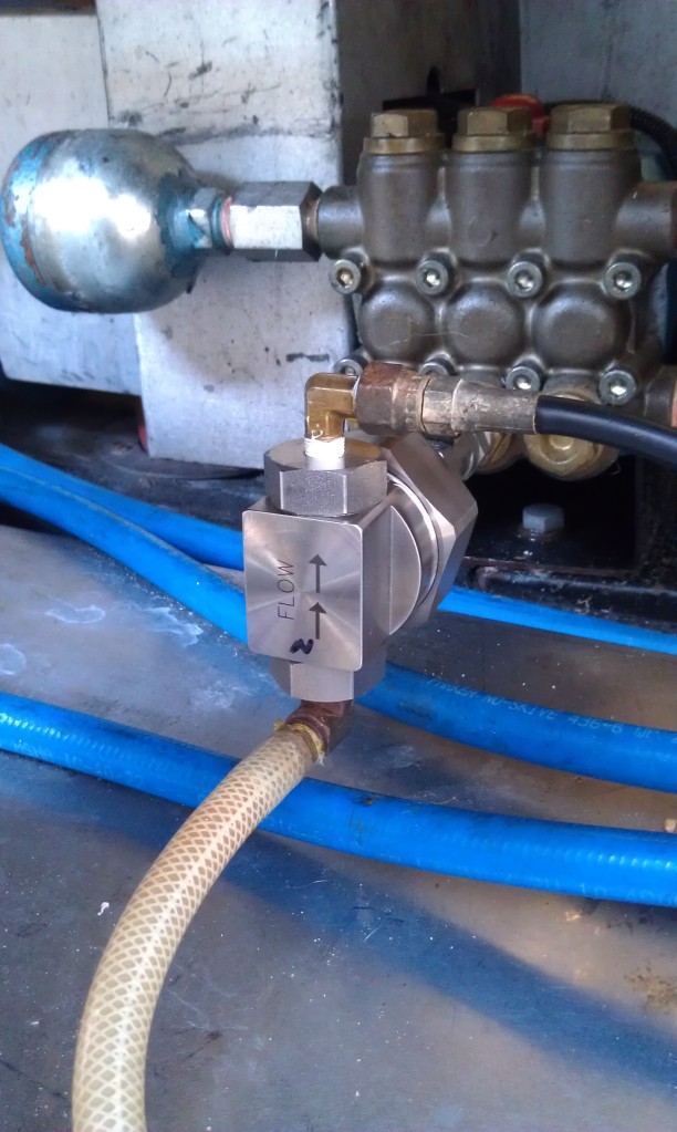

Also replaced the old chem pump (600-700 max) with a new higher psi chem pump (1500).

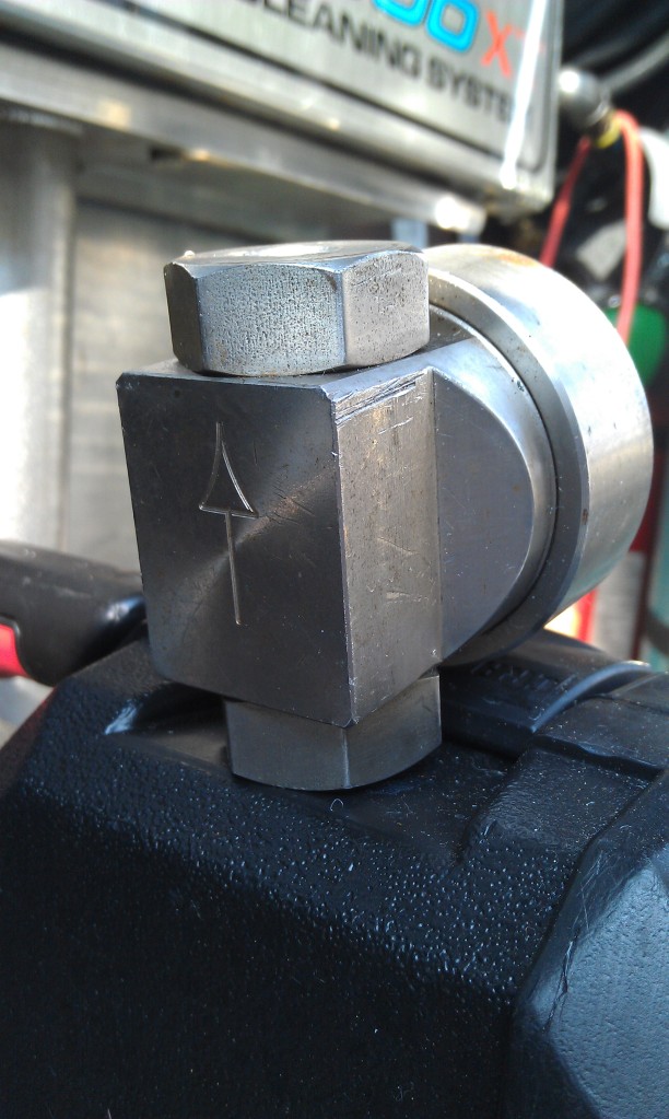

I was told that pulsation dampeners should not be ran on their sides.
Put it out on an elbow
