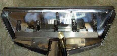

Question ? if a 13.5" Ti. wands needs 7 jets why is Cobb using 4 jets on a 14 wand? I remember Cobb suggesting 5 jets with a 14 wand. Now using 4??
Larry Cobb
5,795
Larry Cobb
Magician;
We have both a 14" 4-Jet and a 2" Tube 5-Jet (shown wo GG):
You can have it your way !
Both of them have more uniform angle-jet spacing than the Titanium.
Larry

um.....guys, one of the reasons I made the checkvalve/jet extenders was to correct the center gap issue, that in combination with 110 degree jets helps a lot, but don't think for a second on a filthy carpet you won't see a less than clean area dead center, it's a gap that simply does not get the same water flow, heat, and pressure as the rest of the wand. You will also see it on a commercial job where you come across a gum spot, human nature is to hit the spot dead center with the wand and melt it away, but you are actually better off with the Ti to hit it off center for maximum heat and pressure from the three jets on one side or the other...with a Greenhorn it loves a dead center gum spot.

It was just common sense that made me go with the Greenhorn over the Ti. It was the jet spacing that sold me. I didn't really have to use the Ti to figure that out. Just seeing the uneven space in the center of the Ti wand was enough to discourage me. And having a middle jet just makes it easier visually to be right underneath a jet for extra spot cleaning effectiveness. Besides, I was using a Steam Way wand for decades which has only one center jet, so hard to change my ways about that.
