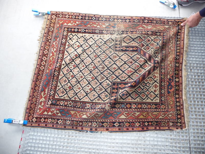

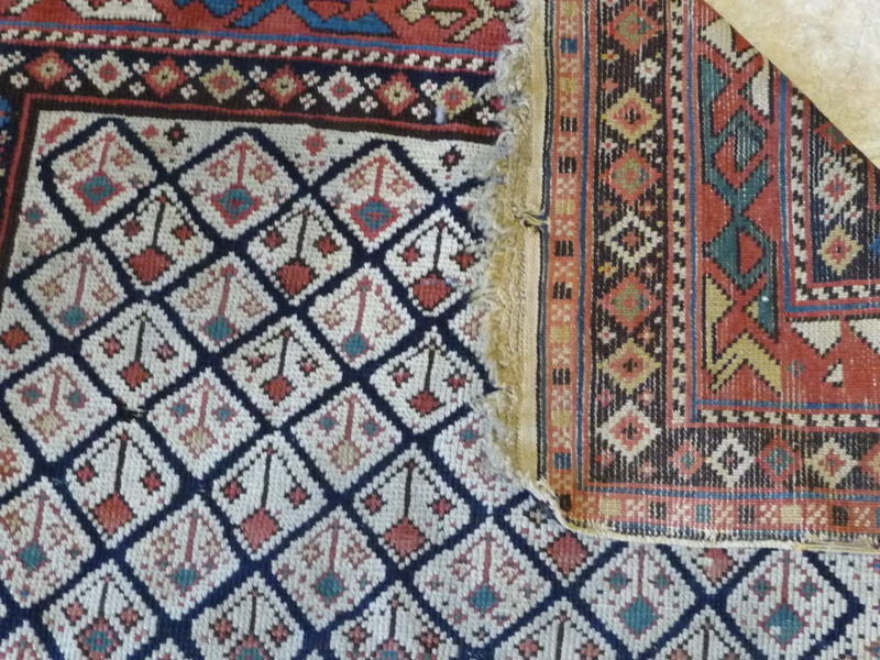

This one came in from a fire damage today.
Smells real bad.
What is it?

shiravan
it needs some repair don't do any machine repair to this rugs

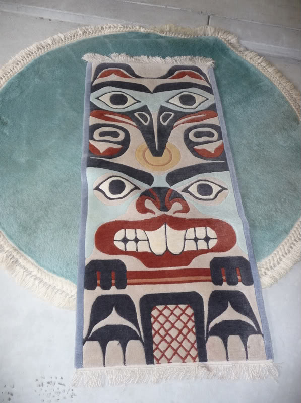

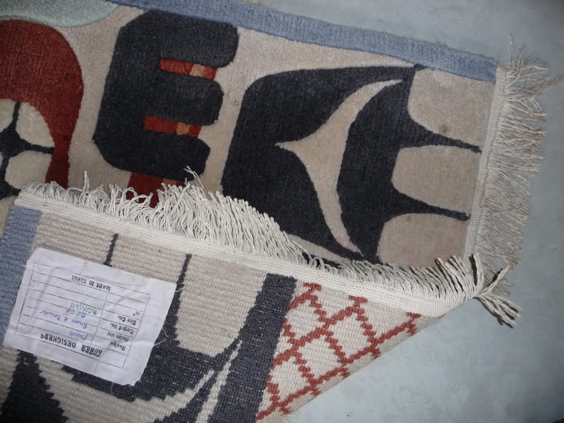

Beaver and Raven designed in Alaska, made in Nepal
Had some existing dye bleed in the fringe that MB's Magi and fringe bleach would not do much to.
I hit it with steam but only got about 50% out.

Mikey I think that is a little to big for a prayer rug . A prayer rugs usually measure 6'6 or smaller. That is a
Nepalese which I am sure Randy could explain.

Mikey I found out this let the fringe bleach dry on its own without fans

Take the rug with the dyebleed on the fringe into the drycleaning shop and let them use dry steam and Streepene to get the red out. The drycleaner will know how to do this.

It’s a Shiravan Prayer rug It appears to have some hot colors..not natural dyes and the design wasn’t executed well so, it’s not that valuable. It could use some repair these are thin loose weaves when the ends and sides go they fall apart quickly.

The main & secondary boarders are poorly done it’s not that the boarders don’t match up perfectly it’s that the design has no integrity throughout the whole rug.
I'm on my flat screen computer so colors don't alwasy show true ....Some of the green looks possibly synthetic is there any brown in the rug ?
