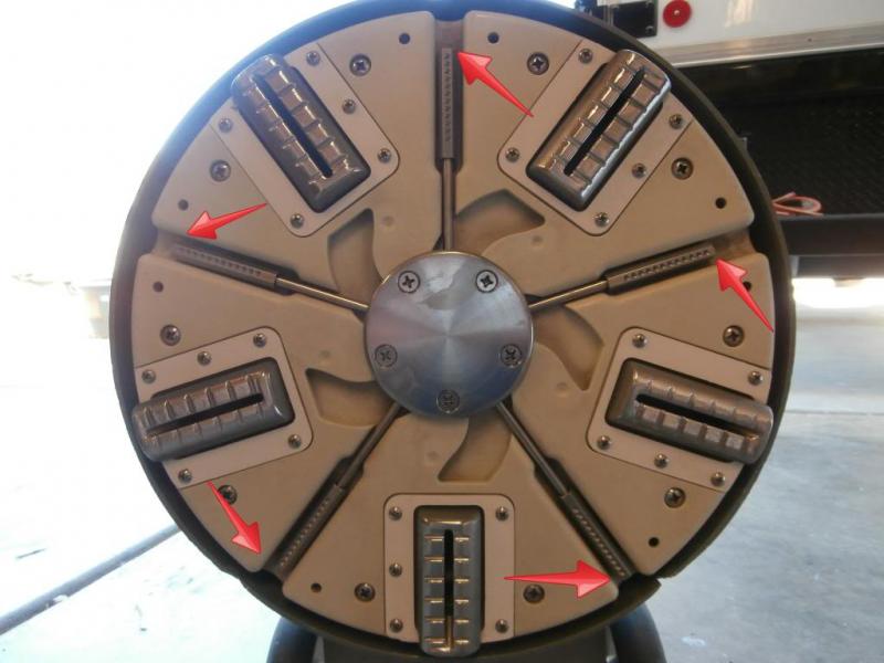

My 1st generation HOSS has been fudged with to increase flow by increasing the "Flow Disc" hole size. I would assume it puts out more than the XL (even though I have not installed the full set of long spray bars yet,I'll do it Sunday) So I'm a bit surprise at how much quicker it recovers the watert than the XL does.
What with the new black shaped glides that we feel clean deeper and faster the two machines are near identical in effect and control except the HOSS needs far less dry passes.

Hoss has five vs four glides on the RV. Might 'splain better drying with bigger suck machines.

I'd like to put my long spray bars on, but I also need longer bars from the center. As each size spray bar also has an bar that is made to a certain length for it. Apparently no distributors can get them, and calling the company multiple times go me nowehere. Just got the run around is all. They've been sitting in my truck since spring time. On a positive note, I just cleaned about 18,700 sq. ft of carpet in apartments with it last week. Its a great tool and a money maker. Cleaned carpet like a champ.

Get on down to your local steel supply for some SS tube or auto parts store for some brake line. Thread it and there you go.

I believe it is called a high flow kit.....comes with the staggered long bars and a needle valve....
Brake line will rust.................it is steal......

Had to be operator error....5 high flow bars...off set leading edge vacuum shoes...it is physically impossible not to go faster....
you are pushing 4 spray jets that have to fan out and vac shoes that plant themselves down into the carpet.........with no vac relief.......
Jim Martin
10,877
Jim Martin
Equal only on your vortex. ..your comparing spray jets againest flow bars....and vacuum shoes that allow the air to move against ones that plant themselves. ..kinda like a glided vs a unguided wand....
Hoss is going to give you a better flush and dryer carpet....
