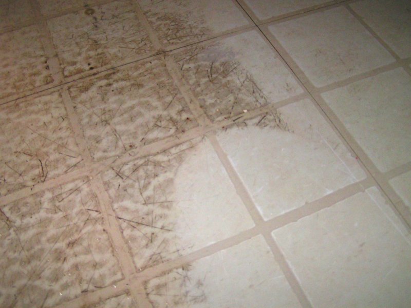

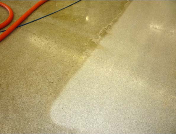

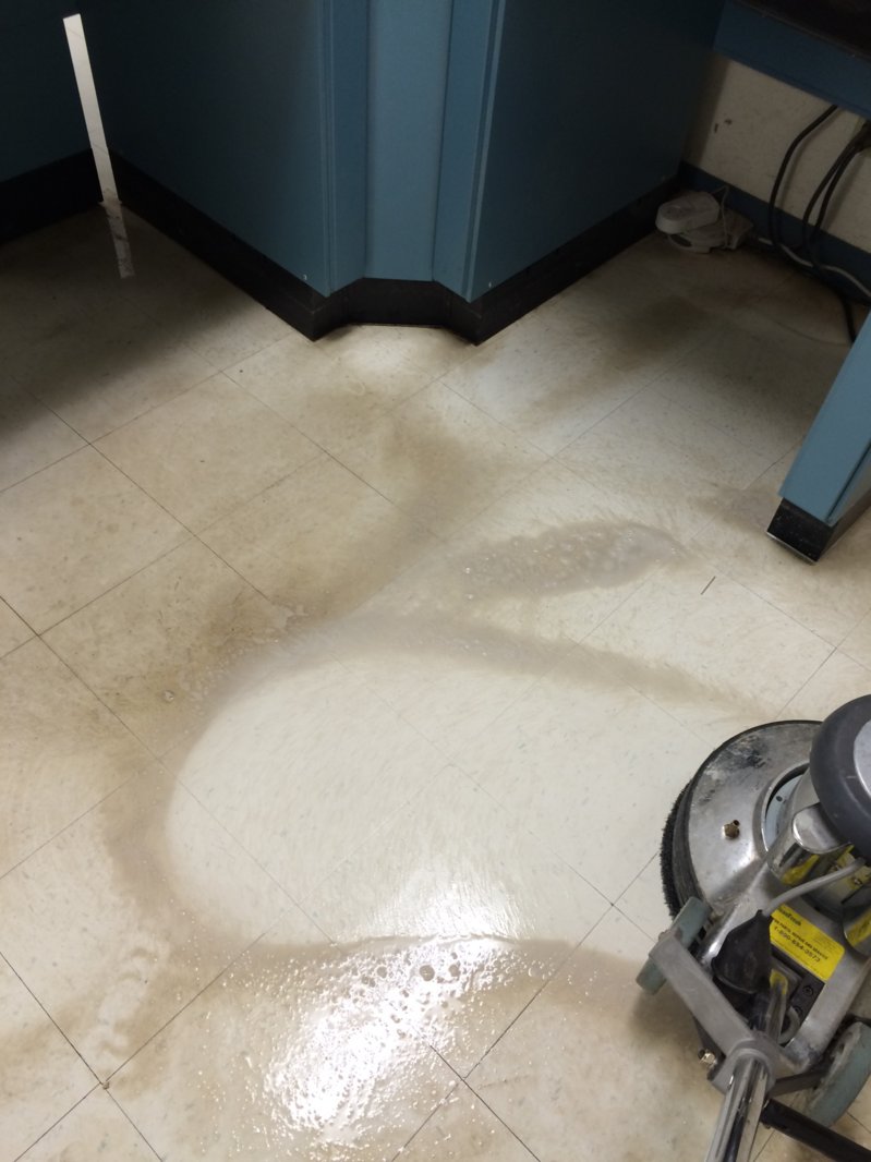

It does work very well. If the floors are really bad you have to mist the floor and let it stand for 2-3 minutes then run scrubber over it and it will pull the dirt out of the wax up to 4 layers deep.

One man only, get all th gear set up, strip with the 175 (small areas at a time to avoid wax redepositing on floor_) lay down the 175 pick up the wand and rinse and repeat. It is a pain to clean the recov tank. Use sone stripper and toilet brush and rinse. It's a little cumbersome but compared to rinsing with a mop and bucket you fly through the job. Speed dry with air movers. Although I don't really like doing vct, we make more money than carpet cleaning.

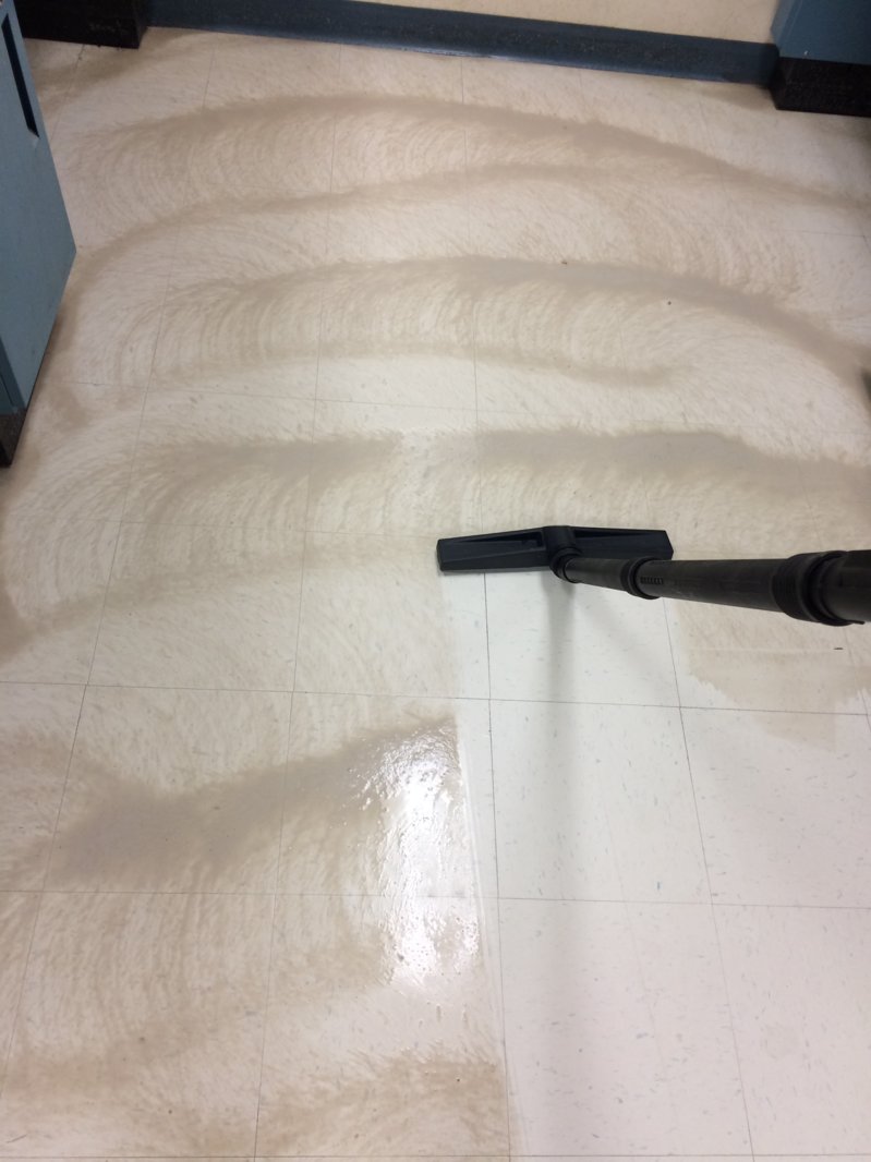

It's good to keep an open mind so you can discover new products, methods or techniques for solving old problems. VCT never got me excited but I get then occasionally and charge from .65 to 1.20 per square foot depending on the complexity. Dental office on Tarkett sheet goods where I have 45 minutes prep time just getting ready to strip. (dental equipment, Charis etc) Since designing the Turbo-Hybrid I appreciate it even more at doing wax stripping as a thorough suck & rinse tool before applying new finish.

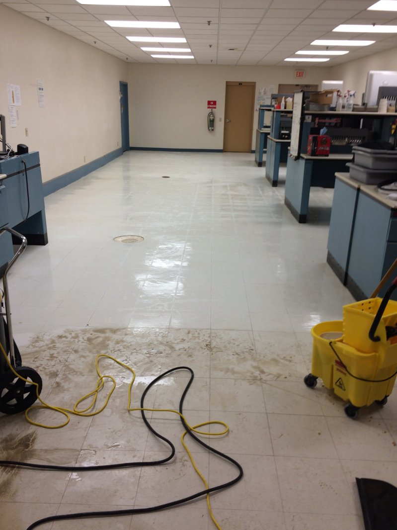

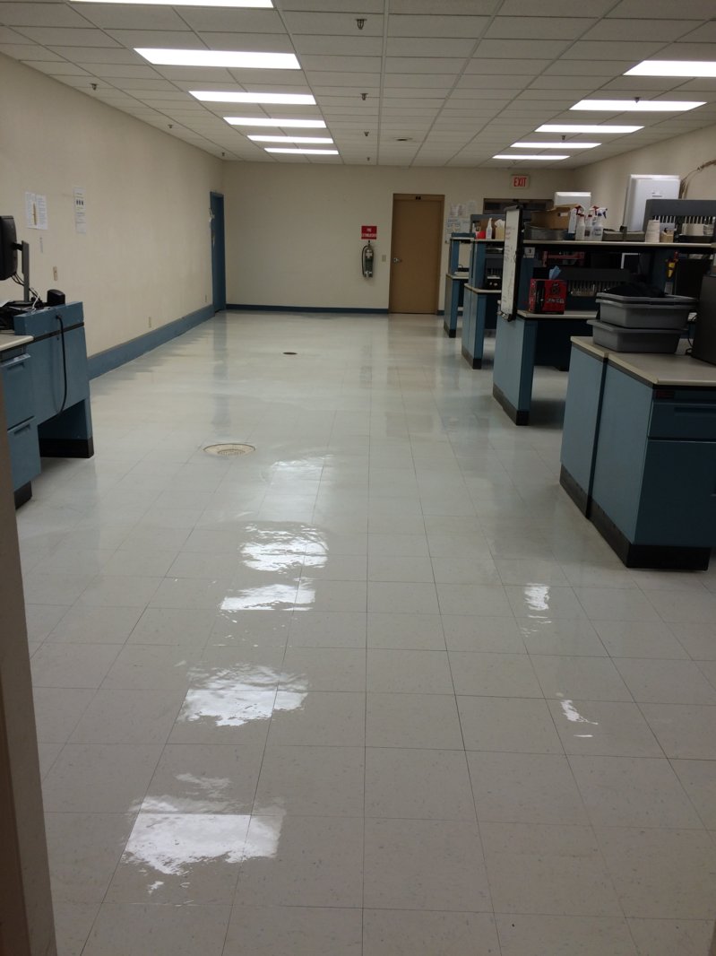

I'm around $1 per foot Justin. It has taken some practice but I usually make $100-$150 per hour doing VCT. That's what I shoot for, no matter what im doing.

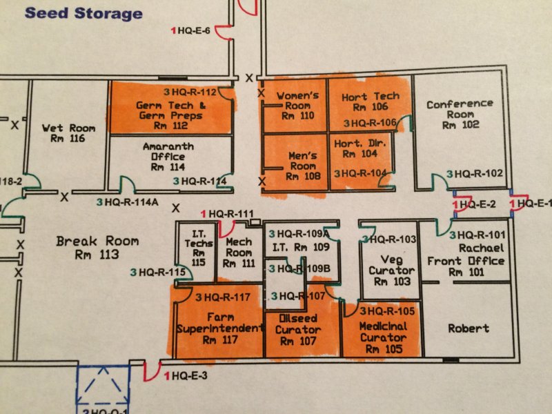

I've got 2700 ft.² to do at ISU starting tomorrow. I will do it in 2 visits so that's about 1350 ft.² per visit. I've already quoted them at $1 per foot.
I start tomorrow morning at 9 and plan on finishing by 5 so I can watch the Super Bowl with my fam. 8 hours of work for $1350. That's BEFORE buying stripper and finish but it's still going to be in the $150 per hour. Next Sunday I will finish with the job, making similar money.
There are others around me who do it but this particular client really likes our work. It's the best when they've tried others and are able to see the difference. We try really hard to be EASY to work with too, from scheduling to completion.
View attachment 11715 View attachment 11716
You're using your TM to rinse and extract with? :eekk:

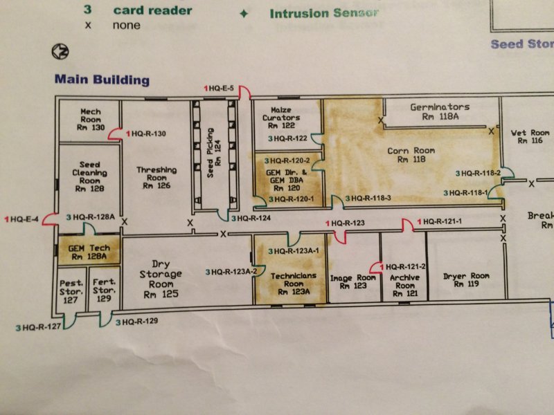

Well, it went as usual yesterday. It took longer than I thought it would. That's pretty typical for me. I worked until 7 last night for a total of 1676 ft.² (instead of 1350).
In 2 weeks I go back for 1534 ft.² more. That's a total of $3210 for 2, long and difficult days by myself.
