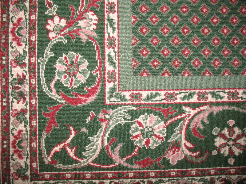

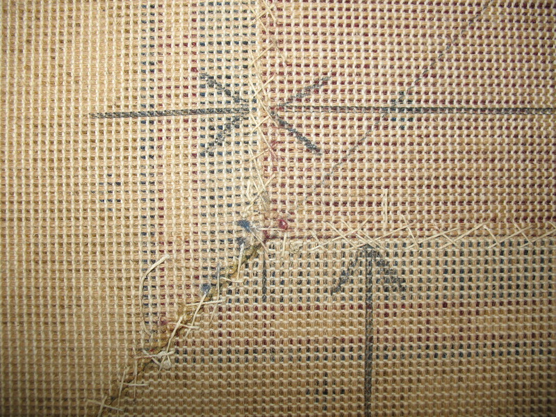

My statement is based on cleaning stark rugs in the home--
Some stark rugs have gotten extremely wavy with just a lite pre spray and the rugs didn't return to normal after drying.
The wavy (shrinkage pull) is usually more certain on bordered Stark rugs.
We have cleaned many stark rugs without problems-- but we still warn the customer and get a waiver from them first before we clean them.
The risk is reduced if we use low moisture and do many dry strokes.
I'm wondering if over stretched warp yarns are the cause of the problem rugs.
The woven border rugs will turn into potato chips because woven rugs that use cotton or jute in the backing will shrink, and mostly in one direction. When borders are put on, two of the borders will have the weave running at 90 degrees from the main field and the other two borders. The pieces shrink against each other, causing the rippling. Lacking a tack-out floor, the rugs will need to be cleaned without getting the back wet.
If you have a tack-out floor you can fix this by blocking, but if you have a tack-out floor you should just tack out the rug before cleaning. Sometimes the borders have to be taken off and the rug remade, as the seams will tear before the backing will stretch.
Likewise, the jute or sisal rug will shrink, the tapestry border will not, the rubber backing will not, and the construction of the rug is not strong enough to allow much in the way of blocking back to flat. Limited moisture = limited cleaning.

Brian if is sewed alot of times it easier. It is suitable for the construction. If it's seamed taped no good. Definitely a blocking floor is key. Good advice.

Several years ago I met a guy that worked for Stark making border rugs. He said everything is glued now, using a hot-glue gun with a two-inch tip. No more sewing.
He showed me the new border rug that was hanging on display: It had a very inexpensive synthetic felt backing glued on, and through the backing you could see the skinny hot-melt seams. Didn't even use fiber tape.
