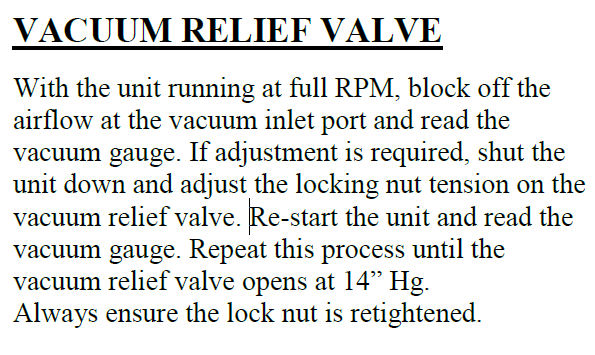

Well I ran it a couple days I noticed a little problem, the vacuum sealed completely at the machine will ramp up to 12 to 13 hg and the relief opens and stays there, When cleaning with a 100 2.5 and 2 inch hose with a Ti wand holed glide sealed to the floor the machine sits between 8 to 9 hg.
and you can hear its relieving at the machine lots of air through vacuum relief, so I tighned it up a little last night, I got it up about to 10hg on dry carpet with the wand sealed to the floof. Sounds alot louder at the wand now to.
