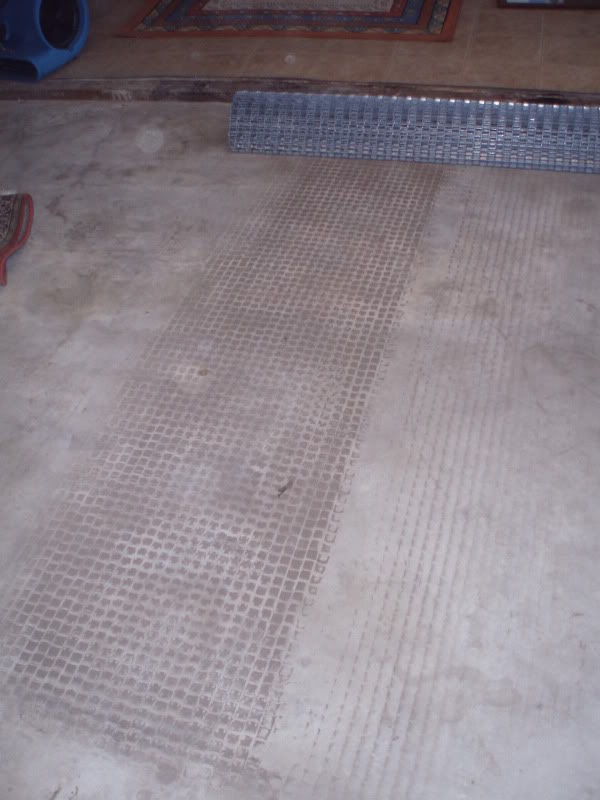

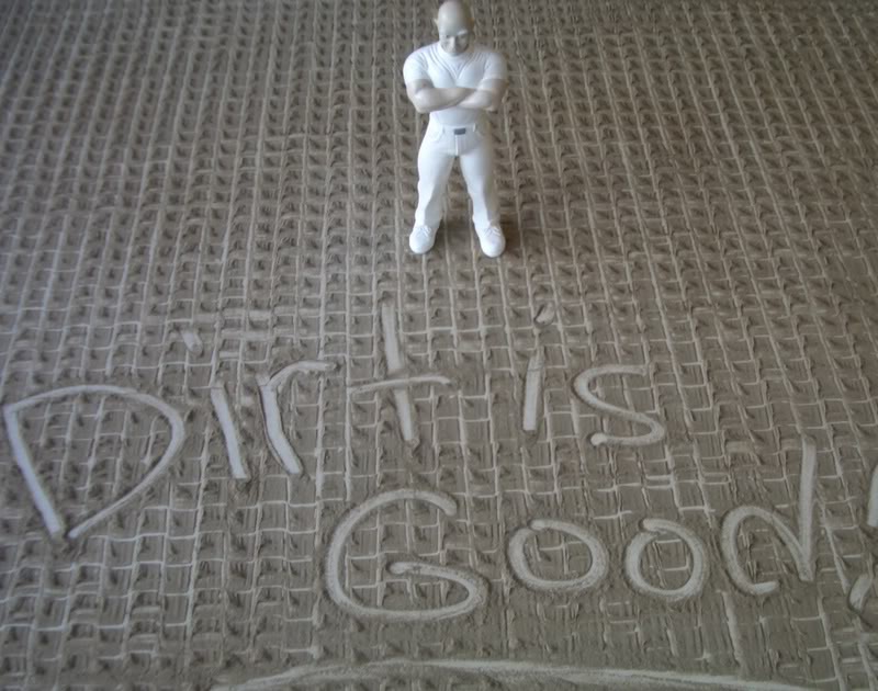

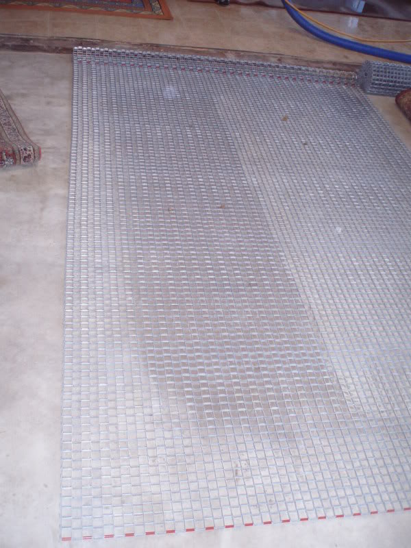

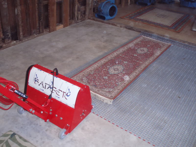

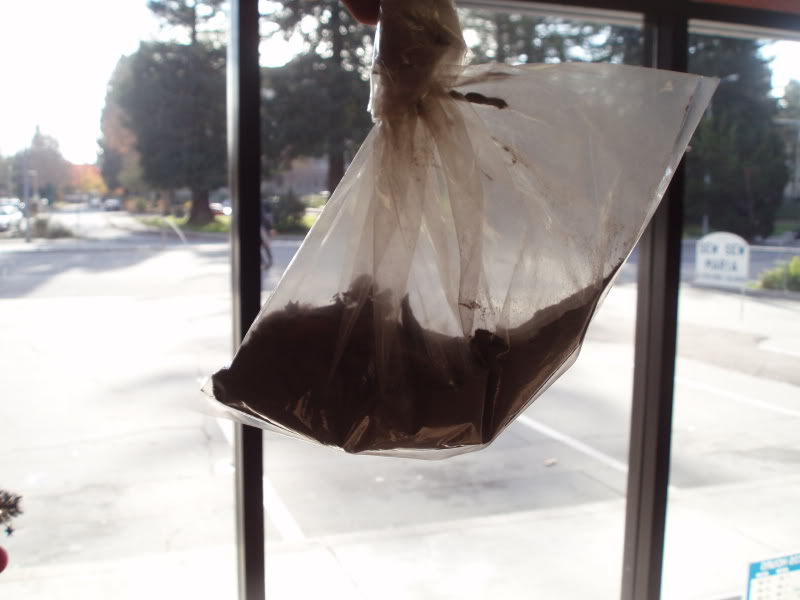

I used mine for the first time yesterday.
2 by 7 wool runner. Didn't really look that soiled at all.
We Sanitaired it front and back then ran the Rug Badger over it for about 3 minutes.
So much dry soil came out the first time that I swept it up and did it again...
In the end this came out of a "clean rug"..

Do yourself a favour.
After you have cleaned it, and the rug is dry, run the Badger over it again.
You will be surprised at the fines that fall out.
