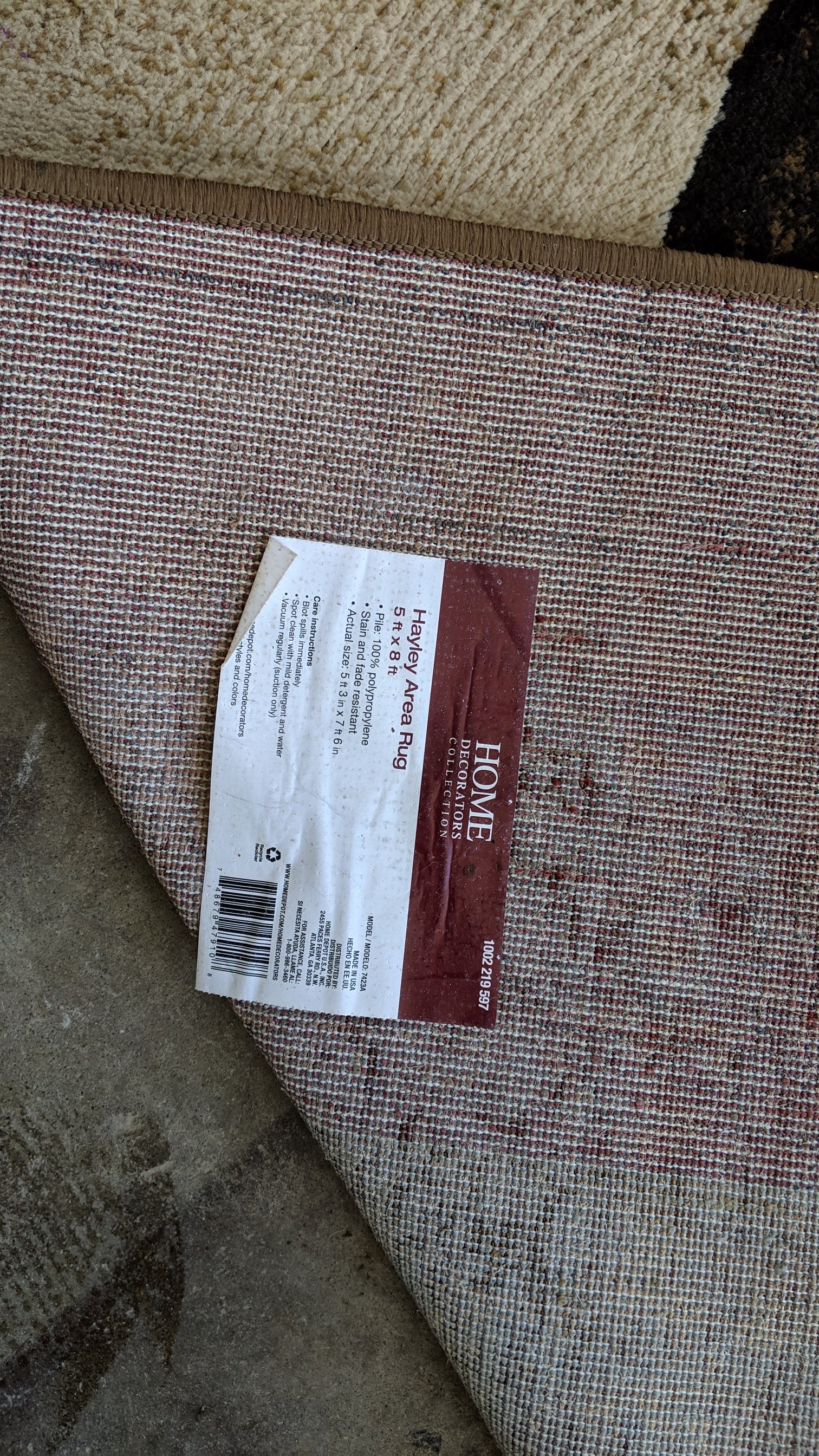

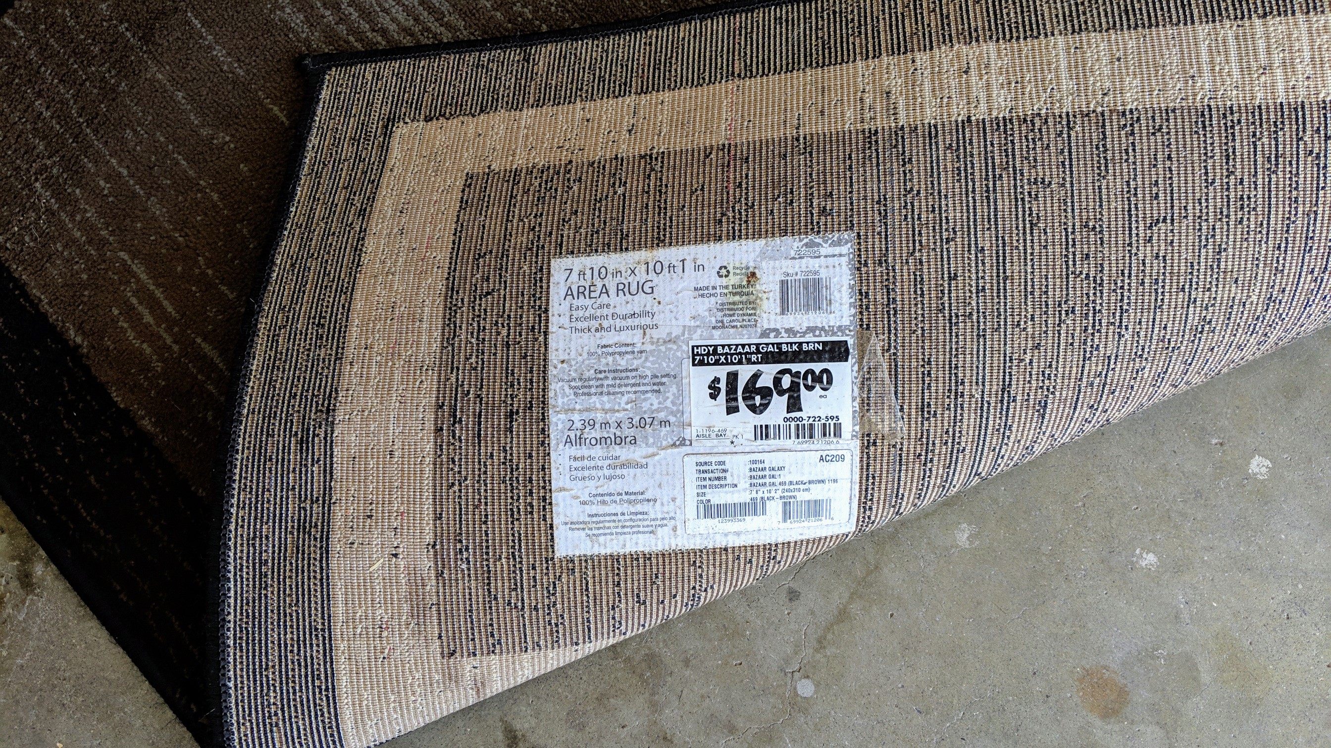

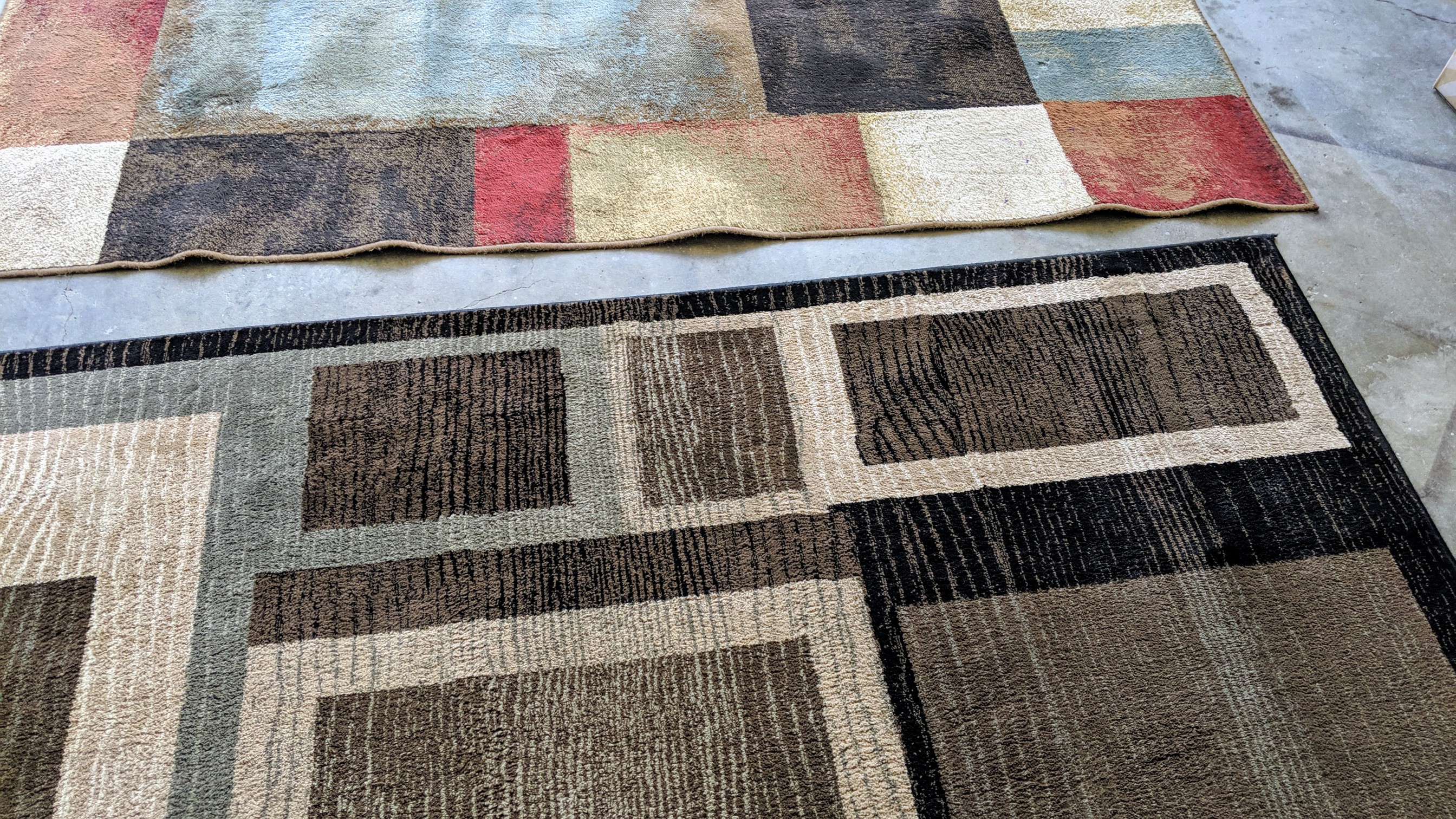

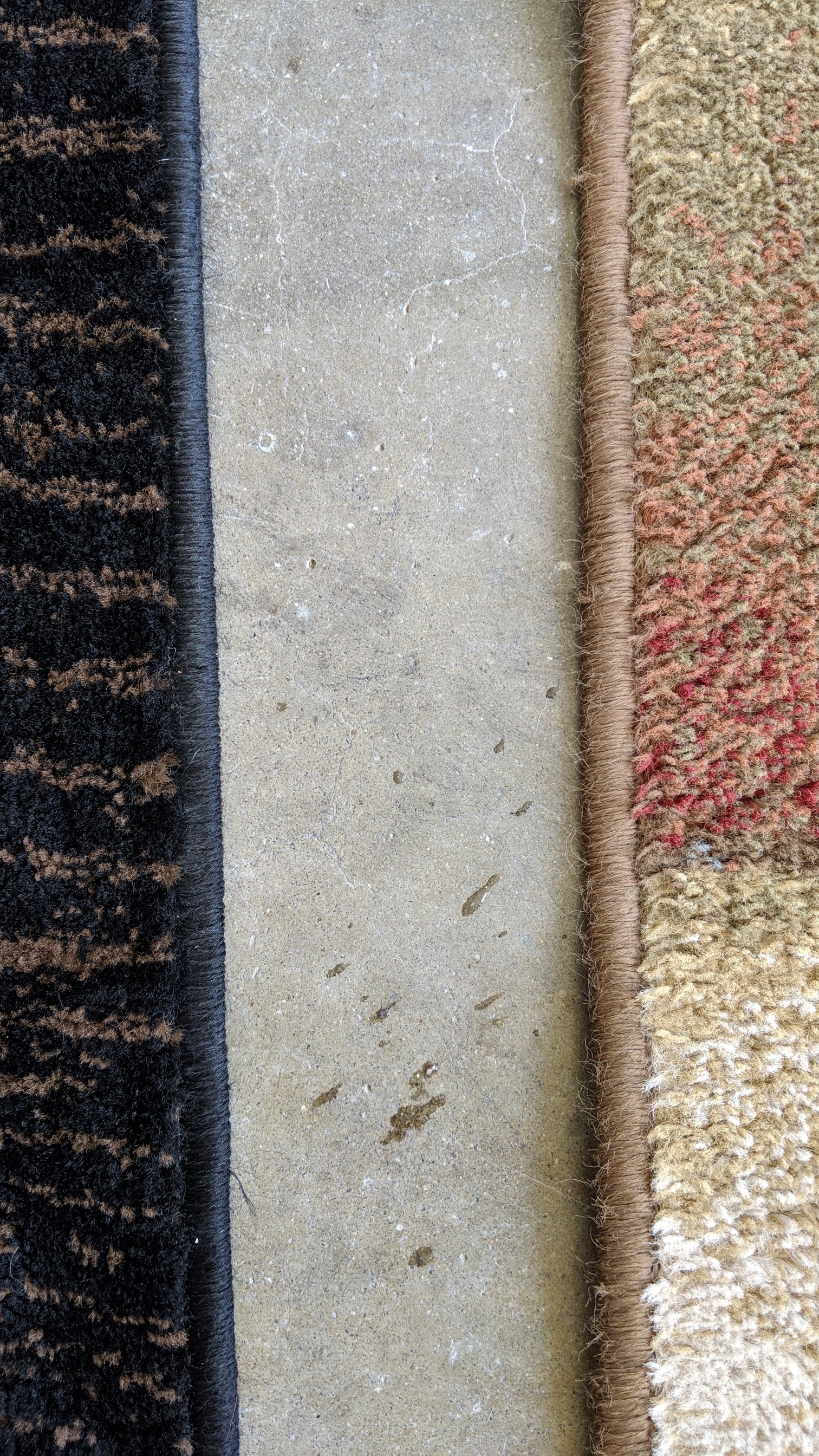

How do you explain this to your customers... IMG_20190412_111919.jpgIMG_20190412_111454.jpgIMG_20190412_111924.jpgIMG_20190412_111934.jpg

Finest Turkish poly rug, fitting for a connoisseur clean.

I have no idea, all i see is cheap rugs

Are you talking about the warping or dye damage on the multi colored one?
117,323
lordy, how do you explain that about 50% of woven olven rugs with bindings ripple?
and how do you suggest they deal with it...

You explain it before you wash it or you fix it after you wash it. Or better yet you wash and dry it the correct way first. JMO!

Is the core (not the face yarn) made of jute on the one that warped?

Clothes steamer to loosen the backing and lay heavy objects on the problem areas
Roll inside out as tight as possible and tie or tape up for a fewdays
Be paitient.
Give away to a homeless camp
14,634
Or just charge them $20 to wand over it and tell them the ripples might take months to relax. If that don't work, just buy another one. It's still cheaper than rug washing it

Easy with a flatbed washer, as the massage of the machine fixes the ripples along with the wash. There are no issues when cleaning, so we clean this type of rug for a buck a square foot. Up to the customer whether they want to pay or spend a little more and buy a new one, and if the rug is in bad shape we offer to throw it out for them for free.
In Seattle, people feel guilty for throwing anything out, so most of these probably end up at the Goodwill.

And if they trip on the rugs "ripples" your $20.00 special becomes a what?
