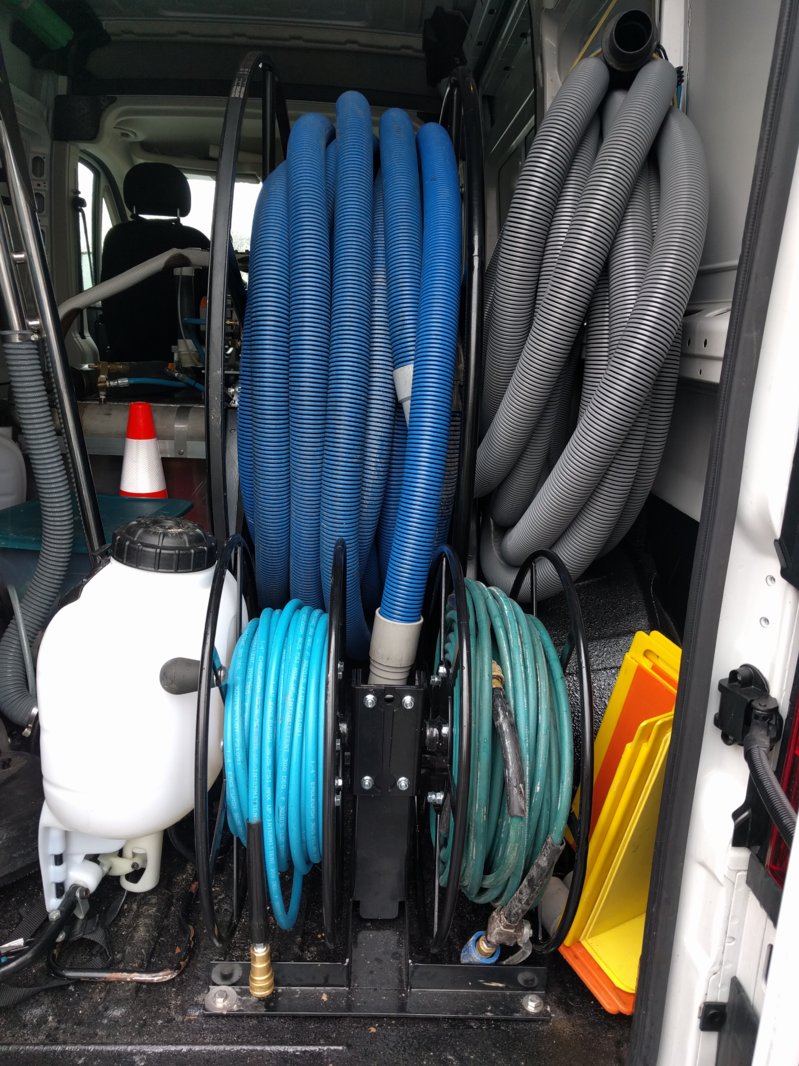

I did exactly what you want to do with my Rokans.
Do you want a picture?
Absolutely. Thanks.

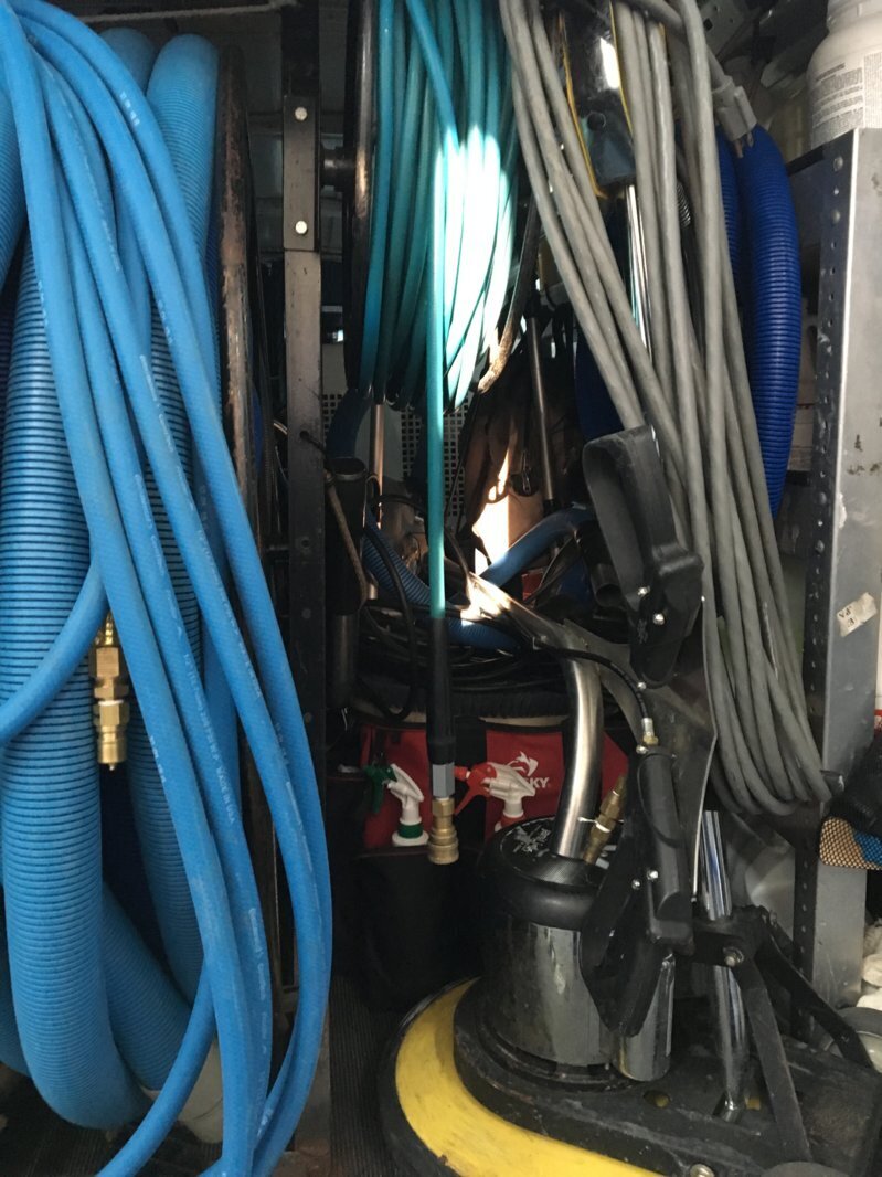

It's on the vac reel now which makes getting some of the floor machines in and out a pain. The water tank was mounted at the rear of the van (that's where it was when I bought it) so it pushes the vac reel over a couple of feet and puts the solution reel directly over the space for the floor machines.

Can you post a photo as well?
If you mean a picture of the current set up, here it is. Headed to a job with carpet and tile & grout. Back to front, is the 175; carry-in bag with spotters, slides, towels, etc.; and BrushPro with SX-12 and SX-7. You can see how the solution reel gets in the way.

I've seen guys mount either the vac reel or solution reel from the ceilings, I think it's pretty nice that way.
A guy local to me showed me his vac reel mounted upside down from the roof. Pretty awesome.....

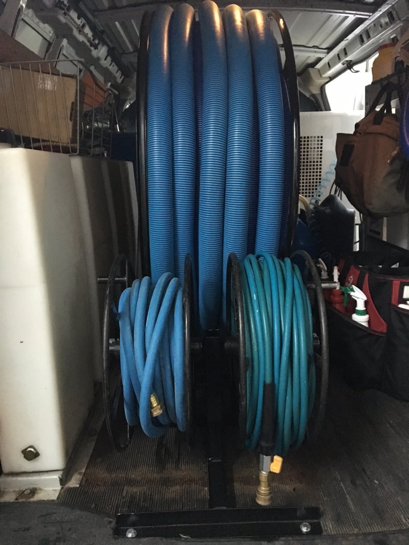

I ended up getting the Rokan dual hose stand. I already had the two storage reels so it made the most sense. Reeling in the vac hose hasn't been an issue and the added room for the floor machines is great.
