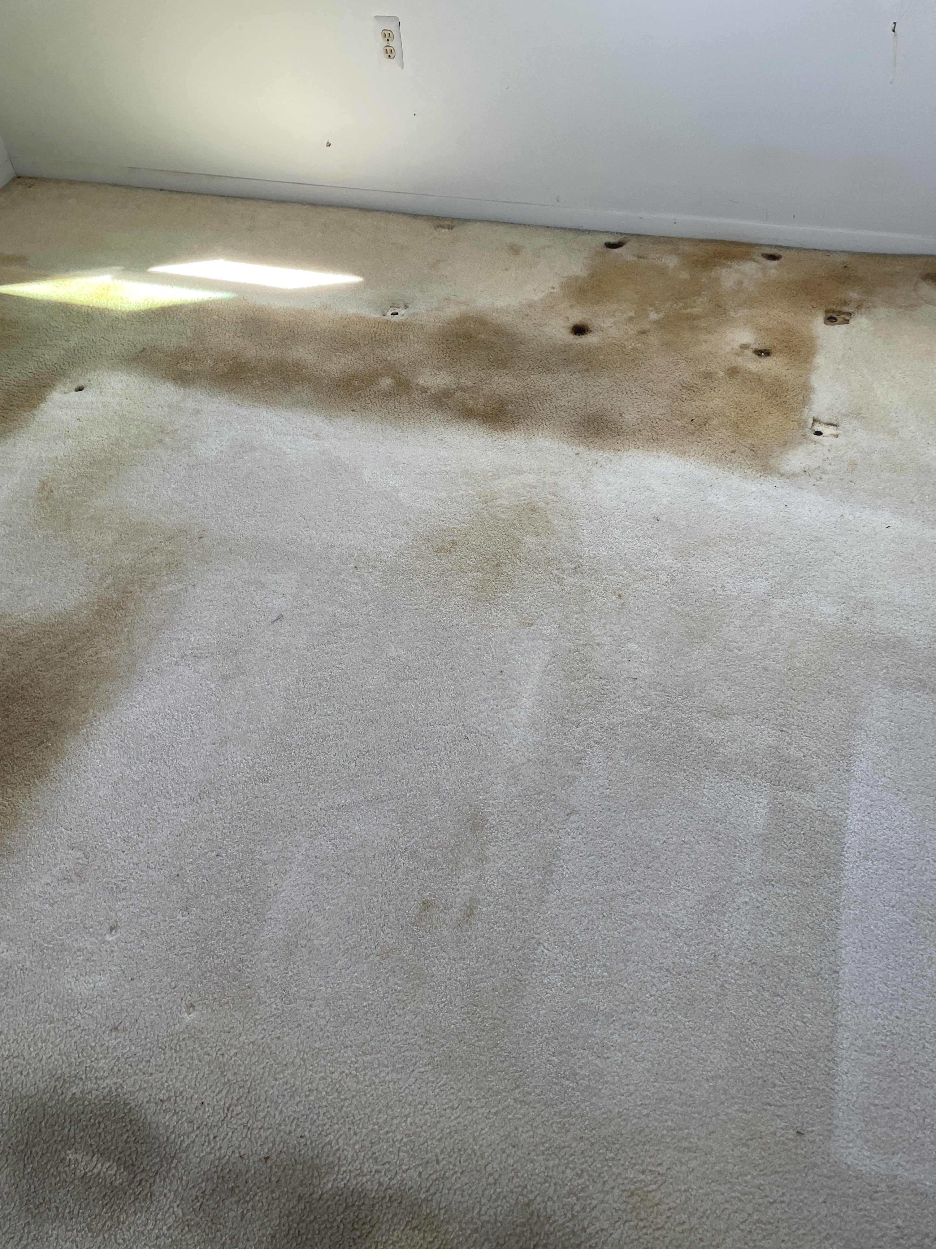

I have a client that is being difficult. We cleaned the urine-soaked carpet in a rental for her.
We only did a regular cleaning. Stains and odor came back because the urine was severe.
I have offered to do a recleaning, using more water and Odorkiller. We will use Drymaster's HVE, a stand-on sub-surface extractor.

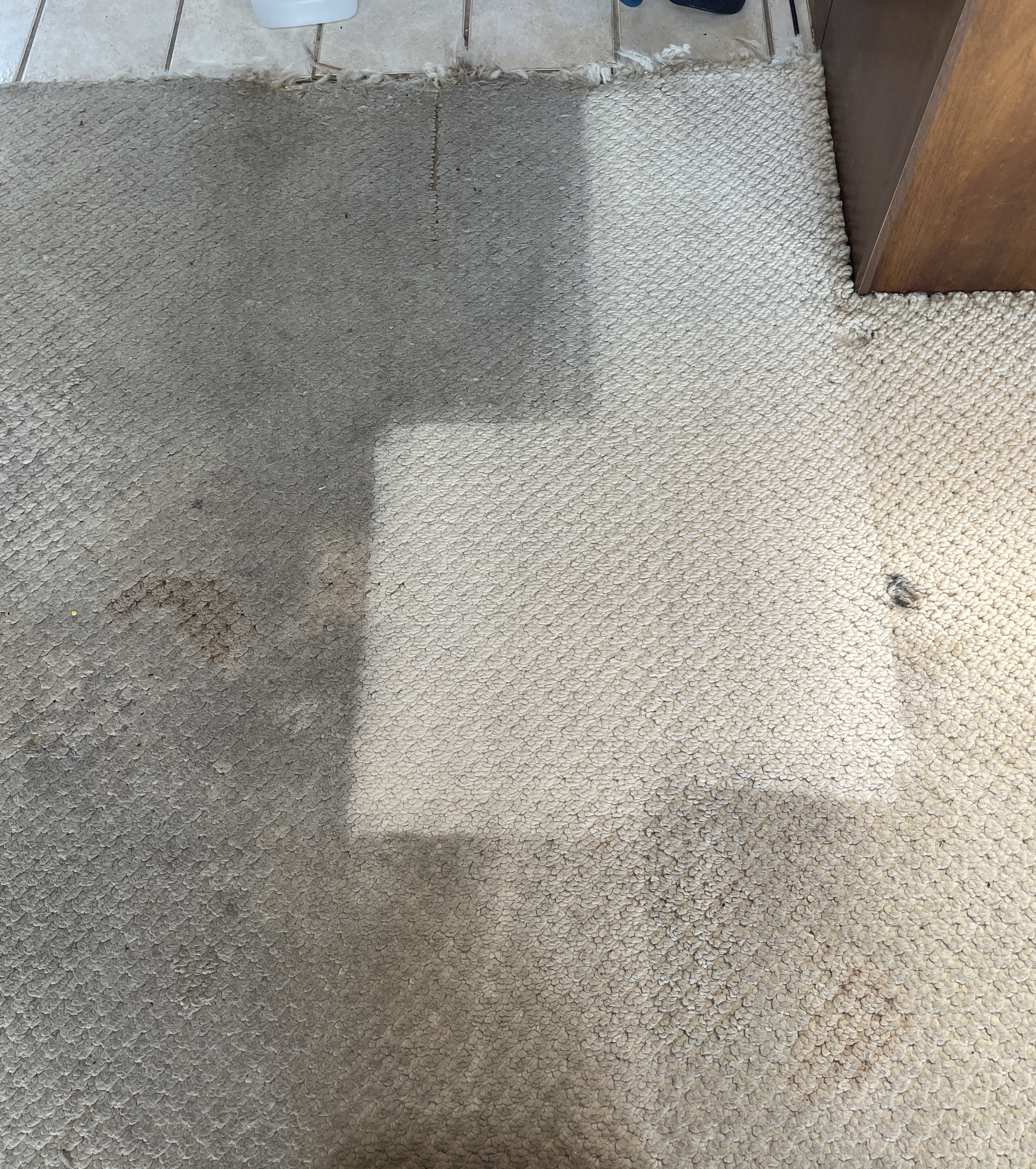

I love white nylon.
This cut pile carpet didnt come out that good. Still has an odor.
Had to clean out my waste tank today.

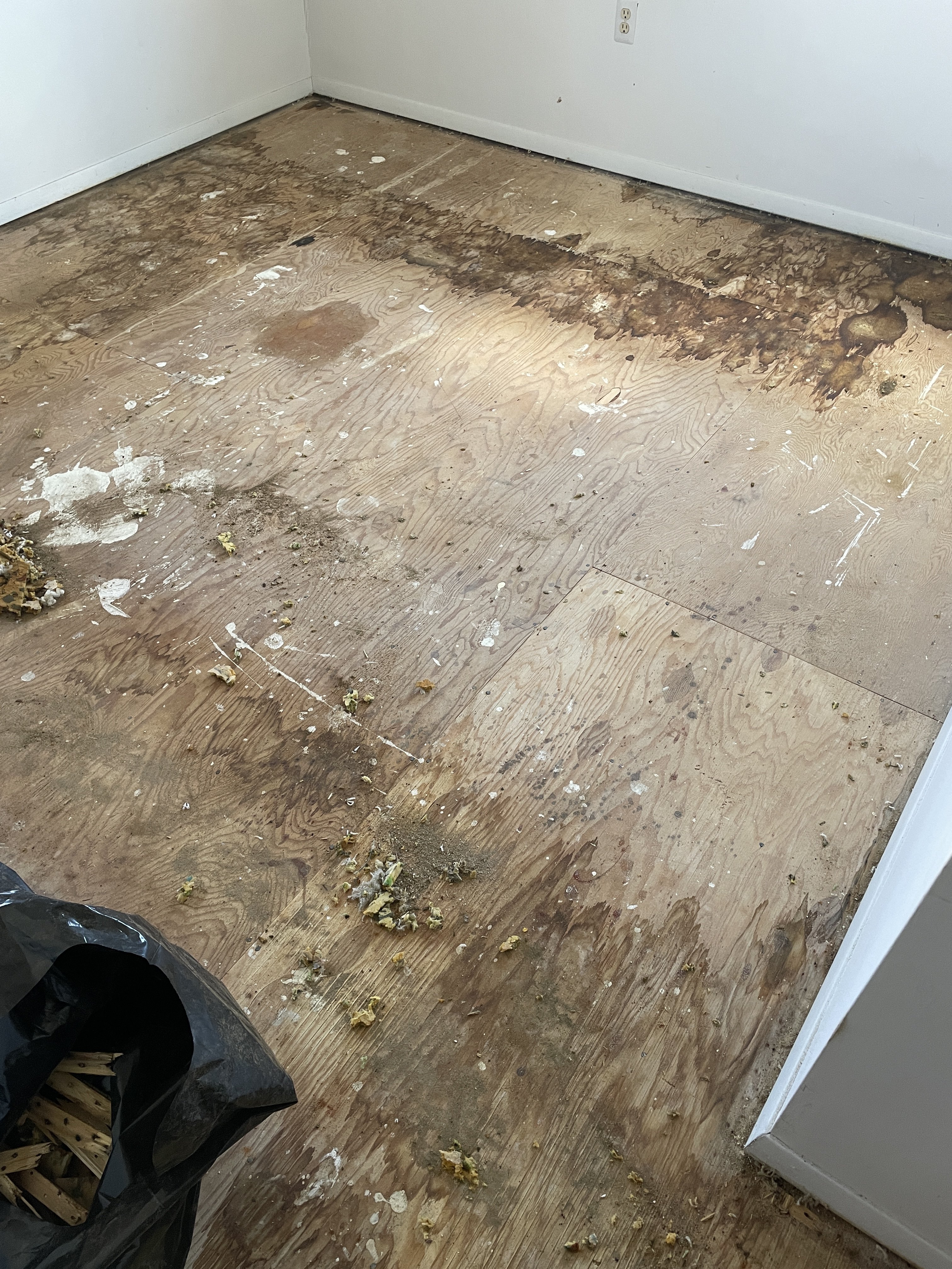

I think most people fail to do this important step.
Typical phone call from a landlord:
"I need a deodorizer for pet urine. We replaced the carpet, and the place still stinks!"
Me: "Did you seal the floor first?"
Landlord: "No, why?"
Me: "You'll need to pull the carpet up and do that"
Landlord: "I just want a deodorizer, not a lecture!"
(It goes downhill from there...)
