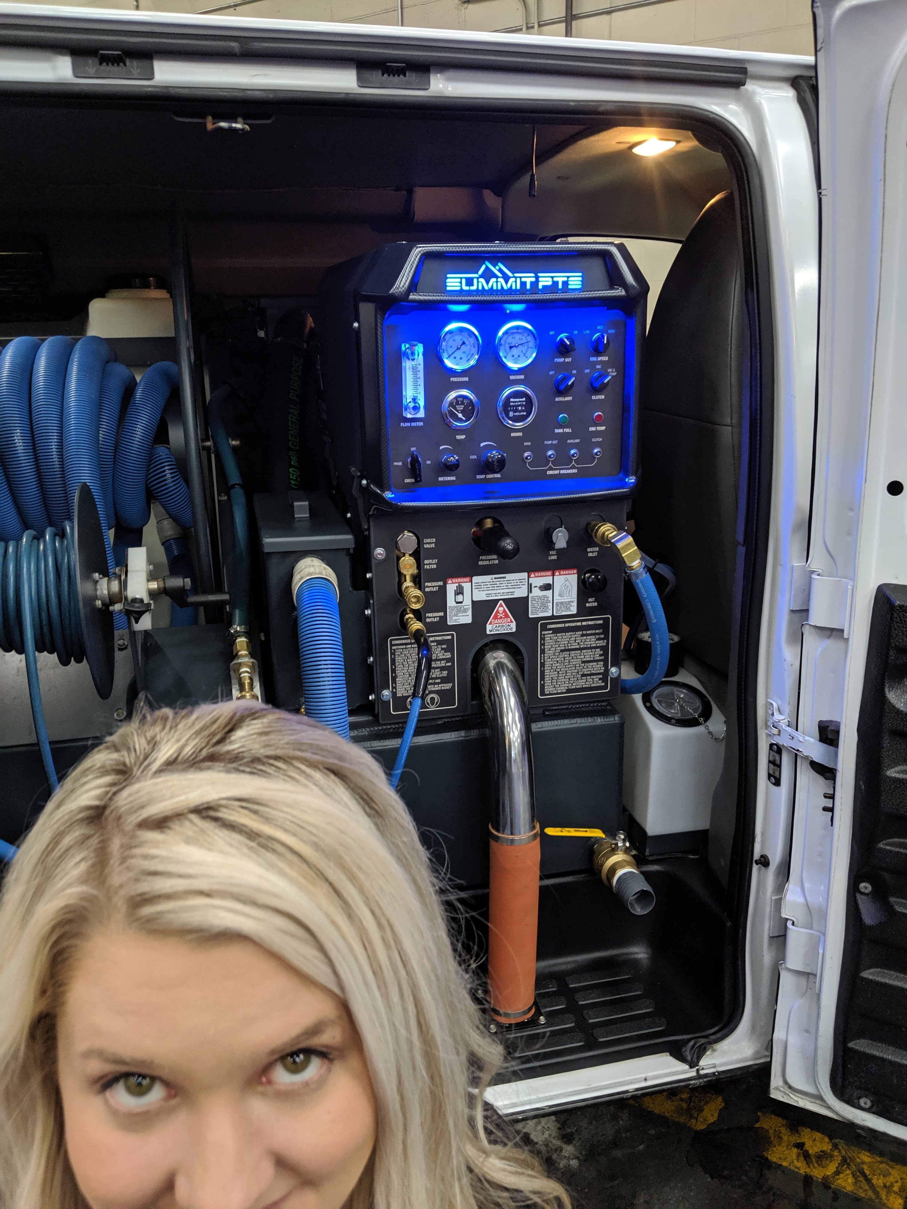

There is a class action suit regarding gm diesel fuel pumps and while searching I came across quite a few gas fuel pump failures. Also there were codes indicating that fuel injectors were faulty. If the blower exhaust is a problem, redirect it.

It gets a lot hotter than that when the TM exhaust is blasting out under the van. It will melt the 2" hose if it's in the way.

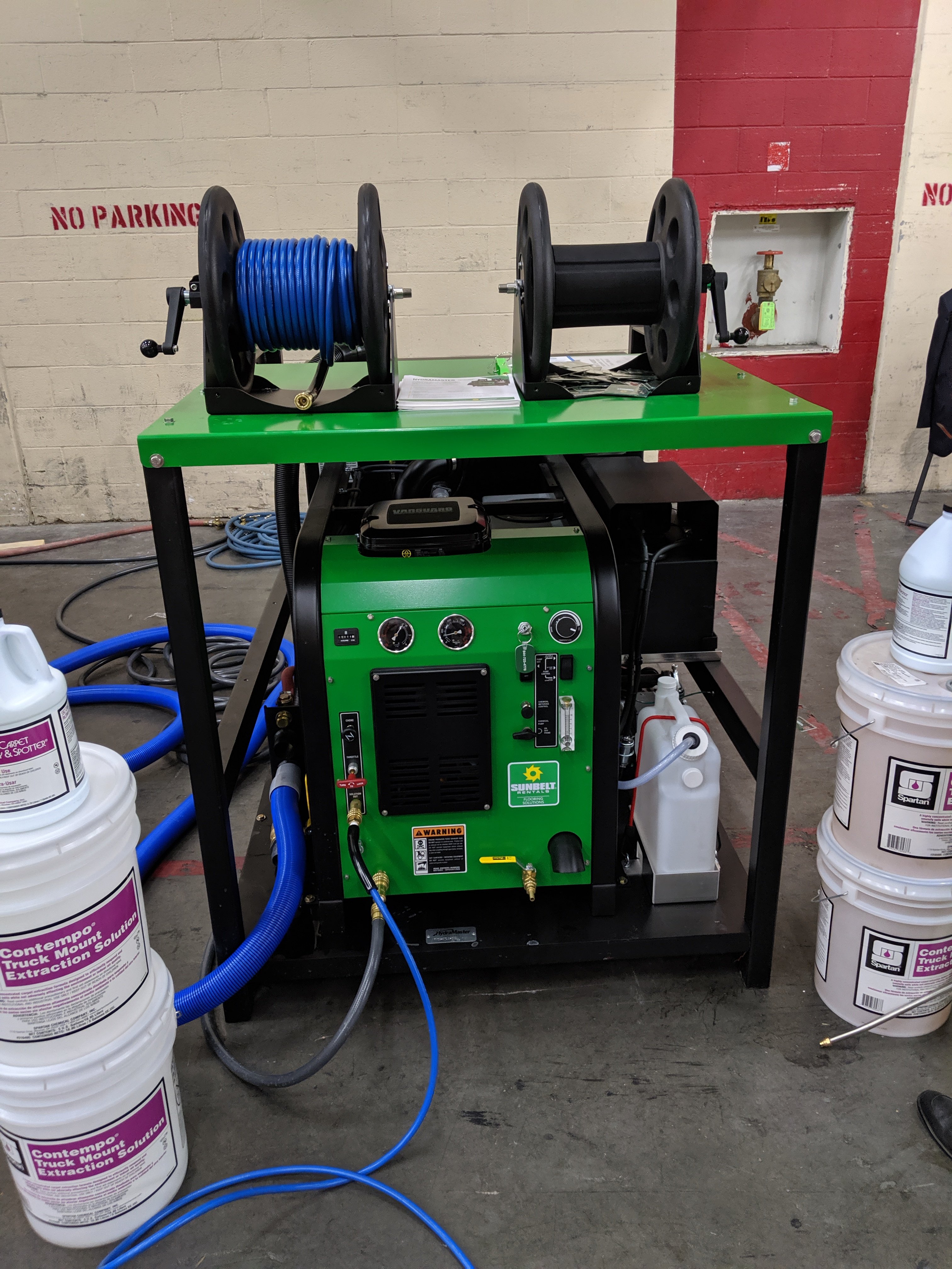

They should put a fresh water tank in place of the recovery tank. If you ever need to clean out the recovery tank now it would be near impossible to do a thorough job. With the stainless steel coolant heat exchangers you better make sure that your softner bottle is well charged or that thing will plug up fast, not a lot of room for ANY buildup between plates.

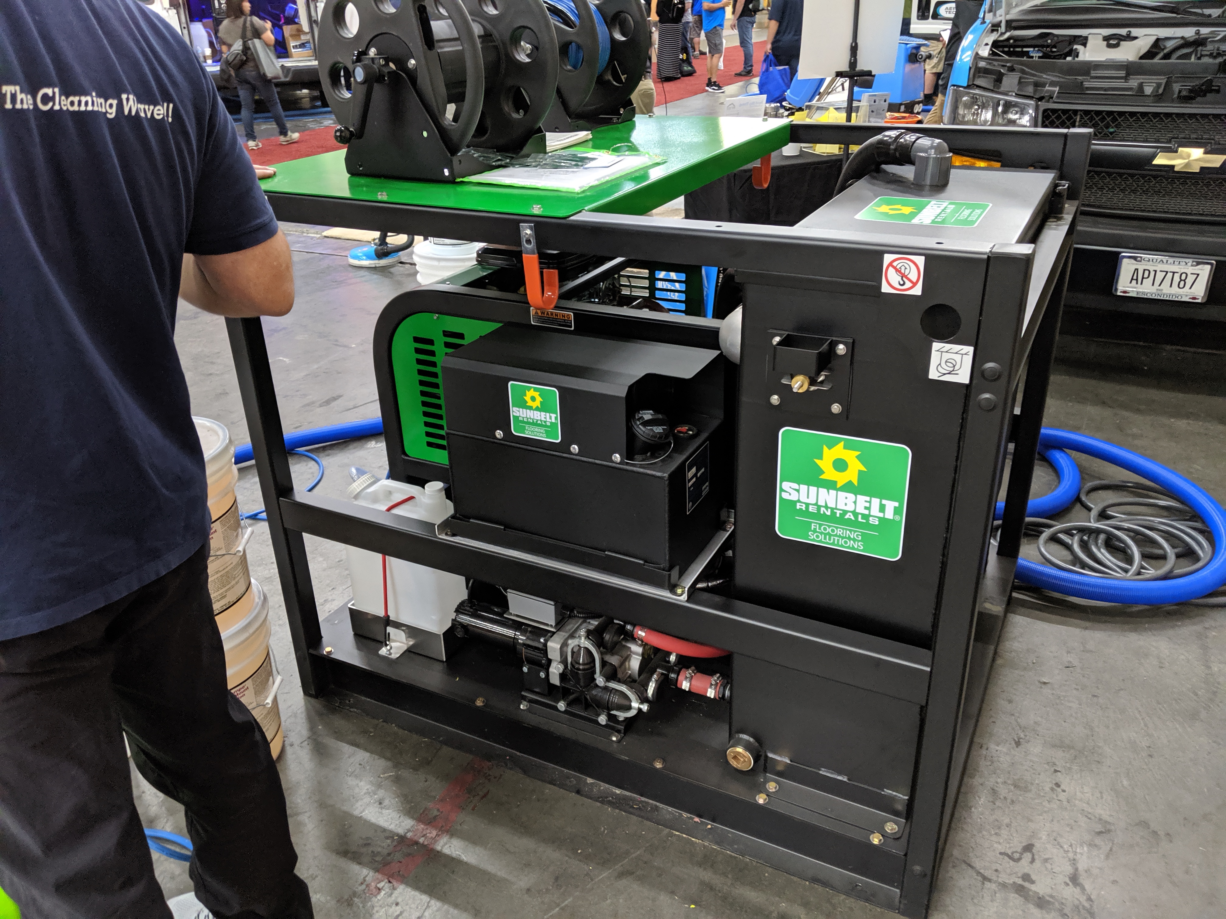

Oh good, now testosterone driven individuals can rent a slide in from Sun Belt.
Great!
Considering the secondary market all the little Bissells machines created for correcting soil saturated carpets.
With that rental in those hands, the sky may be the limit.
