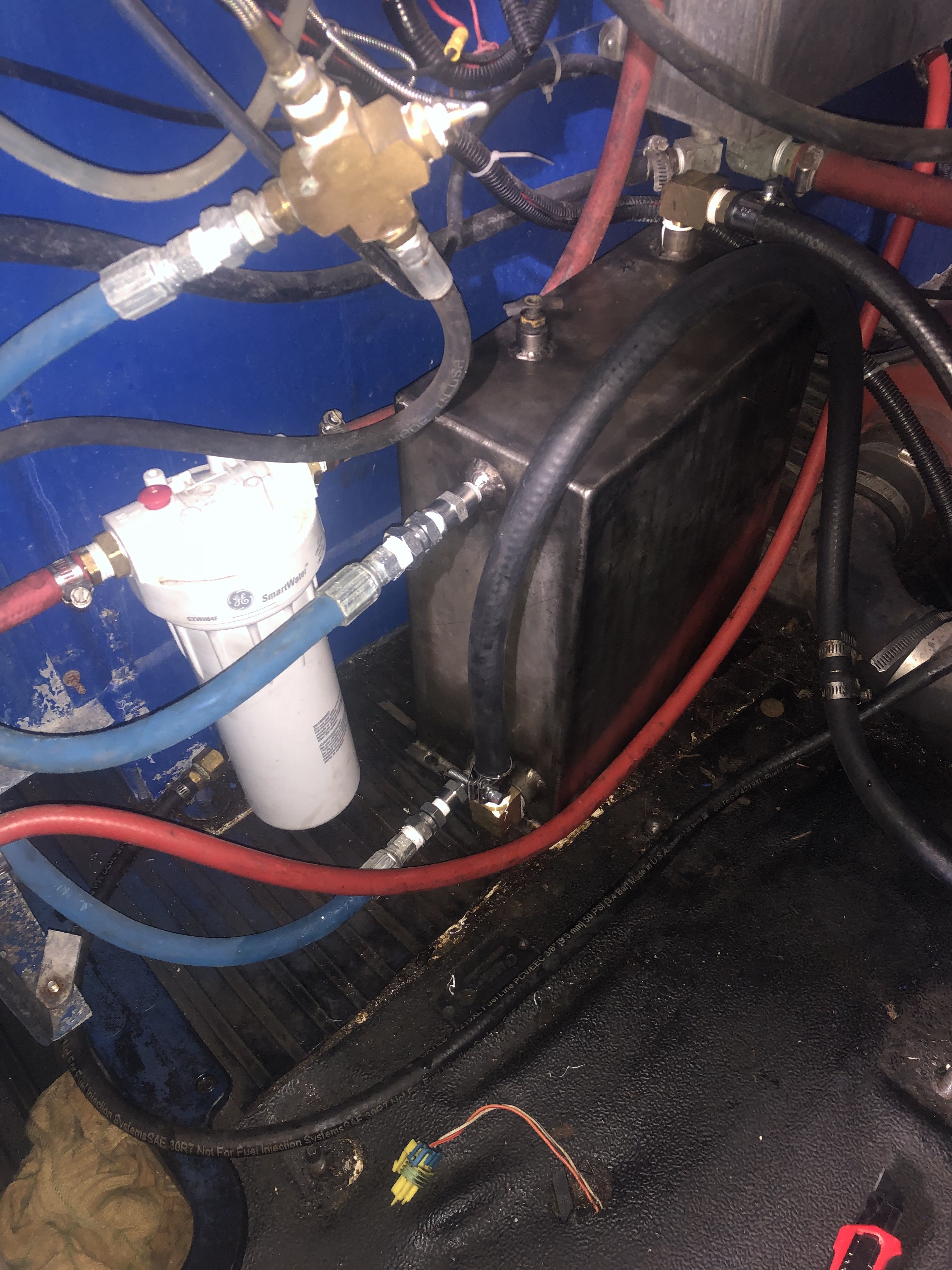

I emptied the waterbox and system of water before putting the antifreeze in. I didn't blow the lines out though which I guess is where I went wrong. I put in two gallons and ran it for awhile and still had at least a quarter of my waterbox filled with antifreeze. It must have gotten rock solid like the photos above.
Going back and looking at some of those jugs, there seems to be a big difference in quality.

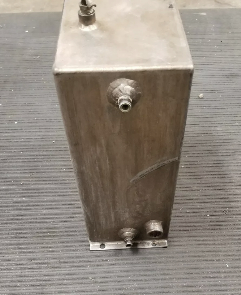

Good news is that I found a used White Magic Pro 1200 heat exchanger for only $200. The heat exchanger in my CDS is similar to this one but shorter and fatter. I don’t have the regular tubes.
