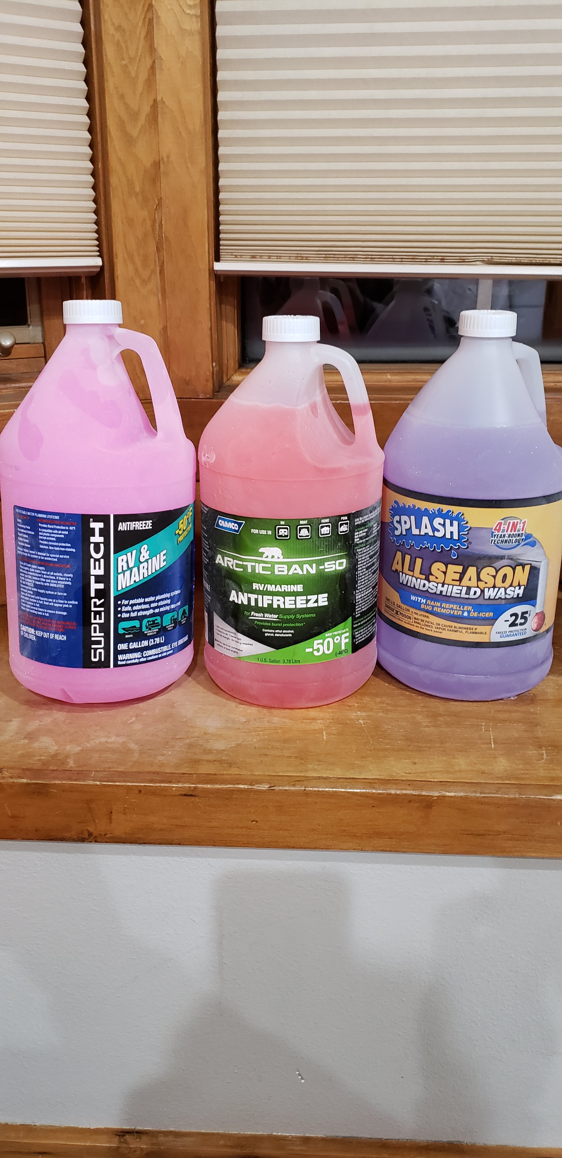

I was curious as to which one was better for winterizing. I went to RV Antifreeze after handling regular antifreeze was to much of a pain to dispose of. What I discovered really surprised me. It's -10°F here and I set these jugs out overnight. The Super Tech I bought at Walmart for around $2.50, the Arctic Ban I bought for around $5 at my hardware store, and I think the Splash Winshield came from Lowes for around $2.50. After one night in the cold the at -10°F the Supertech that is supposed to be good till -50 is froze solid and bulged out the jug. The Arctic Ban is not quite solid but more slushy, and the Splash Winshield wash is still not froze and in liquid form. I think I'll be using windshield washer fluid from now on.

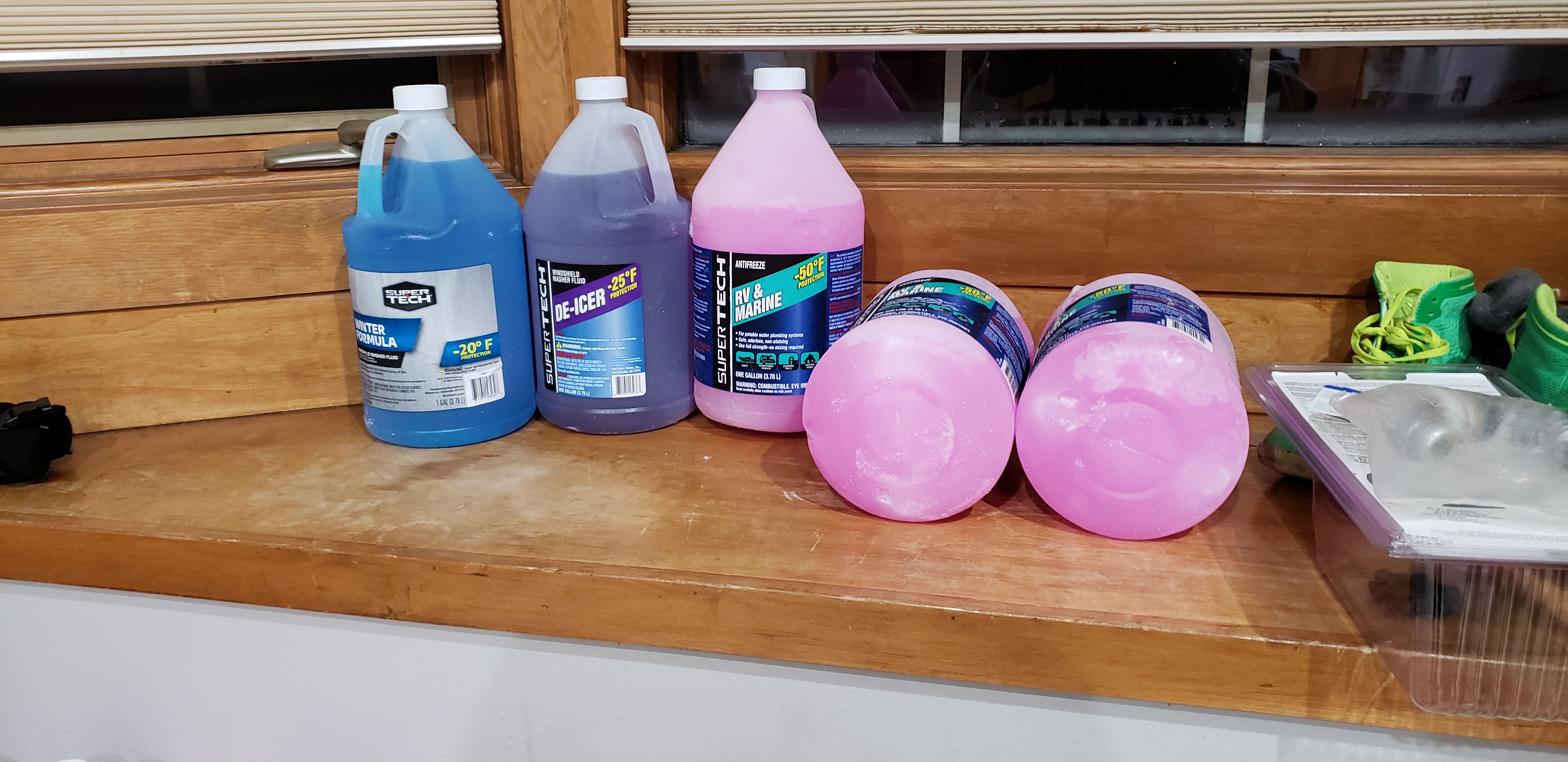

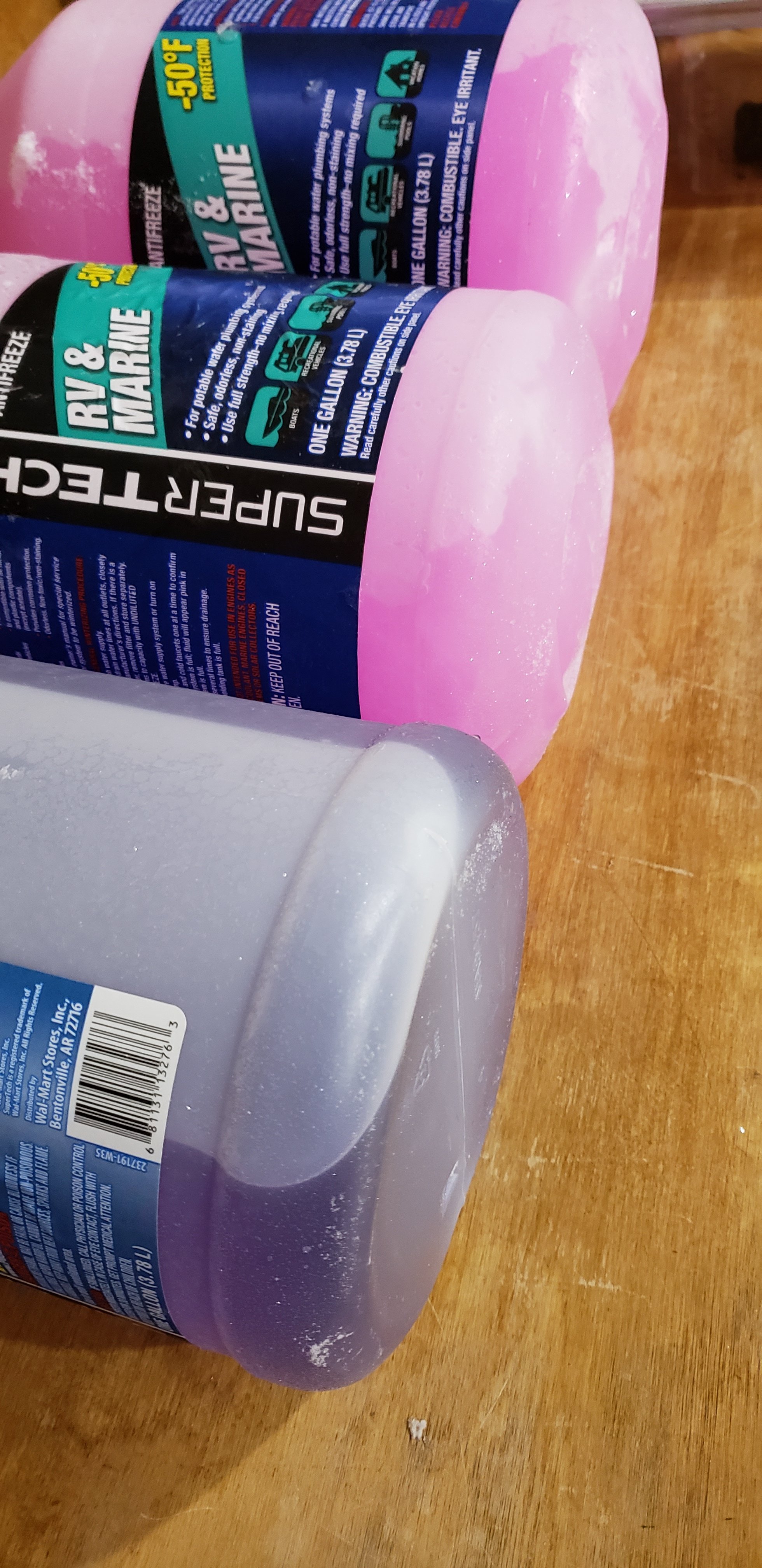

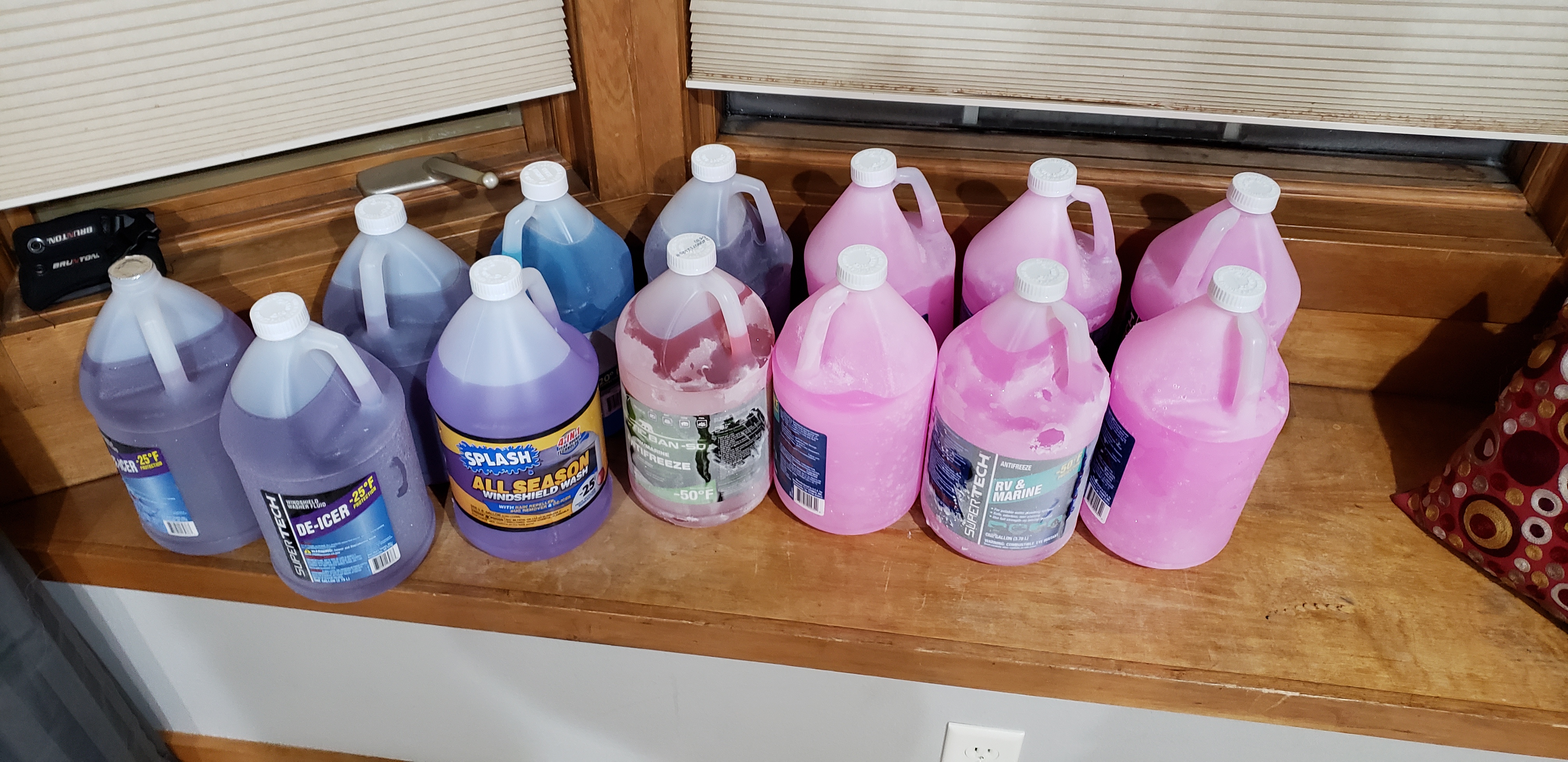

Out of all the windshield washer fluid I bought non of it has froze yet, all of the RV has. You can see in the picture of the pink RV antifreeze next to the washer fluid on there sides, the RV is bulging out. I think that could be enough to pop your heat exchanger.

I understand that RV antifreeze will slush up, but the pink Super Tech ones are froze solid like a block of ice. You can see in the picture how it expanded all the way to the top of the jug and bulged out the bottoms. It would definitely burst the small copper pipe in a heat exchanger. The Arctic Ban is a little more slushy and I would use this again if I had to, it's actually what's in my machine right now, but I also have heaters going in there.
