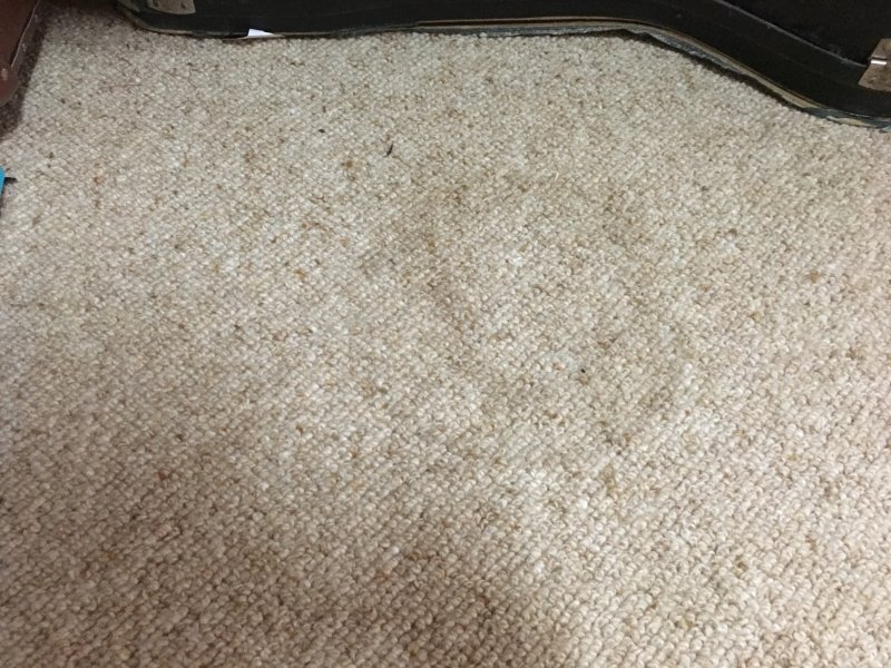

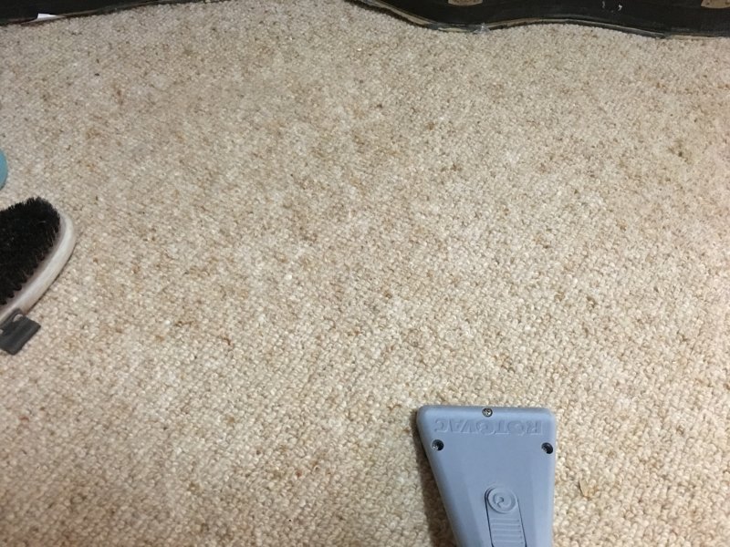

This morning's first job was a 100% wool looped berber carpet with unknown mark.
ShearDry to the rescue.
You will love it.
