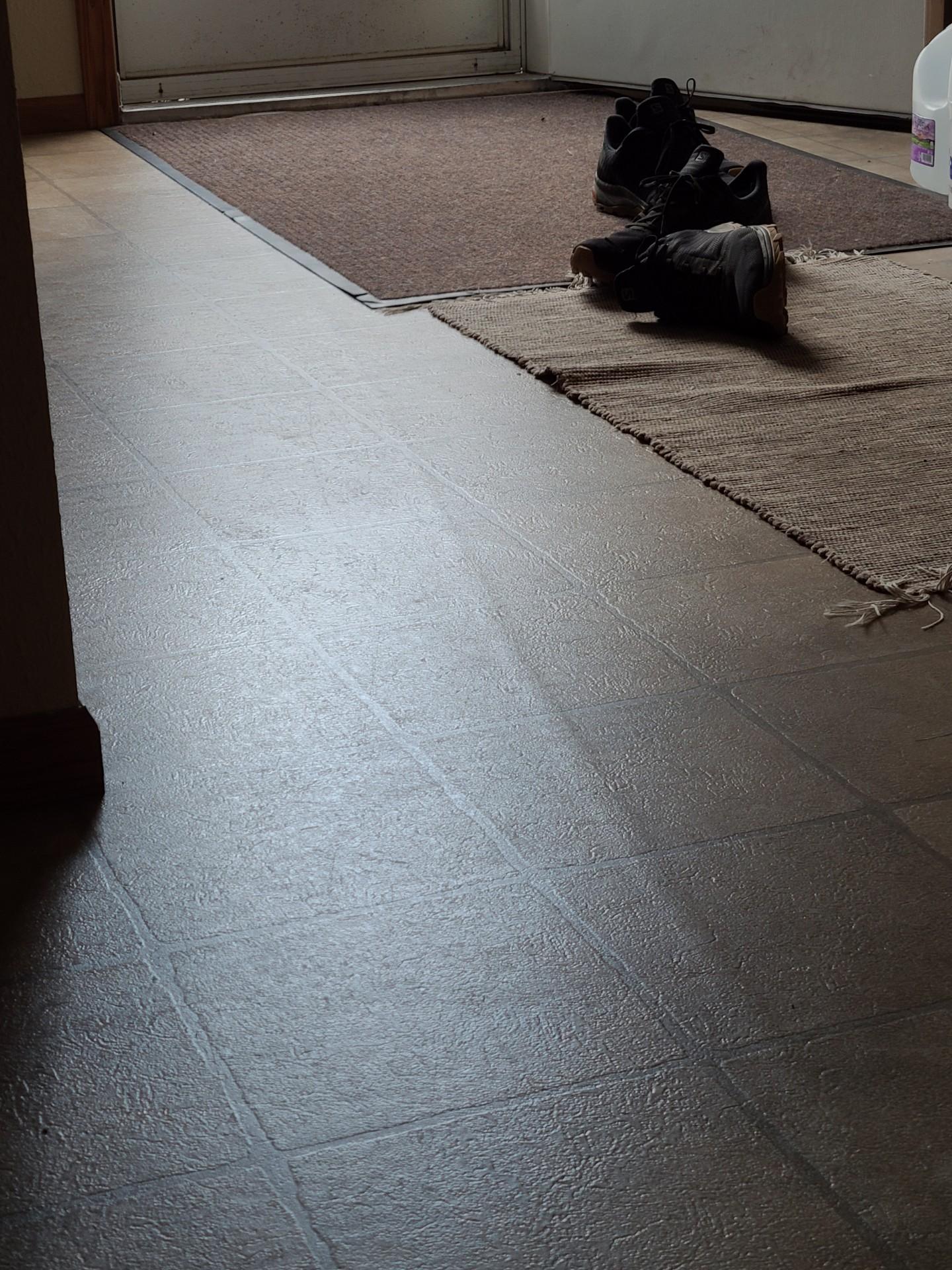

Pressure hose heat lifts vinyl floor...
117,358
Careful fellas..
Use your runners!
No, it didn't go back down.

The technician should know when to go all out hot or heat off. Using less of everything all the time isn't the answer to our business
I'm sure Aaron had a bad carpet job where high heat was needed. But that's the first time I've seen a hot hose do that to vinyl. Thanks for showing that to us
