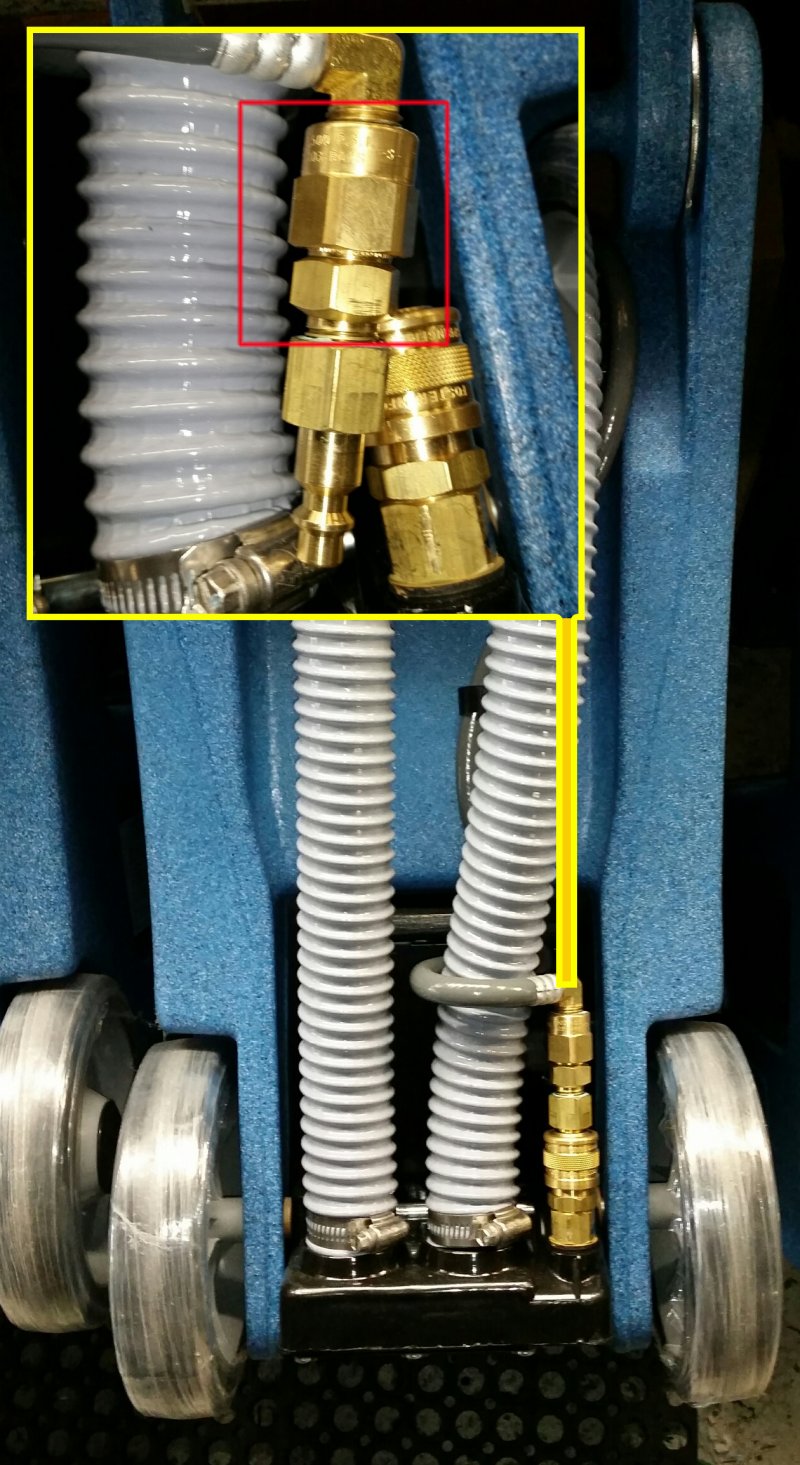

It's a ball stops the solution from running out
I can find problems

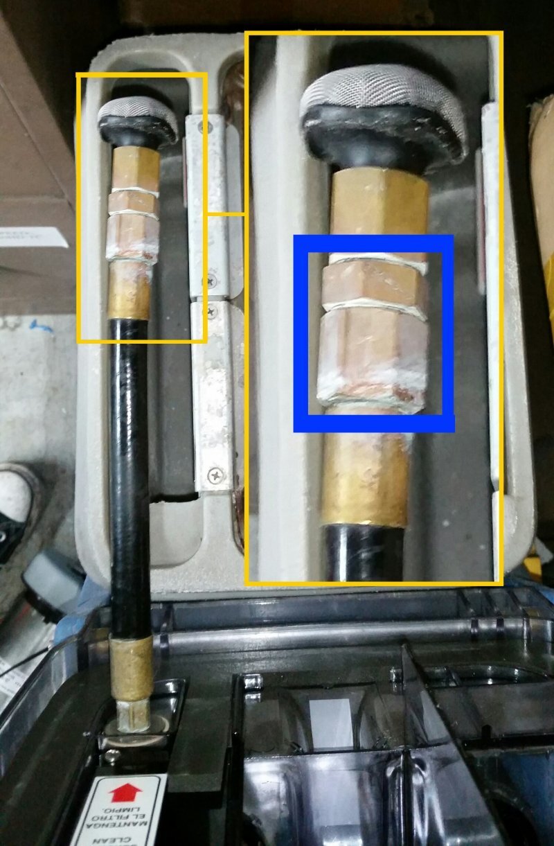

The check valve is new

This is not new on mine
I don't have the valve in the blue box, has to be here, everything else seems fine

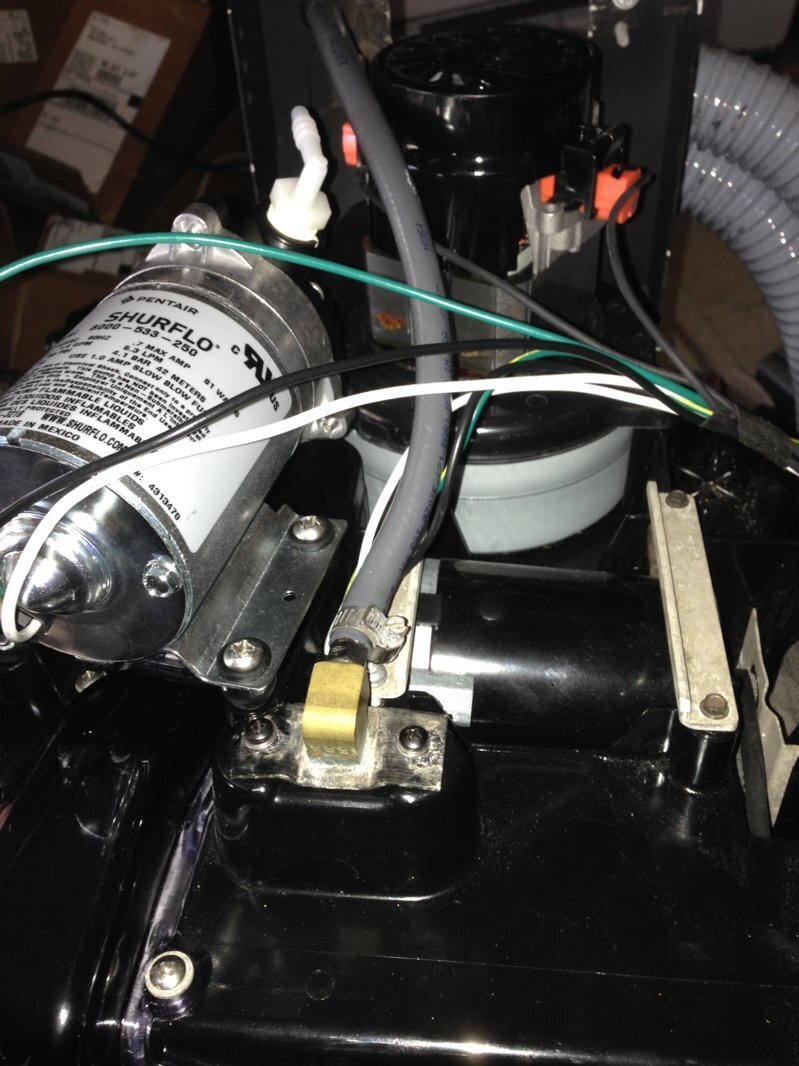

K
Ken692
It's great suction, it lifted the carpet off the floor, the dome is not showing the waste water at much volume to another unit I have it's a new pump, I'm sure it's the feed hoses, there crap 1997.

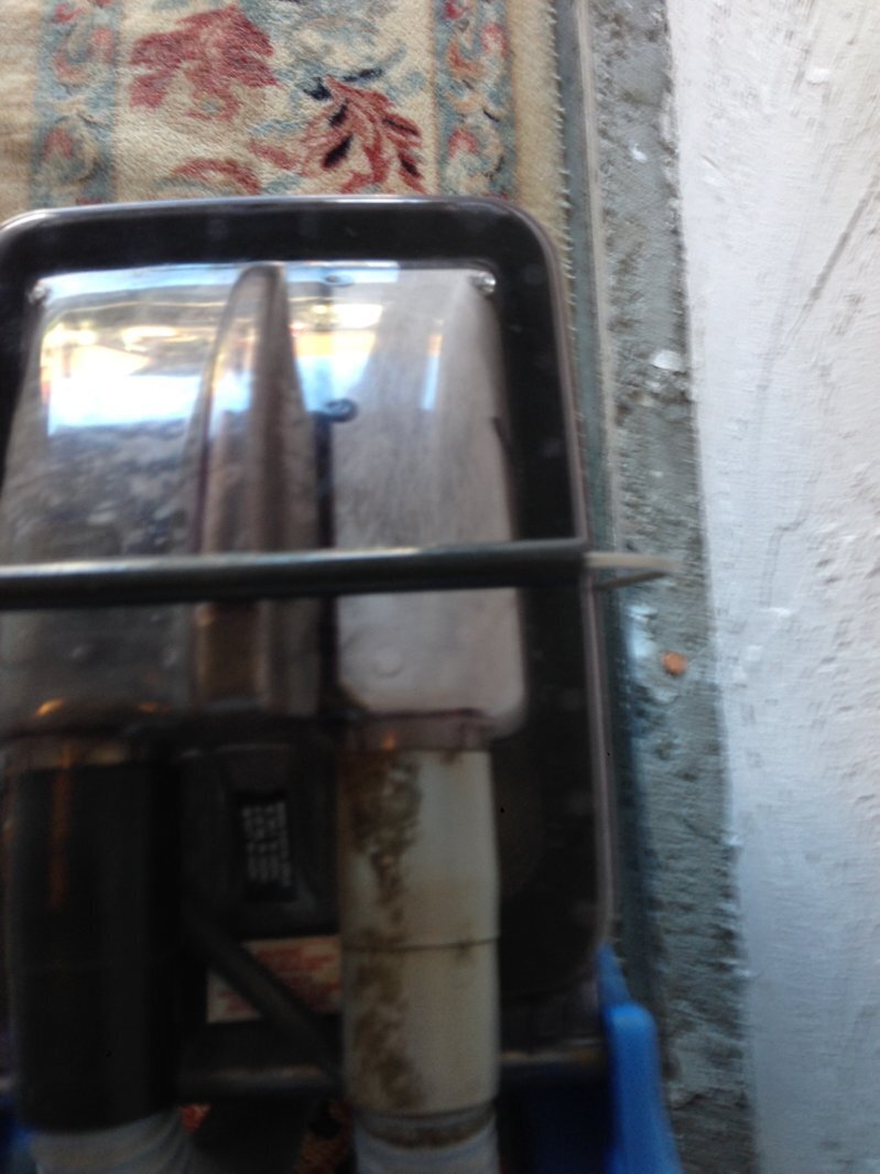

K
Ken692
Seems to be working better without doing anything ?
Maby the filter loosened it self up
