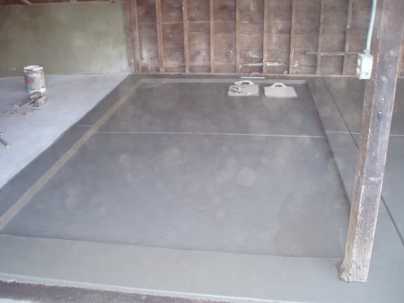

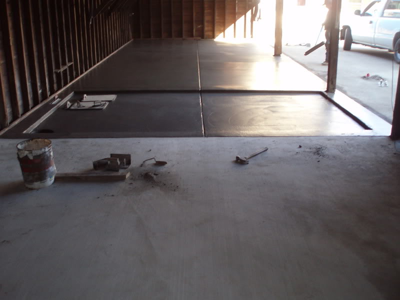

#1 is to the left and lots of flat, clean concrete for dusting, HWEing and what not to the left.

Kind of a small pit don’t you think?
You’re going to wish you didn’t put that expansion joint there in about a year
117,344
The walls will have a water proof dry wall about 4 feet up.
The 17 x 15 pit is out of the frame.
This is the small one.
Steve, you need to up the strength of your Dr Dean Edels.
There is a sump pump hole right that there.

How does the pit fill with water if there is a hole in the bottom? If you plug the hole, wont any rug you place in the pit be sitting in dirty or urine filled water? I know the general idea is to have a river effect with clean water coming in and the dirty water going down the drain hole. How much flow can you get in a pit like that, and what do you use to pump water into the pit? A waterhose?

The waste water is pumped out, and sent where?
And how do you hang them?

Into the sewer system Gary where else?. I'll show some pics of our drying room later.

Like Randy, I am surprised that a Tree Hugger would put an expansion joint in a wash pit.

If your talking about the green drywall, it is water resistant, NOT waterproof.
I would do as Randy suggested. Use cement board, thinset and tape the joints.
That is water proof!
