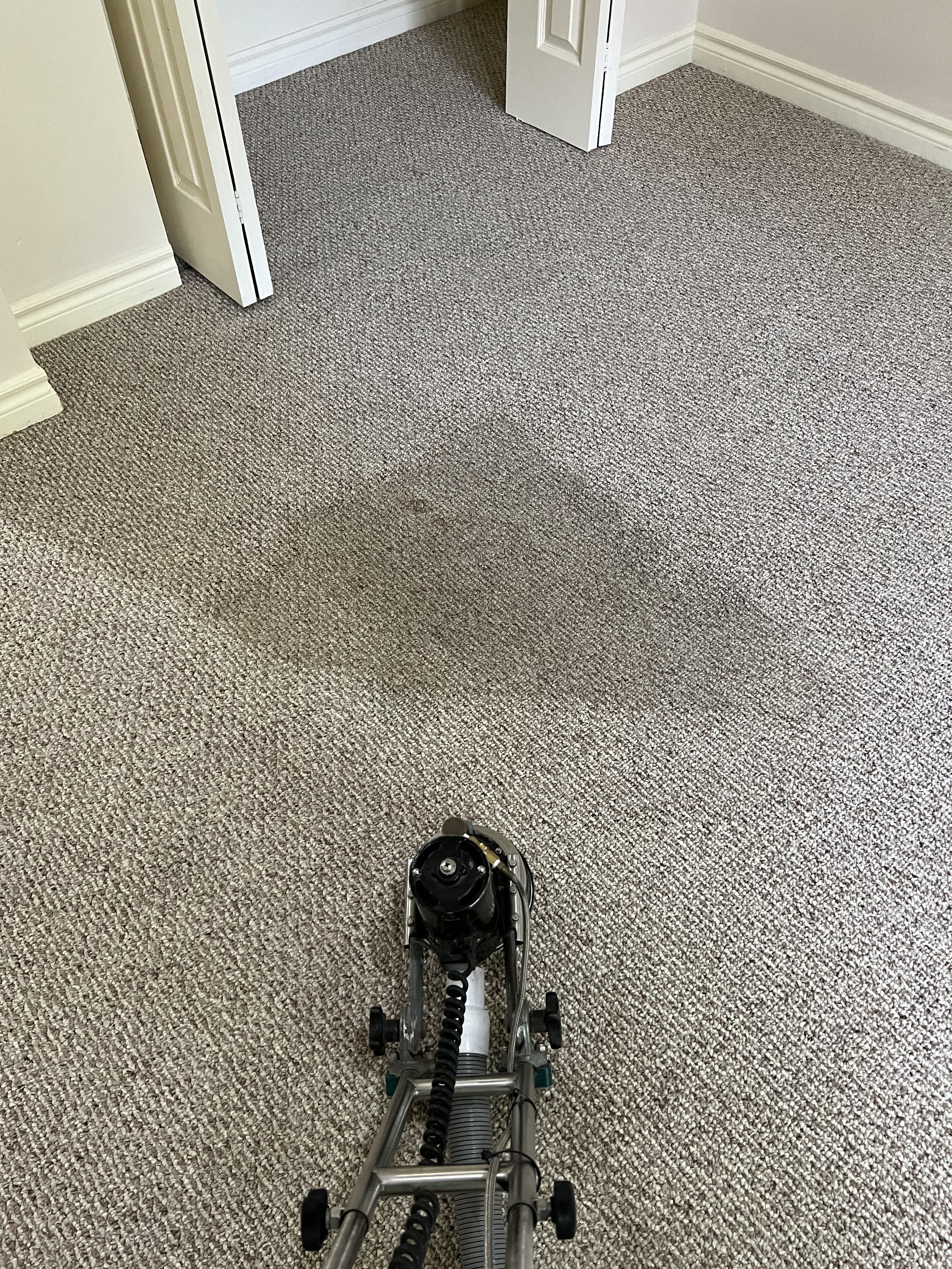

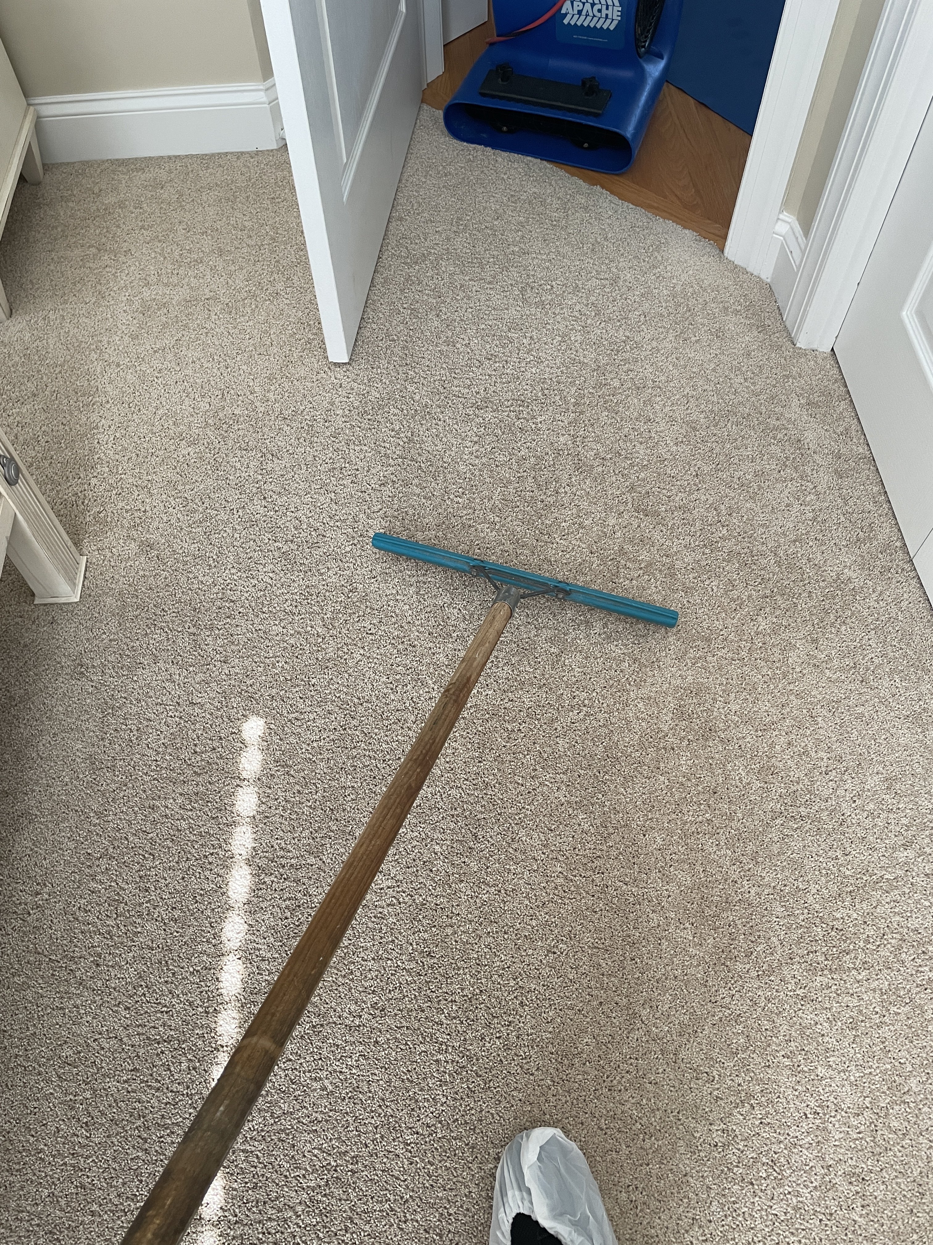

Were you using a peroxide encap or a separate type of peroxide? How did you apply it and how long for the dwell time?I easily avoided all of these issues yesterday morning on an older, white, dog urine saturated, residential carpet by using plenty of peroxide and a microfiber under the Phoenix.
I knew from experience that there was a strong chance of this stuff reappearing if I tried to HWE it. Because it was bone dry in 30 minutes, I reduced that to zero chance.

Awesome Encap and GoOxy. 3 OPG each. Laid it on slow and heavy with the Phoenix onboard sprayer.Were you using a peroxide encap or a separate type of peroxide? How did you apply it and how long for the dwell time?
How far down into the pile does the wand saturate loop end, Berber style? How far down does the suction extract?hope you like really warm weather...
James 4:17Awesome Encap and GoOxy. 3 OPG each. Laid it on slow and heavy with the Phoenix onboard sprayer.
Nobody around here is paying what it would cost for me to stand around for two hours water clawing and sodium percarbonating every spot the dog pees on.

Was just over there a few hours ago, the clients are people I have known for years. Still smells like baby powder Awesome Encap. They're definitely happy with the result and the carpet was bone dry before I left. I run air movers in each room at every job, I have had dry carpet in less than 10 minutes using VLM.You mention oxidizing urine. Keep in mind when the oxidizer turns back into water (about an hour after you left), the smell will come back with a vengeance if the pee is still there

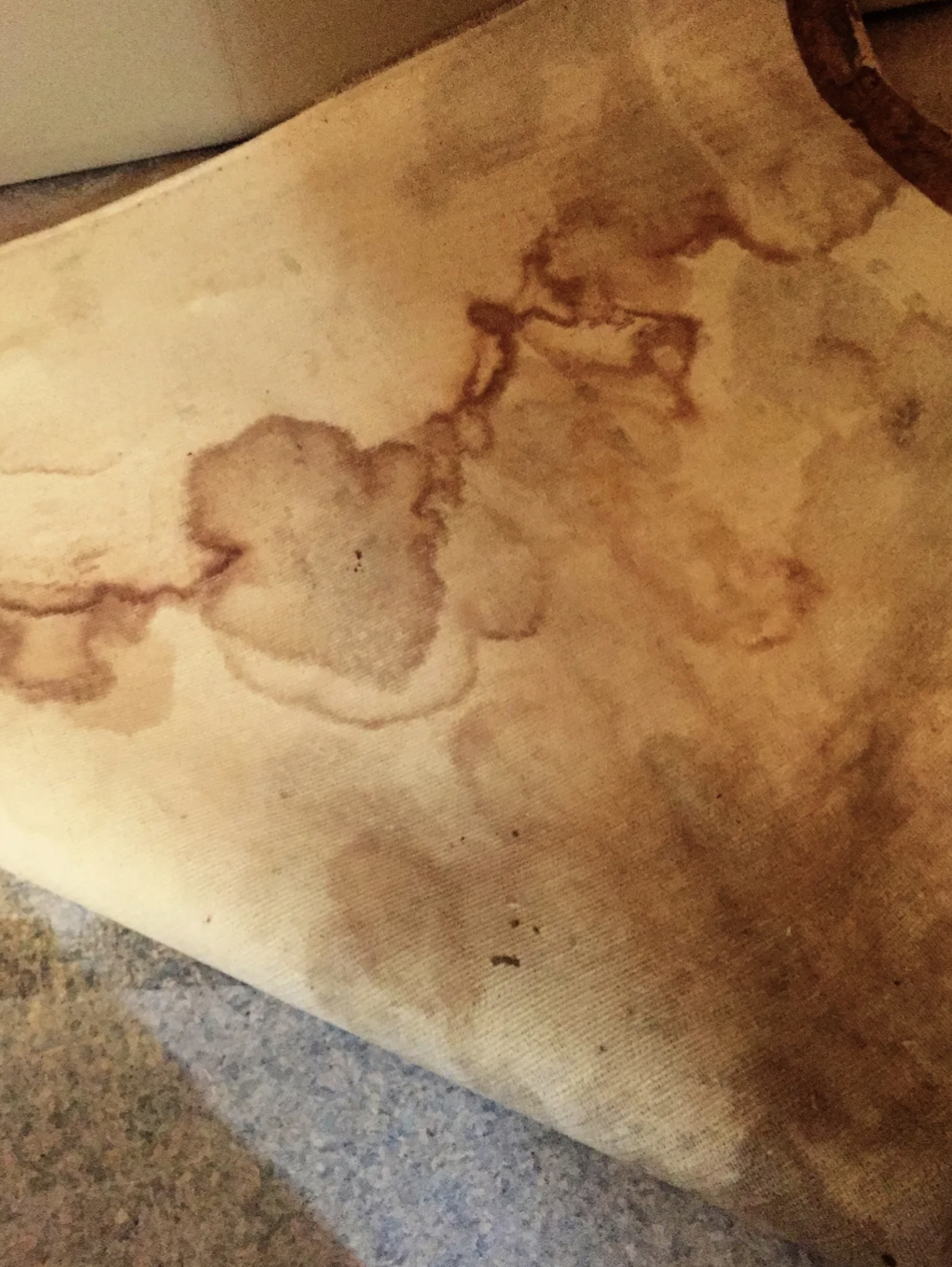

They can’t handle the truth.@anon James 4:17.... I know that not activating urine in the backing or padding is the right thing to do... for clients who don't want a full-on carpet restoration (which I can provide) but do want a basic cleaning at a price they can afford.
I have no problem doing 5 wet passes with 8 dry passes or more IF needed.I’ve seen guys who’ve been wanding over a decade doing triangle wet passes![]()
Without doing the full rug wash pit thing, I think it’s best just to leave what lies beneath alone.They can’t handle the truth.
Most customers just want carpet that looks good and no longer smells like piss.
They almost never want to pay for the full subsurface process.
Keeping the pad dry is key for those customers.

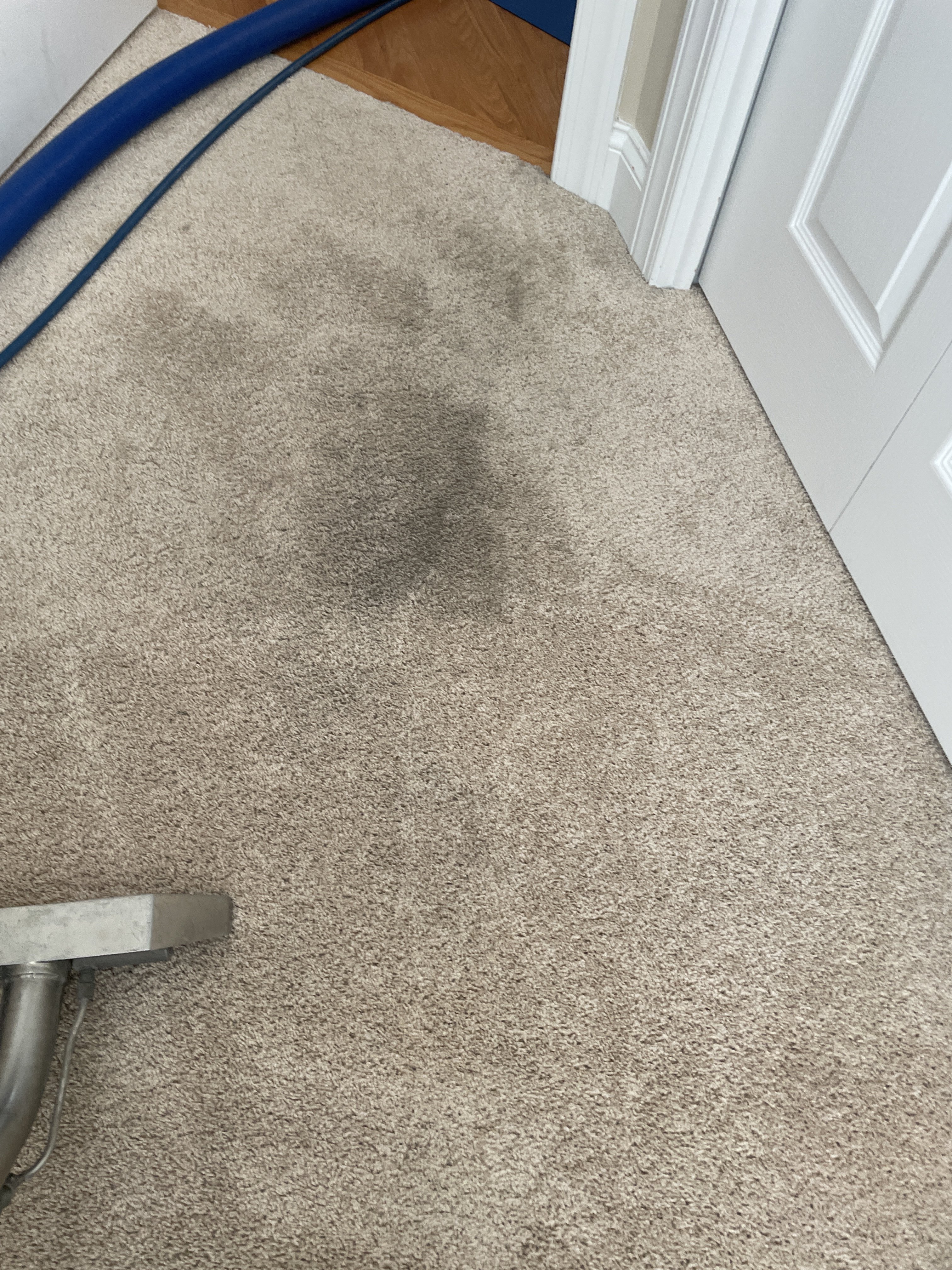

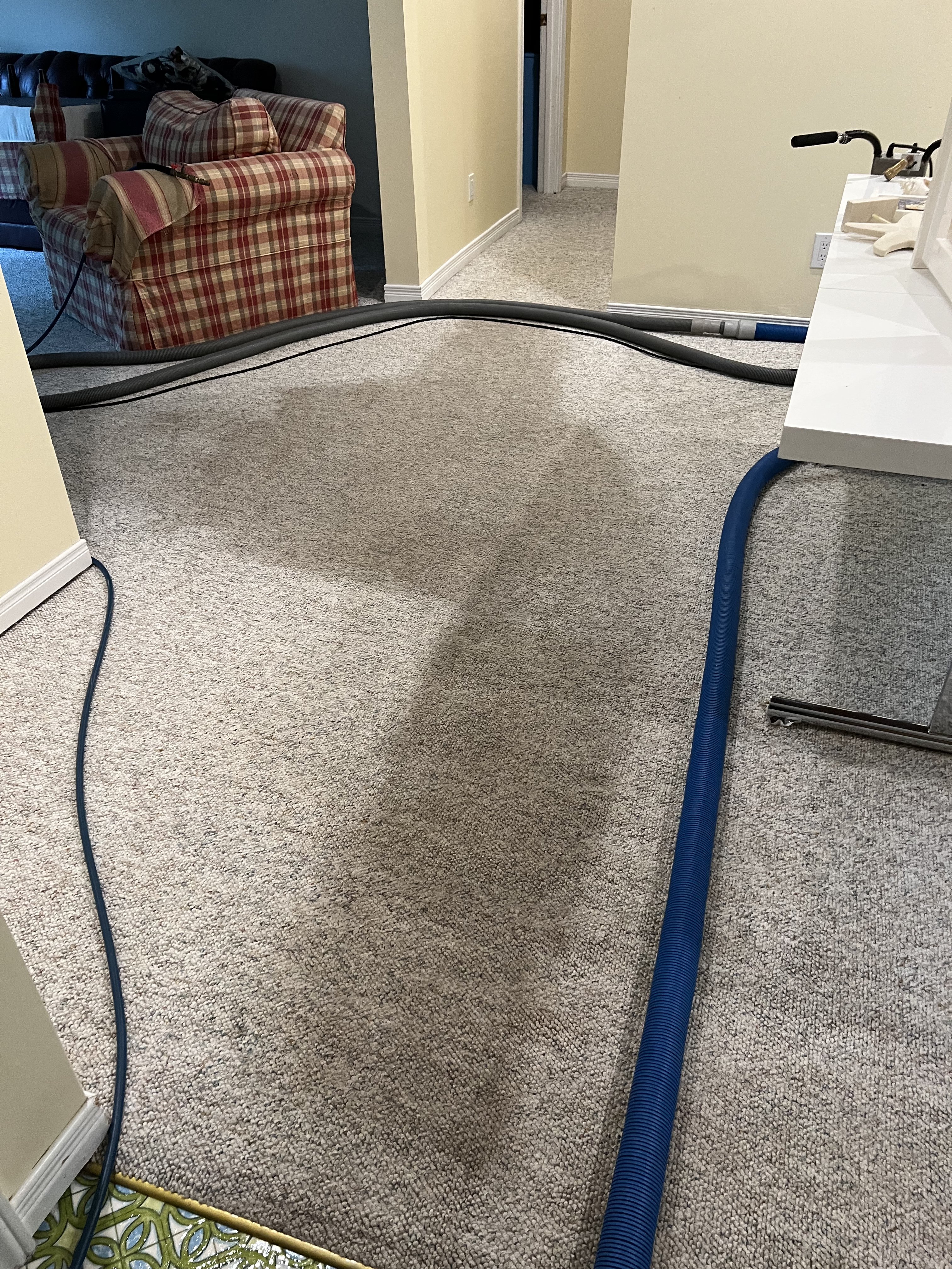

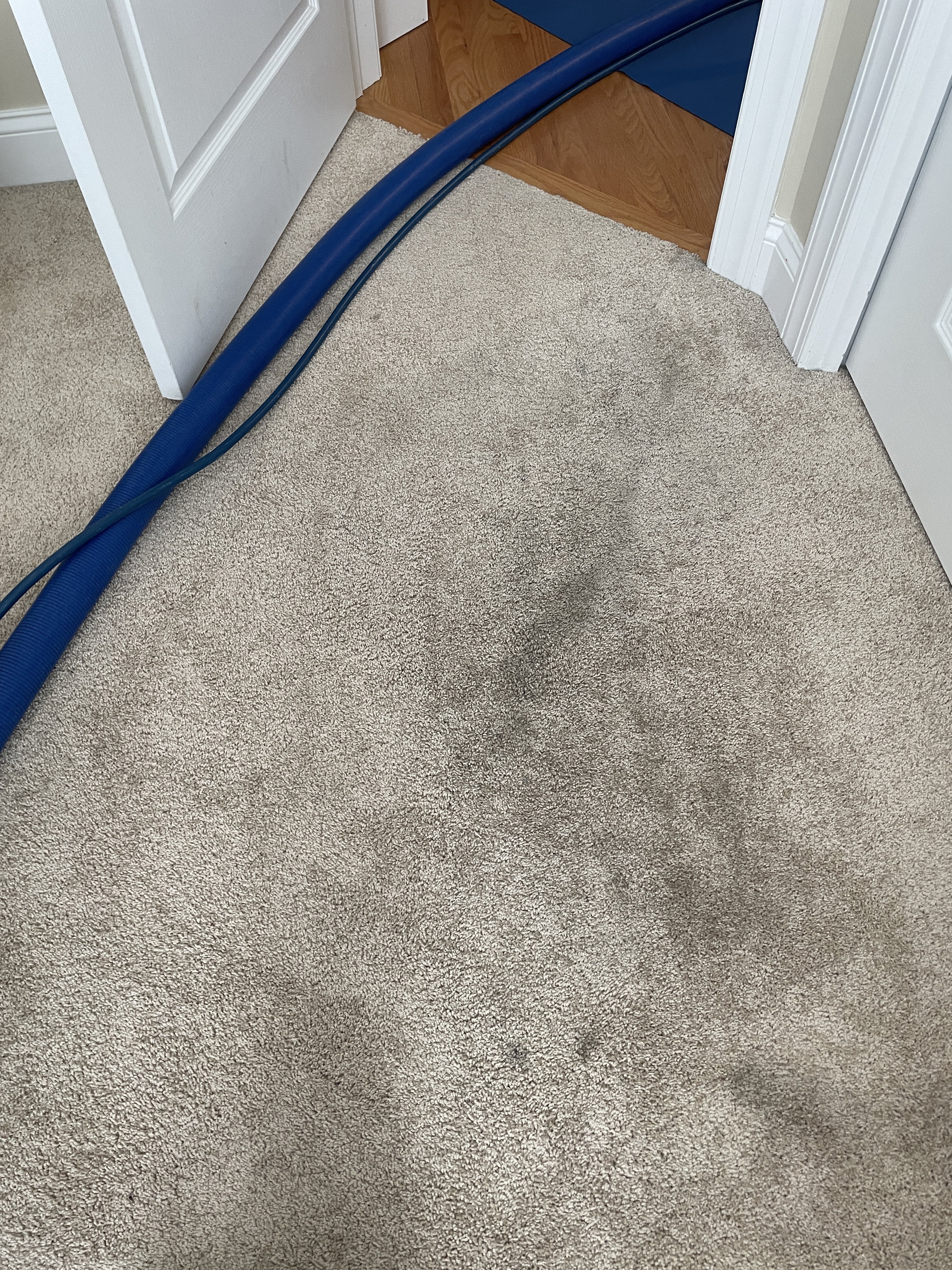

RotoVacJr all the wayWent over this more times than I can count wet, and even more dry passes. Very stubborn, maybe somebody fumbled a big bong? Air mover key, even for 10 minutes.
No wicking, tip in payment.
