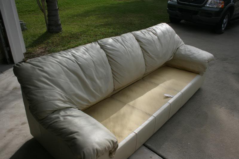

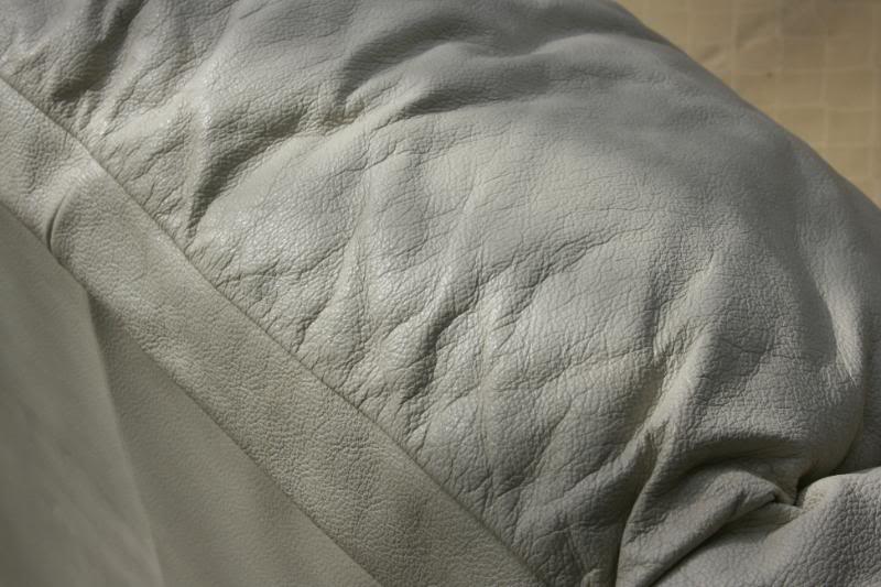

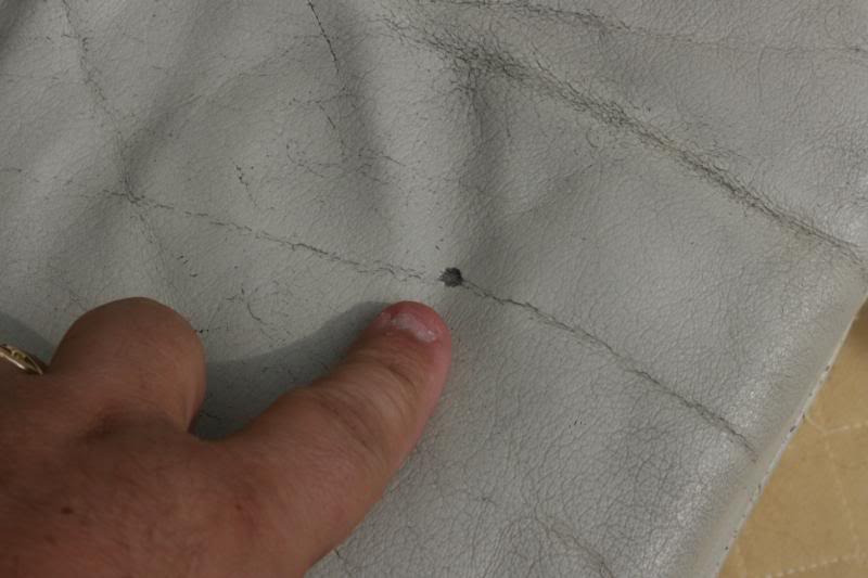

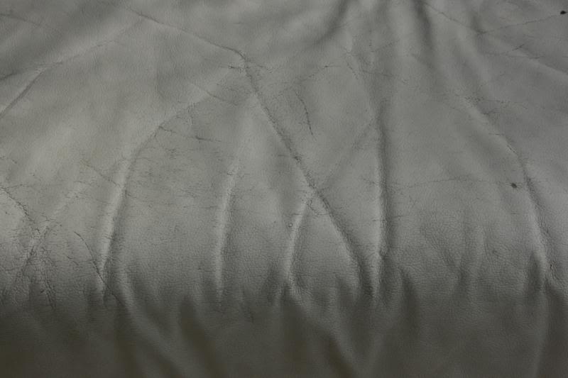

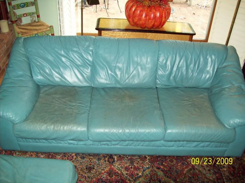

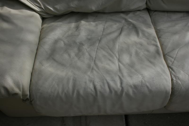

after a bunch of pics and questions i finally have a piece that i can do..
this is a sofa that a customer gave me because she was going to toss it..
so this is a piece that is in my garage and ready to be played with, i cant wait to
get this done so i can start pushing this service to my customers..i just needed to do one
before i really pushed it..
here are the pics
if you can tell me what i need and how much of it i need a little direction and i will get started..
thanks
by the way...we want to paint it light brown

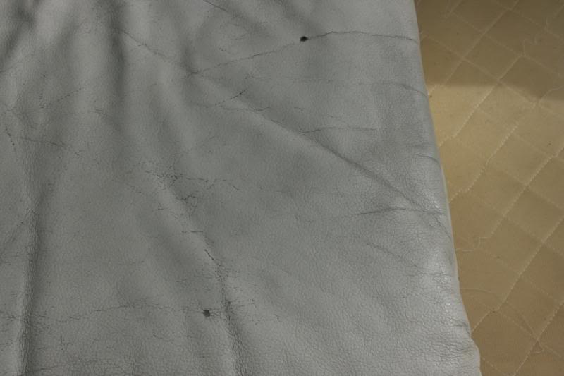

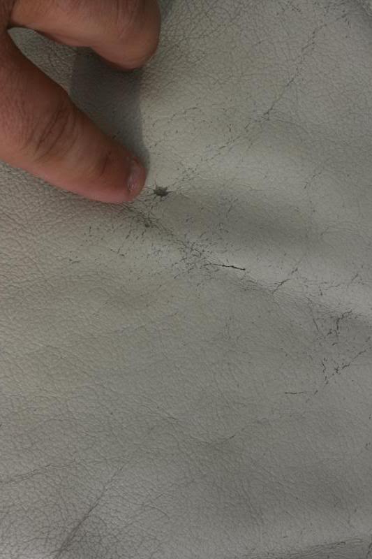

Damn Gill those are disgusting. What the hell are you so stressed about that you would chew on yourself that much?
I can tell you this, you'll have to sand down that cracked leather, bondo it and air brush the color back.
I taught Tony how to do this so I'll let him pay it back to you.

Dave will need to first of all clean with some scotchbrite pads and rinse the whole piece.
Then apply some Hydrator and cover with saran-wrap overnight for several days.
Then repeat the same process with fatliquor.
This will close up a lot of the cracks that were caused by the leather having dried out.
Once that process has been completed the remaining cracks and nicks can be be filled with leather filler and sanded,
Then you can start to airbrush or pad on the color coat.
I would not advise a color change because on the outside back and sides you will be coloring over the old top coat and so it may not bond well enough.

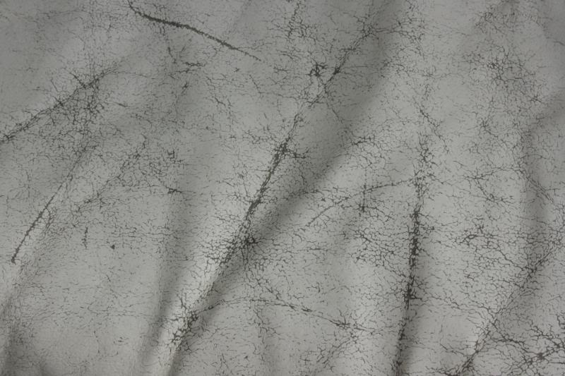

So you wish to transform your sofa like this 15 year old piece into a 15 hour old piece as shown in these pictures.
#1: Before
#2: After

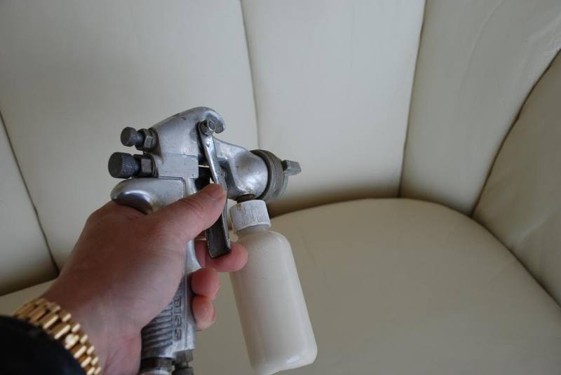

Before I talk about the refinishing system, let’s see what spraying system you have?

the only thing i have to spray with is the compressor but i will go get/rent/buy what is needed to do the job.
if needed i have access to a large compressor as the one i have is a 5 gallon 1hp
dave
R
Roger Koh
See if you can get a gun like this:
It’s a Devilbiss with three controls for 1] pattern, 2] flow and 3] air.
Then match up to a compressor that you need – needless to say the bigger the tank the better.
Practice it and you will be ready how to manipulate the three controls to give the best performance.
