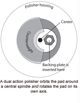

The crankshaft does rotate just like a 175, but that offset flywheel turns all of that rotational torque into oscillations.
10,179
Is it like getting a pad off center on a 175 and changes the rotation of the pad slightly? They will what we call orbit?
It’s no different than an orbital polisher,
exactly

Yes, but everything I’ve told you still applies. Rotations are a side effect of the oscillations. Strip polisher down all the way to where the crankshaft meets the flywheel and you’ll see it oscillating only. At least the polisher I have. Every OP machine I’ve owned, the transmission doesn’t rotate after the crankshaft. It takes the second bearing on the driver or close to the driver on other machines to transfer some of that directional oscillating into rotations.
Lock up or remove that secondary bearing and you get zero rotations, and 100% oscillations.
You are arguing that the machine directly drives rotations from the motor, which is not the case.
