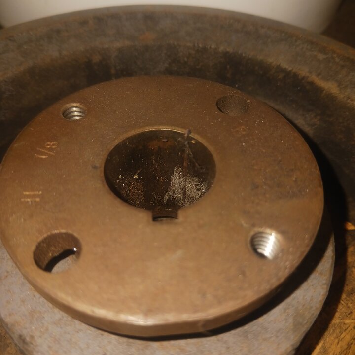

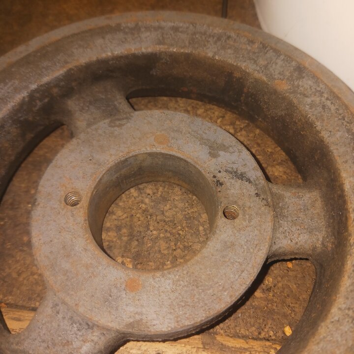

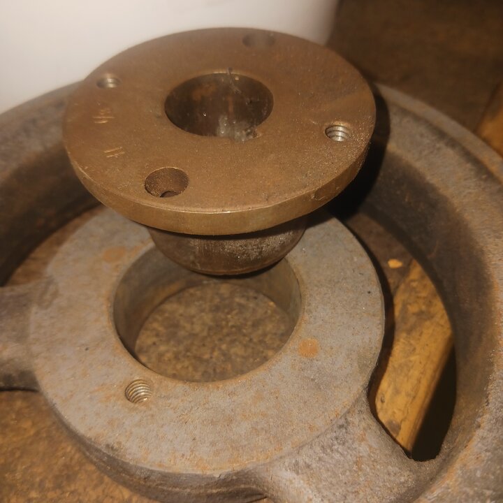

I take it you got the old broken bolt out ok? I need better pics of the pulley and brand name?? All my machines have browning pulleys with them the 2 bolts that tighten are used to to remove ( open holes to tighten threded to remove )
View attachment 131697 View attachment 131698 View attachment 131699
I did get the sheared bolt out! I propped the blower up with a small bottle jack and the bolt came out pretty easily. Nice pulley, mine is stupid, there are 3 holes total, and only 1 hole to thread a grub screw in to pop the pulley off. If there were 2 removal holes on opposing sides I imagine going back and forth a few times would make it come off like a breeze.

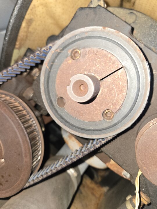

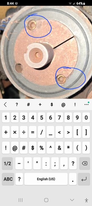

From the pictures It looks like there is 2 allen head screws holding it together??

I had a feeling a perfect fit was important. I actually drove to the hardware store and bought an appropriate long allen head socket for that pulley. My metric set was too wiggly. After I fixed the blower mounting bolt I realized I need to put the pulley and belt back on separate because the pulley and bushing need to line up perfect and be seated on the shaft perfectly. I ended up loosening the pillow blocks and did your recommended trick using longer bolts to get enough movement on the lower pulley to put the belt on.

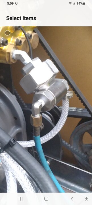

Yes it does have a chemical pump. Although I don't think there is a separate pump for it, seems more like injection. I think it feeds down to the water pump and gets mixed into the fresh water post pump. Haven't used it yet. This week I'll test it out...

Its a little pulse pump . It would be mounted on one of the valve caps on your main pressure pump it would look something like this

Oh I see. I put the doghouse back in and I'm retired for the night. I'll unearth it tomorrow and follow the solution line from the chemical meter to the main pump and see how it interfaces and let you know. All I know is that my setup has a post pump chemical system to protect the main pumps seals. And it definitely doesnt go into a valve cap...

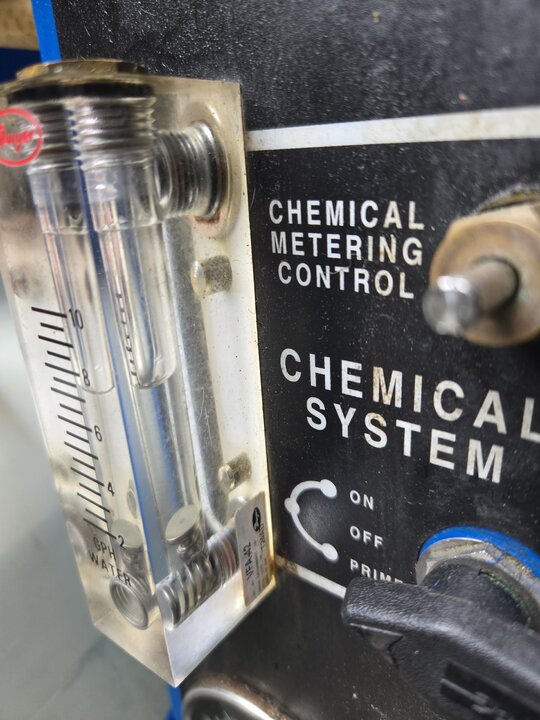

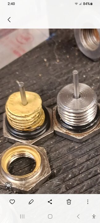

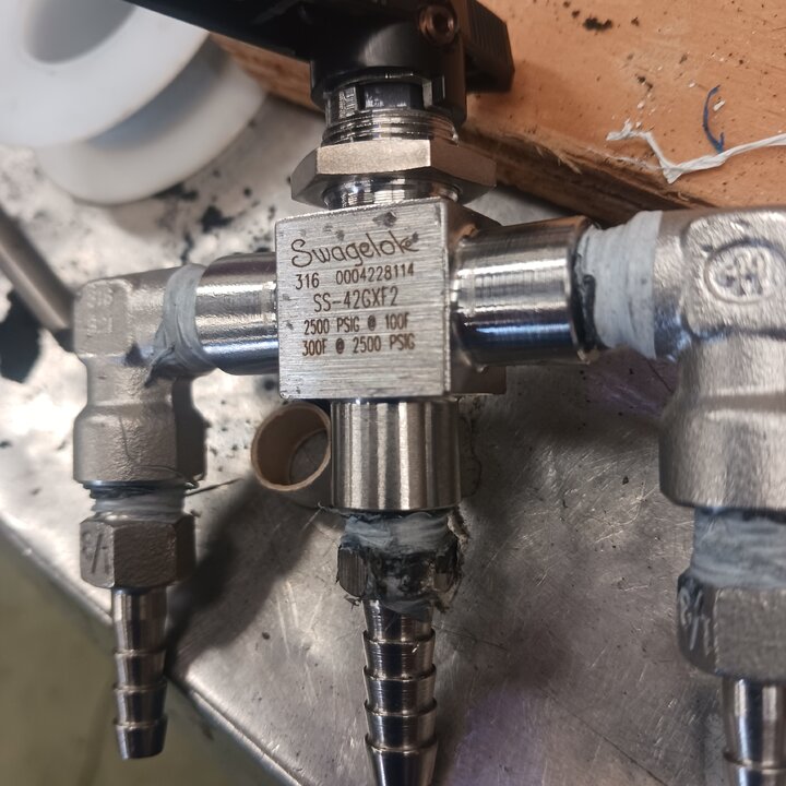

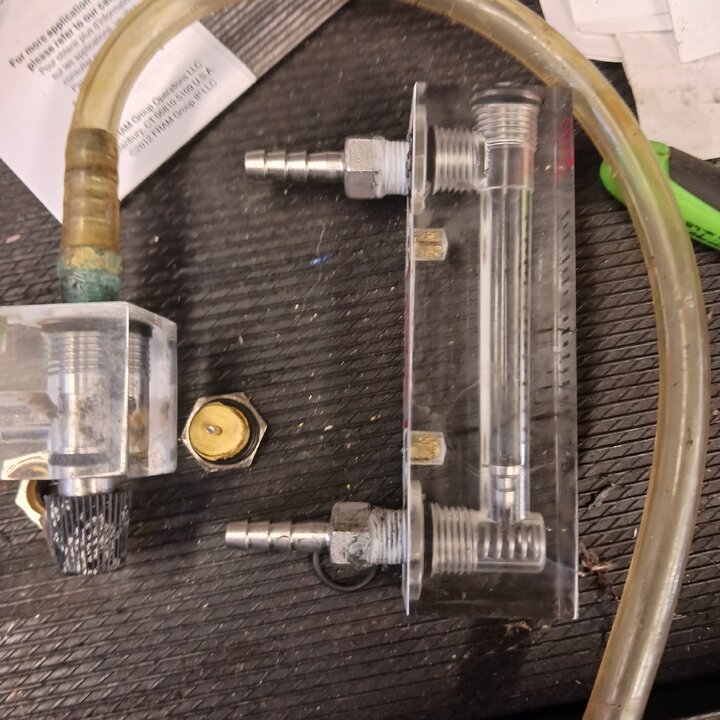

If you have a chemical pump your chemical meter probably has brass fittings and depending on the chemicals you use they tend to deteriorate quite rapidly. The dwyer meters used on machines that use starvation to supply chemicals are all stainless. The way I found this out was all my business life ive had machines that used starvation to feed chemicals. (They have a flow adjustment knob at the bottom of the meter) when i retro fitted frankinstien with a chemical pump i bought the proper dwyer meter and it lasted only 900 hours before giving me problems. The way that i solved it was to take fittings from a pile of old meters that were all stainless and swap out the parts. I have a bunch of um if you'd like to do the same to your meter. I don't have any extra â…›pipe to hose fittings to connect it up but their easy to find on ebay Amazon etc.etc.

I'd love that Dwain, very kind offer thanks bud! Yea I think I have the same setup you took in the pic. I'll confirm tomorrow. Thanks for heads up about the weak point in the system too, and a lasting solution!
Stainless is the way to go eh. I wonder about quick connects though, it seems like they go for other reasons so would it be wasteful to spend the money on them or do they really last? Exciting times. I need to get a pile of hoses and a box of fittings. I am impressed with the selection at my local hardware store, they have a wall of brass fittings that will fit a decent amount of my needs.

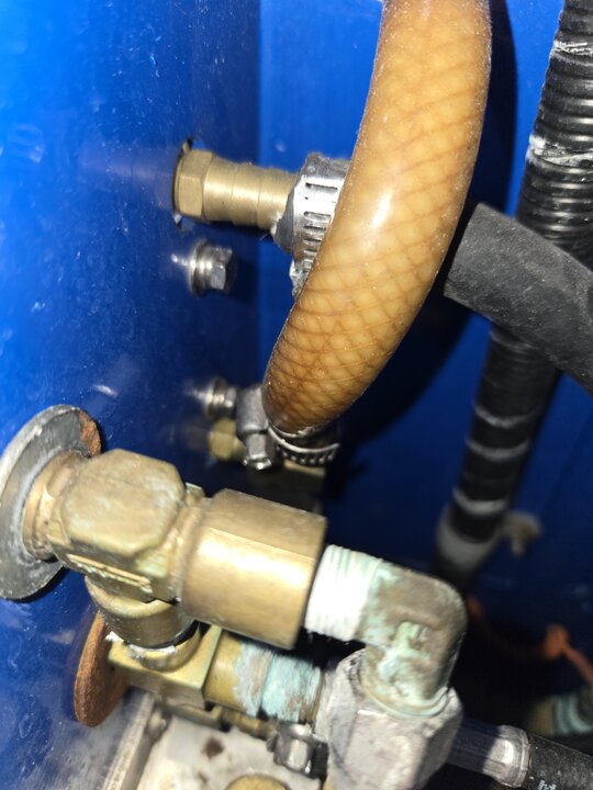

I think we have the same chemical meter Dwain.
Yes, youll find the top piece and the 2 back pieces are brass dm me your address and ill send you the stainless versions. If you unscrew the top piece it'll give you an idea of the overall condition of the other brass fittings. It appears that the valves for your meters are also brass. I wouldn't change um till necessary then change them out for swagelok brand stainless valves theyll last forever stay away from Chinese made valves here!

Except mine has a bunch of brass :(View attachment 131739

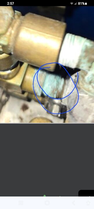

It also looks like you've already got a leak somewhere around here it doesn't take much to screw up the chemical pump system. There's also a packing seal adjustment on these 2 valves. If you use a small allen wrench to remove the handles, you can use an ignition wrench or mini crescent wrench to tighen the packing nut

Wow the difference between that threaded brass and stainless piece is incredible. The brass looks warped, worn, and pathetic. Thanks for pointing out the evidence of a leak. I'll check that packing seal adjustment when I have some downtime soon.
