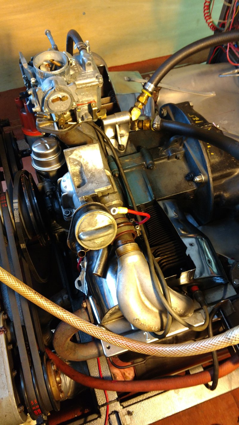

Well I got the old one out, new one in, forgot to take pics, I ran into a little hiccup I want to beef up the rear engine mount so I couldn't go get bolts today. The other way worked but I couldn't service oil pump with out removing the whole mount, so just a quick redesign. The cool thing is my whole front panel comes off with two bolts and two wires + n - to power all my gauges so I should be able to get it back together on a few evenings.

I also think I am going to get rid of all the header system, it is more for a performance car, if I can do this it will get rid of all the hot exhaust tubing that you see in one of the pics, it really creates a lot of heat and that is where the fresh air is coming into the fan, should cool it WAY down. Now that I have my Tig welder it should be a little easier to do

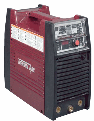

What kind of tig welder did you get? I recently got the itch to do it again so I picked up a thermal arc 161
Scott,
I actually bought a Eastwood Tig 200, It is not a huge tig welder, but I love it....I have never had one before, I did a bit of web research and watched a ton of videos amd most were really really happy with it. It can do aluminum also, It just runs on 110 so it is maxes out on 1/4 but I figured if I neded more than that I would just have to have the guys at Torr do it for me.
I have never welded so easily it take a little to get used to but the welds on finer parts is so FLIPPING awesome. For guys looking at there first machine I give it two thumbs up.
Super easy to set up, small, and under a 1000.00 bucks.....I bought this so I could get the wands done just so I could go to Mikeys Fest in Nashville, along with a Smitty Mill and Lathe combo.....two weeks before MF in Nash just to get these wands ready to go I think we spent @ $5500.00 total on tools to allow me to keep my promise to show up for Mikey and his fest....
BEST thing I have done in a long time. I know these are not for the hardcore guys but they helped me get what I needed to get them done...they both do awesome and super happy with both and more than enought to get the little things done I needed to get done.
http://www.eastwood.com/tig200acdc-53012.html

If you're not using it professionally it is hard to justify the big tools. I have a sweet mig welder because I used to use it professionally but I am just playing with tig for now ( I did it professionally too, but not nearly as much)
