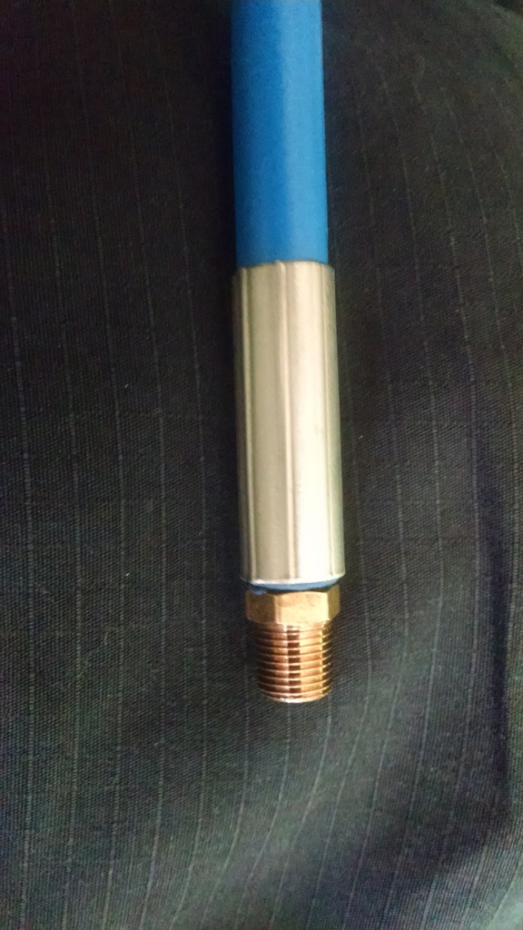

Now there is one concern I have that is a fairly new little mod I am doing, I am making my own solution line ends, they have a brass insert but the outer crimp is of stainless steel, I am trying to get rid of the internal rust that forms inside almost all of our solution lines, this is the only thing that has not had some real time put on them, but I have a hyd hose crimp machine and I believe they will hold up okay.
So Mike I am doing this not because I am on the cheap or out of disrespect, but because I want you to see and use a swivel that has some time on it.
Now Mike can choose to keep it, or after he is done with his trial donate/auction it off to the members here.
So enjoy the wand and thank you for letting us be here,
This is my new hose ends
